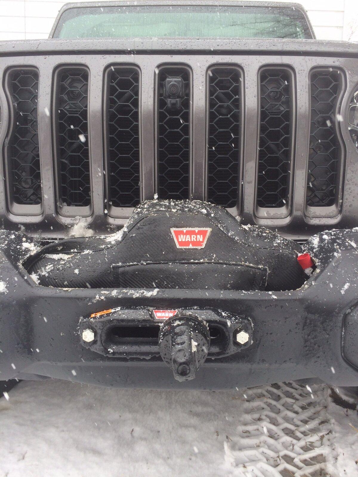

Don't buy cheap tools for emergency situations. Like most people, I used to buy a cheap set of tools for the truck but I realized that when you are stuck somewhere in less than optimal situations, that is when you need the best tools available. But....I am cheap so I had to learn that lesson a few times.
I bought a Warn EVO 12S from Northern Tool. I needed other supplies and lined up their gift card deals so my winch only cost me ~$550. If you watch them you can get good deals.
Went with the 12 because the price difference to a 10 was minimal and when you need it, you NEED it. I went synthetic because of the safety factor (farmer, yes I have broken steel cables) and there is a weight savings. I see where some people buy the steel cable winch and then buy an aftermarket synthetic line to save money, heck you might even sell your new steel line.
Being cheap, I bought the Warn winch mount and simply modified my plastic bumper. Mount was ~$225, it fits perfect and has the front plate to mount the fairlead to. I also bought a winch cover not only to keep the mud and crap out of it but to keep the UV off of the synthetic line.
