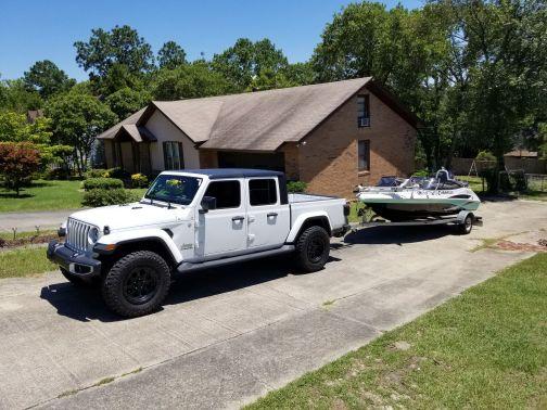

Do you have a pic of your ride with the 295’s and stock fenders?
I had to do a little digging to find these. Lol. But, here are pics with the stock fenders.
Jeep Gladiator Lift guidance. 20190621 Truck and boat - Columbia, SC (3)
Jeep Gladiator Lift guidance. 20200321 Tyson Jeep at home - Columbia, SC (1)
