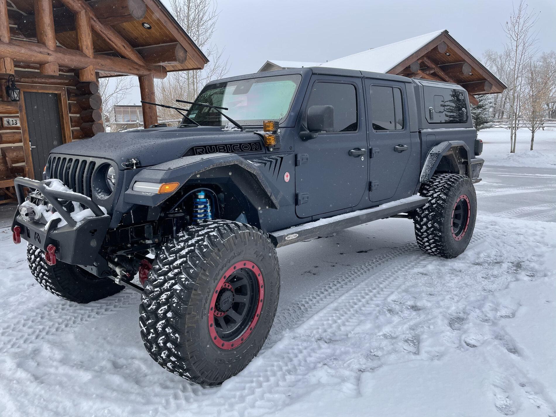

I have the Rebel Recon Stage 2 with Steer Smarts. Totally love it. Around 6" total lift. Like others said a few minor differences.

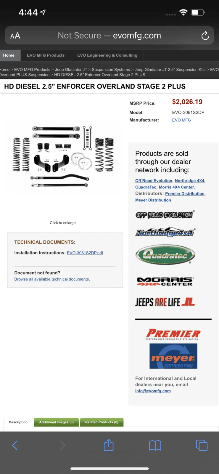

I am going to buy the Evo 2.5 lift in the coming weeks
