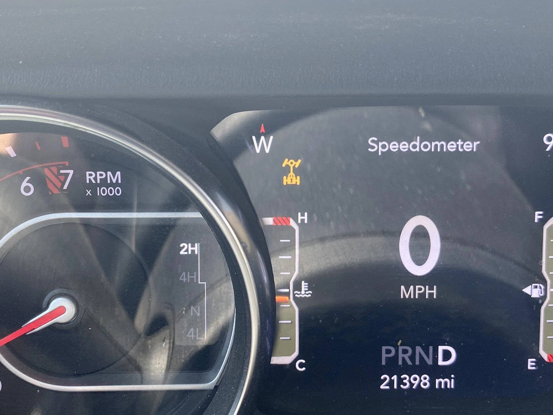

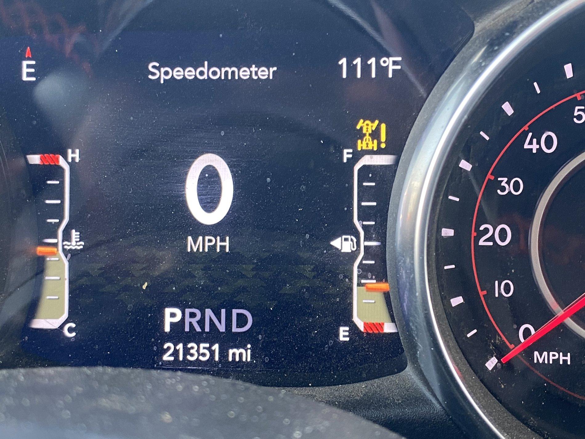

2020 JT Rubicon. While in 2 wheel drive my locker light went on flashing indicating that the rear locker is engaged. It is not engaged.

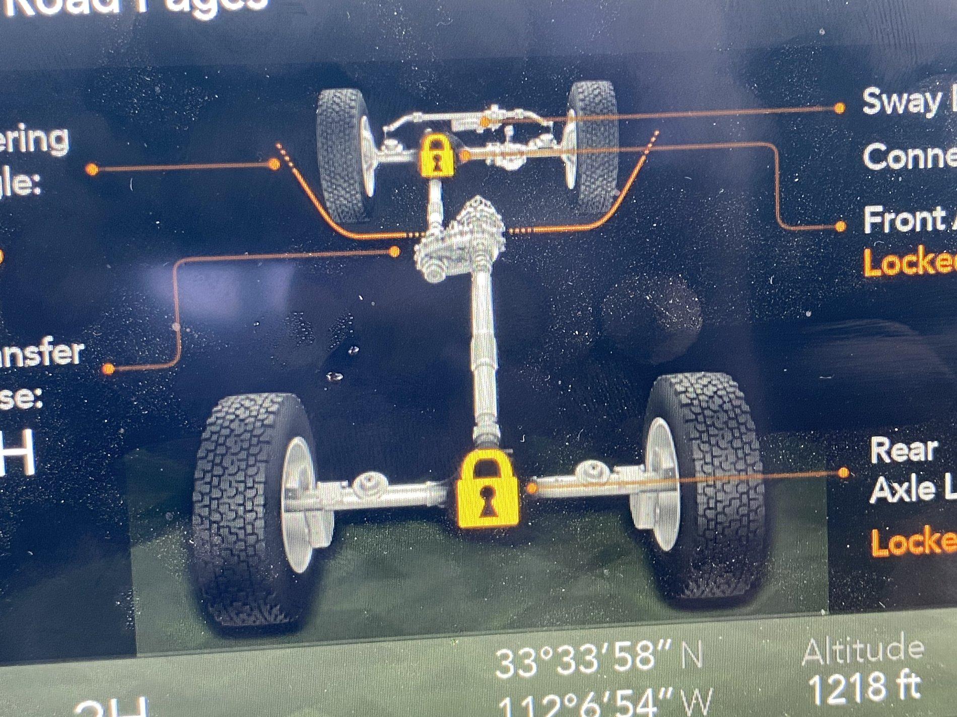

This has continued repeatedly with different warning lights coming on and with the off road pages sometimes saying that both lockers are engaged. They are not engaged.
Once my dash popped up a text to the effect that “warning: axle locker needs service” but I only saw that once.
I have put the JT in 4 wheel high and low and engaged the rear and front lockers off and on and they work fine.
Is this just a bad sensor that can easily be replaced or something more significant?

I also posted in the JL Forum and what I hear there is that there is no replacement for the rear sensor itself -- the entire rear axle must be replaced. Oh boy. I have a supercharger and I can foresee the jeep service dpt telling me that the add'l horsepower/torque is the source of the problem so it won't be covered under warranty. Can't wait.

Do a search in this forum - there's several threads, one pretty long, there's a thread outlining a sensor issue and potential prevention, and other nifty info. Apparently some do engage? Have I read that correctly?
Anyway, it's enough of an issue you'll find more than one long and informative thread about this.
Axle swap is the fix.........

My locker light was blinking at first then went solid. I tested it, the rear locker was definitely engaged in all drive formats. Dealer ended up replacing the rear axle. Seemed like over kill, but that's on Jeep dime.

I know there's multiple threads about this but I chose this one to comment on... Well sign me up as part of the failed rear locker sensor club. My JTR with 17K miles started acting up in 4LO with a flashing disengagement light last week on a wheeling trip. The locker was disengaged the entire time it flashed but the light kept flashing all day until finally it went off on the ride home (about 3 hours later).
Just today, in 2HI, the rear locker light is fully "ON" but I'm not engaged. I'm waiting for the service locker light next for complete failure. Hopefully once this triggers I'll call the dealer to see how far out a service appt might be.
In the meantime I'm seriously considering spending $180 of my own money on the Z-locker harness to make sure I can use the locker if needed before warranty repair... stay tuned.

Mine has been blinking on and off since Oct. 2020.
It started around 18k, now at 26k.
Over the last 2 months, it's only come on 2x, but almost always comes on during long trips at some point.
The dealer said they think it's a module behind the rear seat that's getting wet from my rear window leaking. Sadly, this also has been on the table and waiting for the dealer to fix.
I just spoke with the dealer today and the new eta for the window is mid-April; so I doubt I'll have the locker light fixed before next Christmas at this rate.
Side note; it completely f's my plans to do a regear because I don't know what the locker light fix will be and don't want to have to pay for my regear a second time if they replace the axle...

Dropped mine off for the locker sensor issue on Tuesday. Let me know Wednesday that they were putting a new differential in it and it should be here by Monday. Unfortunately, they called back on Friday and said it was backordered until April 1. They also said that I "probably shouldn't drive it." Luckily they gave me a rental, but I'd really like my Jeep back. I'm worried that April 1 will turn into May 1, etc...

They didn't quite make it by April 1st, but they did call me today to let me know that the rear diff came in. I should have my Gladiator back by Wednesday with a new rear end and hopefully the rear window leak fixed. It's "only" been 3 weeks...but definitely feels like a very long time since I dropped it off. Can't wait!
