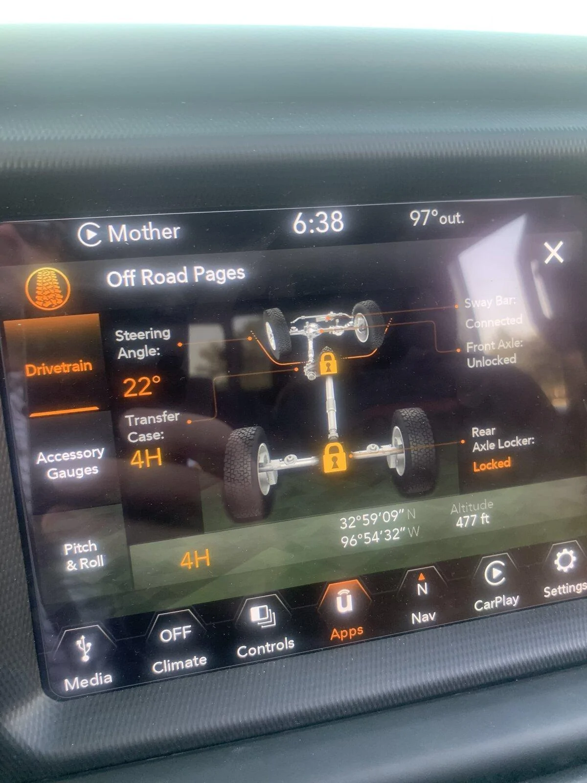

I just tried locking the rear in 4 HI and it kept saying to put it in 4 Lo. Idk what I'm doing wrong. It's not working for me
There have been a few threads on this even a couple of youtube videos. The main thing is to make sure to disable the traction control a lot of people seem to forget that step or assume it's done. Press the button for 5-6 seconds and it will flash on the info screen. I watched a dealer rep demonstrate it on a mojave then my personal rubicon so I know it can be done.
4hi>offroad+>disable traction control>lock rear = win
*Edit*Also as I was just informed early MY21's still had MY20 drivetrain firmware that could do it too.

I put it in 4hi then did the traction control held it for 5 seconds heard the beep then put on off road pages then tried the rear locker and it kept saying put it in 4 Lo
I think when you turn the off road pages on, it turns traction control back on, so you have to do it in a different order
1) 4hi
2) off-road plus
3) traction control off (make sure the dash says it's off)
4) lock diff
If that doesn't work, it may be that you have an early '21, and need a firmware update. This sequence works for me.
Edit: I see I said the same exact thing as @Rvalas. Sorry!
I just tried it in the order u said. And it worked perfect. Sweeeeeeeet
