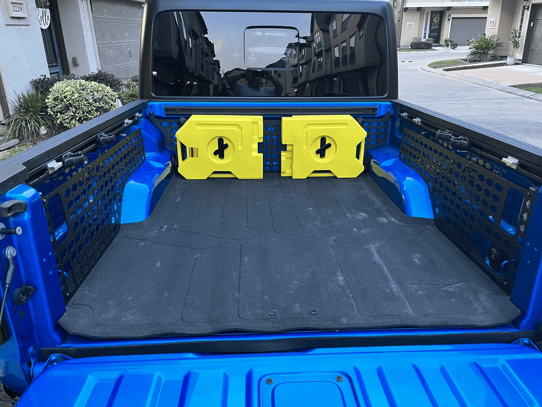

I'm so tired of the rotopax.
I know what you mean. I started out carrying 5-gallon jugs. You can see one of the yellow jugs in the picture below. On this trip, we drove through Nevada where fuel is very limited, especially when towing. I soon learned that it was very inconvenient to carry and transfer fuel from jugs, especially using the double flap filler neck. We finally got the 40-gallon auxiliary fuel tank and that made things so much easier.

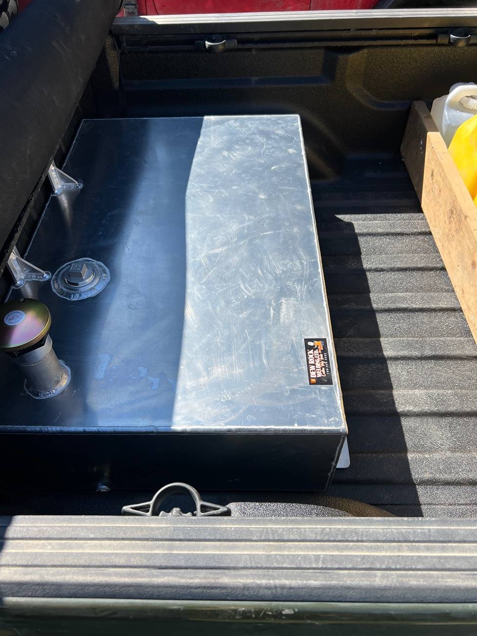

This is what I am using, but it only carries 6gallon., 3 gll each.
I am looking to put something under bead of the truck and it need to connected to main talk. this is for diesel.

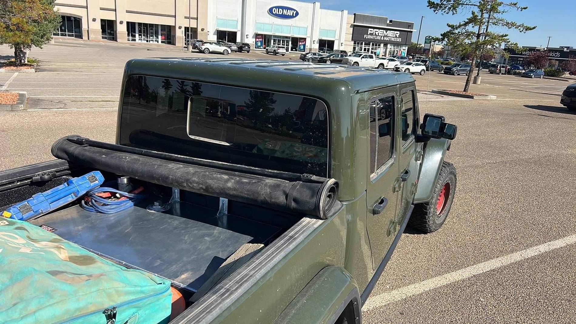

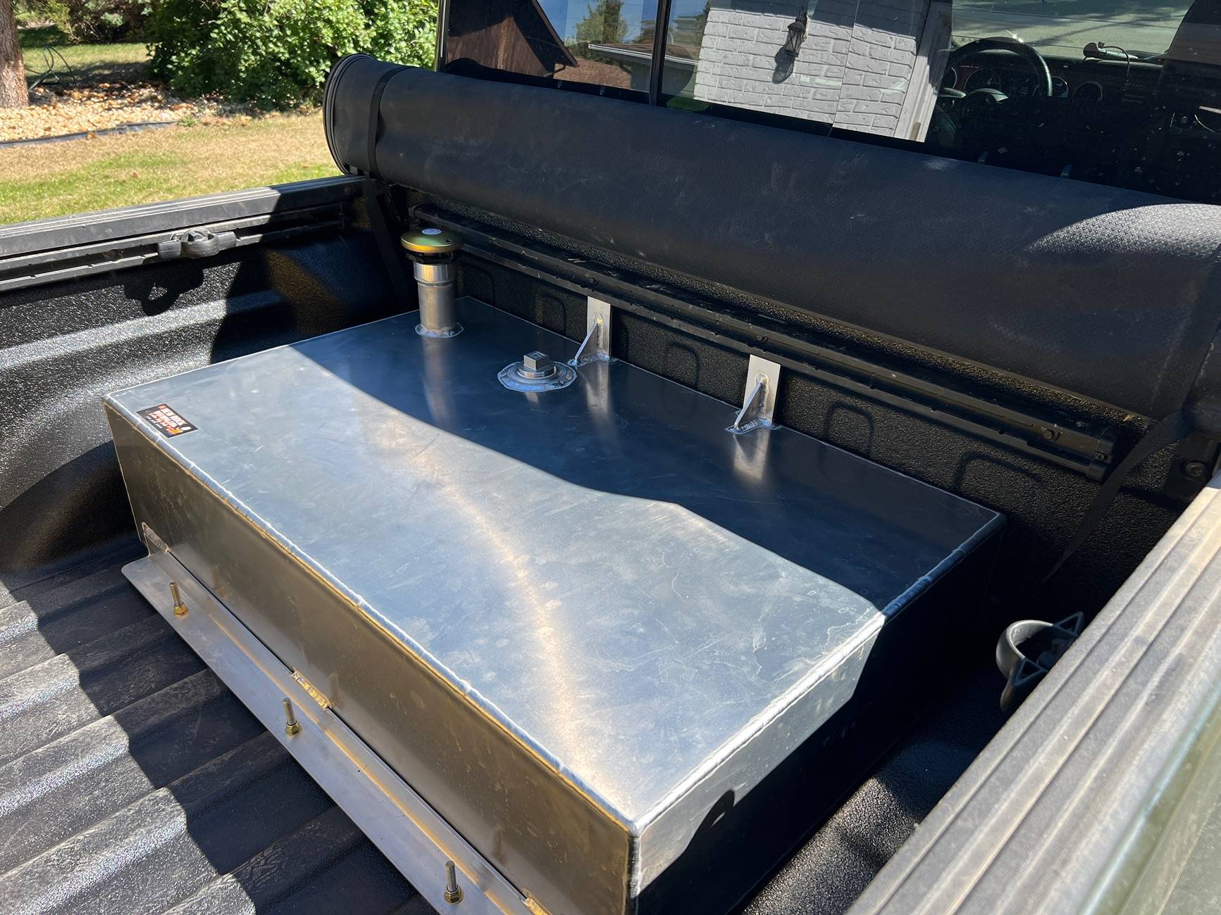

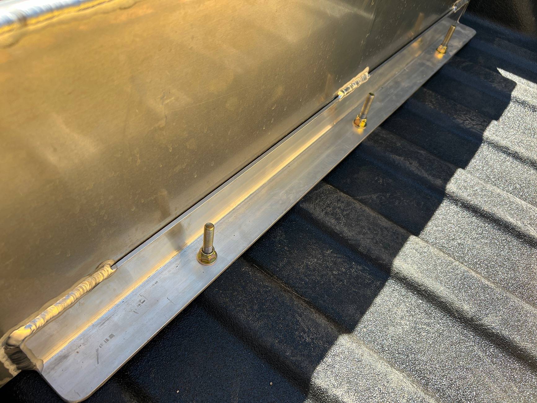

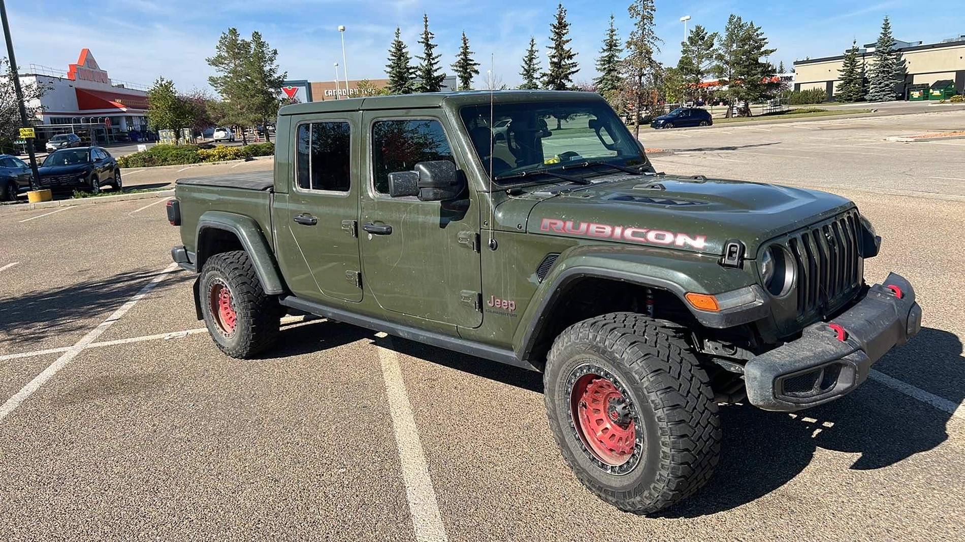

I just had this custom-made slip tank for my truck built and installed in the back for my diesel. it has a gravity valve in it that allows it to fill up while you’re driving and it’s tied into my auxiliary three switch so it will not work when the truck is turned off. I’m just filling my tank while driving for the first time after putting 100 L into it and it’s slow as fuck. It’s taking over an hour and a half to go from an eighth of a tank to full but it works and that’s all I care about the tank should hold close to 120 L full and with the diesel that’s an extra two tanks of fuel.
Do you have a vent valve on top of the tank? If you don't, you should. It will fill up the other tank faster.

Not currently, but it’ll be something I’ll look into. I honestly don’t care how long it takes as I’m often driving for several hrs

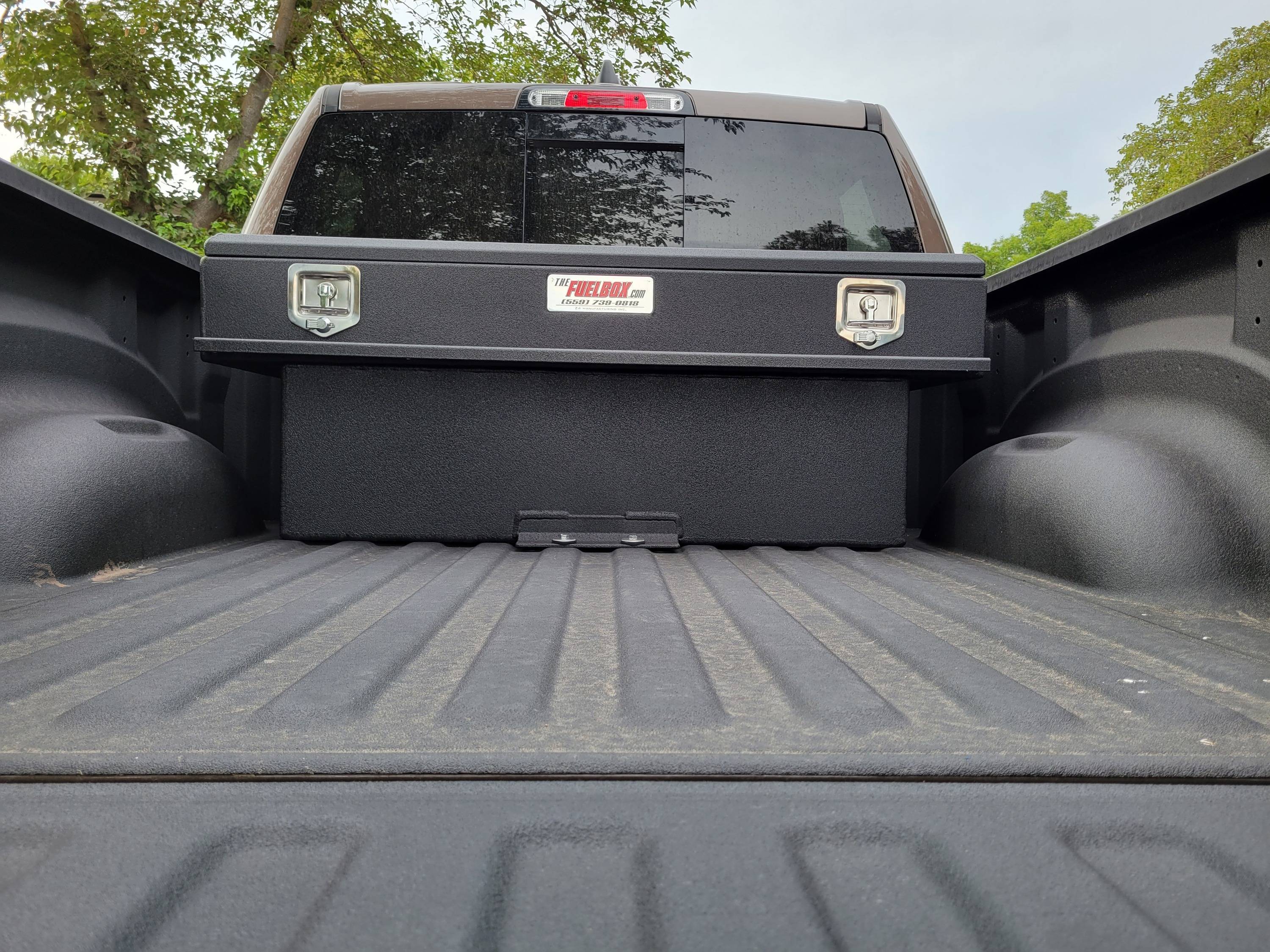

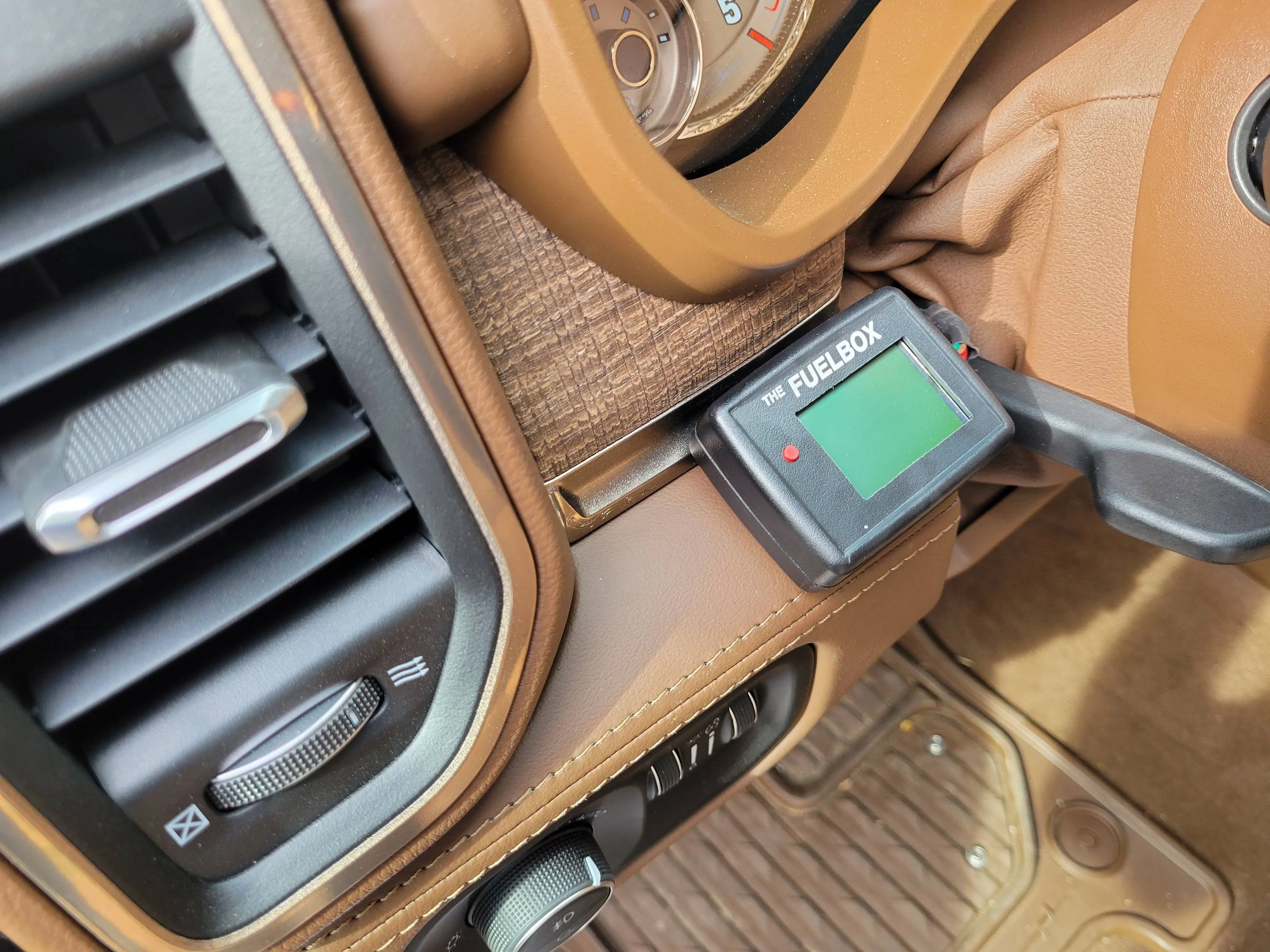

I would guess that my auxiliary pumps are pumping approximately 1 gallon per minute. I've got a digital display that tells me roughly how full the tanks are. I've never timed it, but I'm guessing it would take 25 minutes to pump 25 gallons. Mine will auto fill once it gets down to about a 1/4 tank, or I can push the small red button to activate the pump. The pump will run for a set period of time unless I push the button a second time to shut the pump off.
That’s on a slip tank?
That's correct. I have digital display on both trucks. The 2015 Ram EcoDiesel has a 40-gallon tank. The 2020 Ram EcoDiesel has a 37-gallon tank and toolbox combo. The pump transfers fuel directly to the OE tank.
I was thinking about installing one on the Jeep, but I have decided against it. Instead, I will carry a portable fuel cell and use a battery-operated pump to transfer fuel from the fuel cell to the filler neck.
