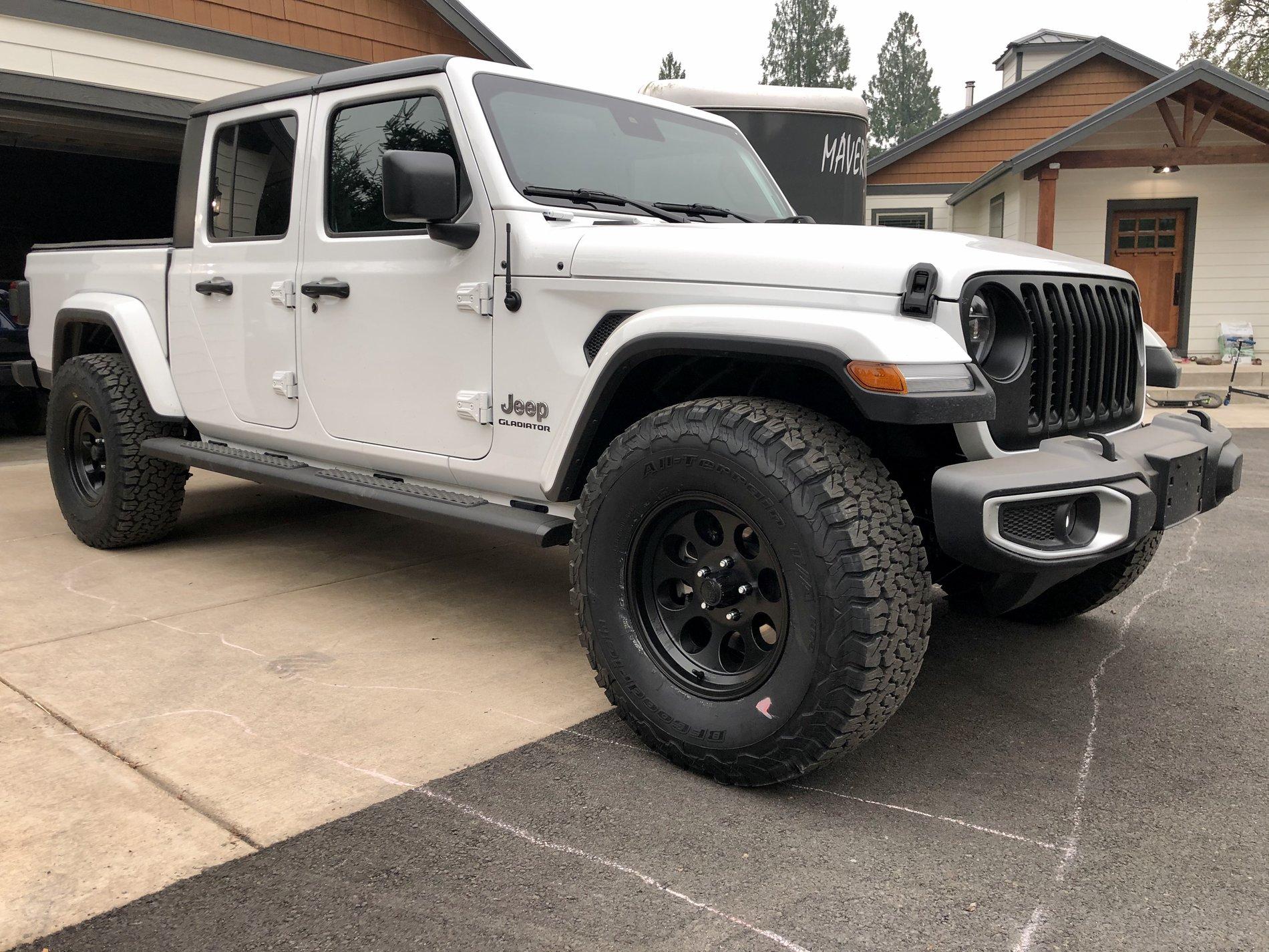

I just put these on my truck. Love them, smooth ride, quiet ride, great handling and would definitely recommend.
BFG K02’s in a 315/70r17 with C load range
next up is a 2” leveling kit in the front

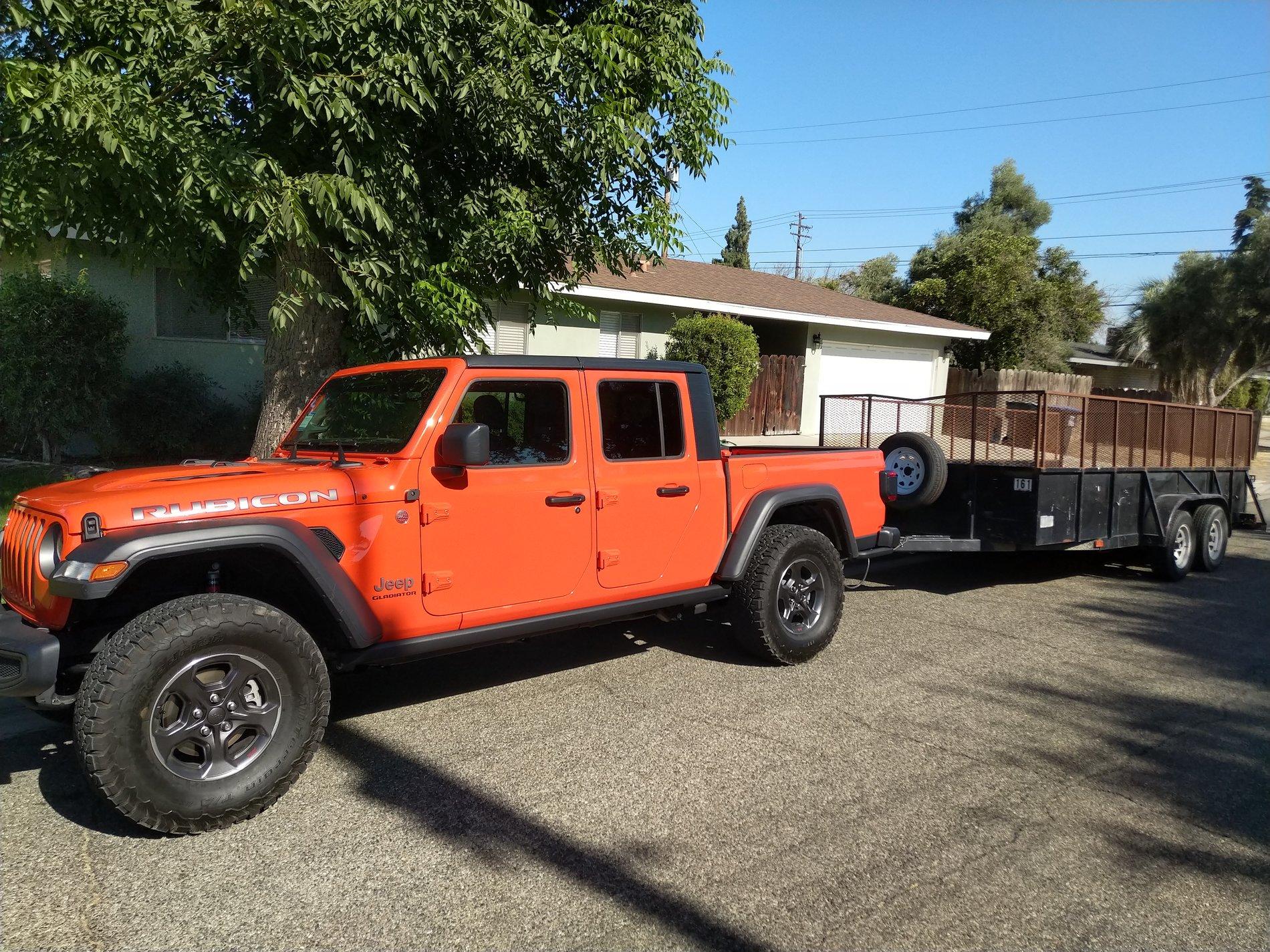

The KO2's tow just fine, as well. Comfortable on long trips, which is SO odd to say about a Jeep! San Diego and Eureka/Arcata are over 750 miles apart, been both places already since June, San Diego twice.

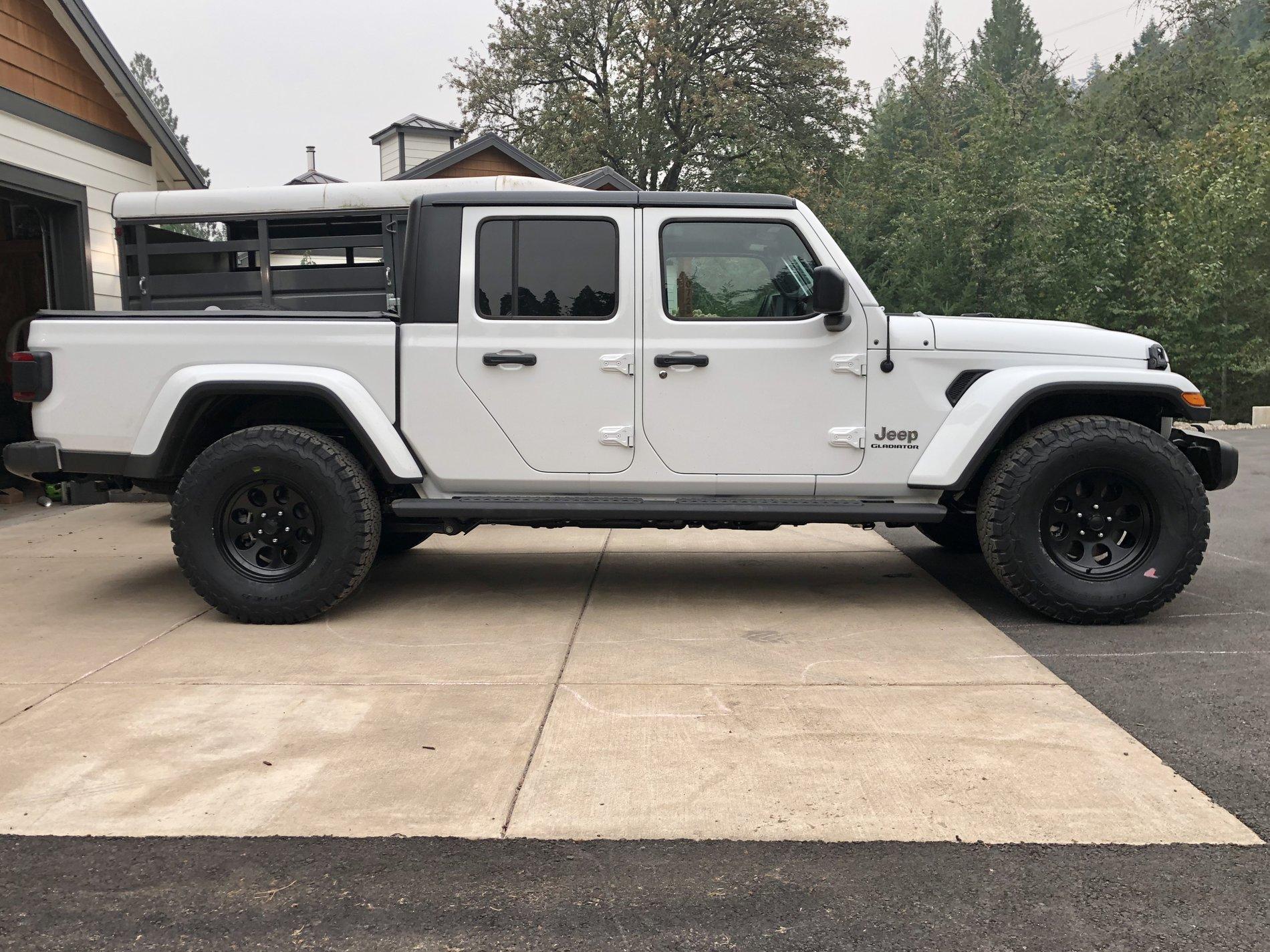

Wheels are 17x9 with a 0 offset. In my opinion, it rides and tracks better with the new setup.
With a zero offset, do you have any rubbing? I like the size of tires you are running I am worried about rubbing. I most likely won’t be doing any heavy off-road/ climbing.

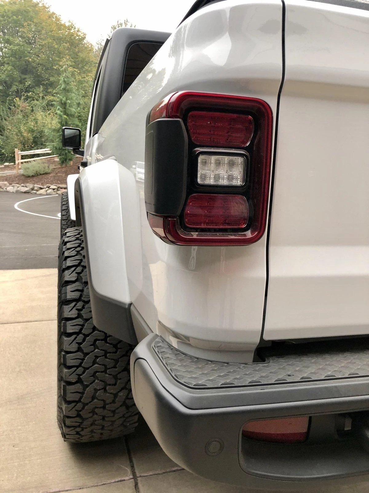

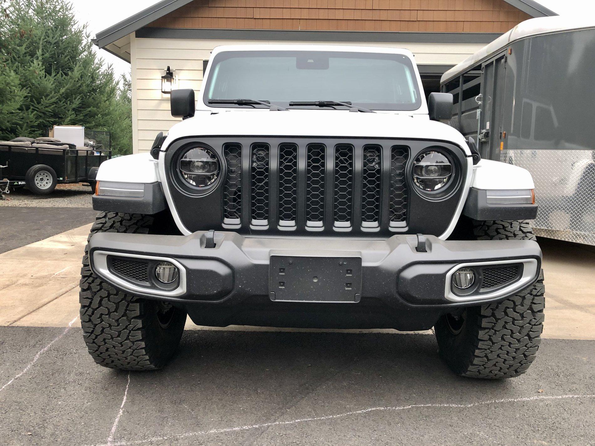

No rubbing at all. I am adding a 2” leveling kit to the front this week, but that is solely for appearance to remove the rake. As it sits now on stock suspension, zero issues. Honestly, with the 0 offset sitting as wide as it is already, I’d be weary going any wider. I feel like at 0 offset with a 12.5 in wide tire, I’m already going to have a mess on the side of my truck come rain season.

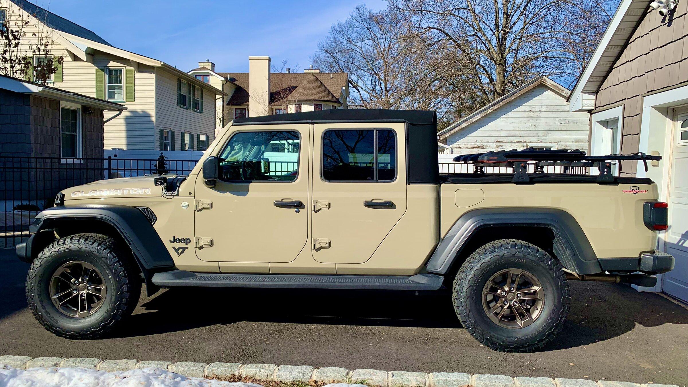

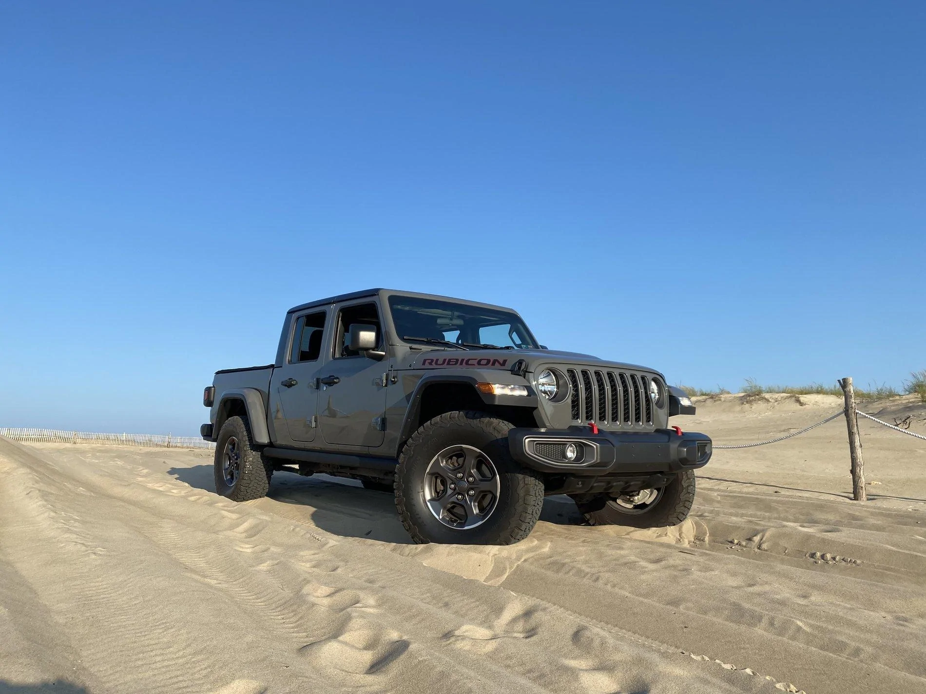

I had 285 E rated tires and just replaced them with 315 C rated (Ford Performance with the slightly higher speed rating.) Much smoother than the 285 E rated tires. Looks better too!
Jeep Gladiator Looking at running BFG K02 315/70r17 in C Load Range, any experience with this combination? IMG_9273 (1)
