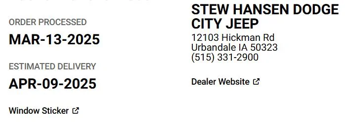

All systems go. New JT supposedly arriving on 14th but we know how inaccurate that web site is. Dealer thinks it will be earlier than that.
In any case, I figure I now have 1 week to strip my 22 and get it ready for the trade.

Dealer says the Gladiator left Toledo 4-5-25. It's 2 to 3 days allowing for mandatory stops/breaks OTR drivers must make, plus allowing for other things.
When I ordered my 2020, it left Toledo on a Sunday night and arrived two days later - on that Tuesday morning bright and early.
