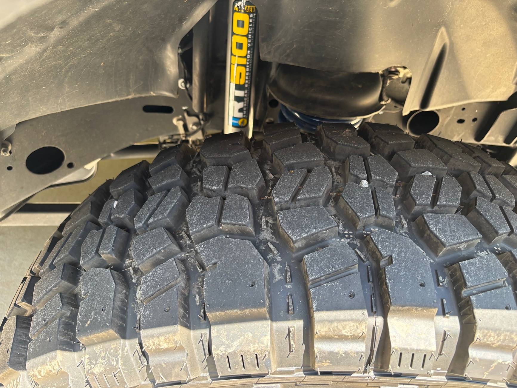

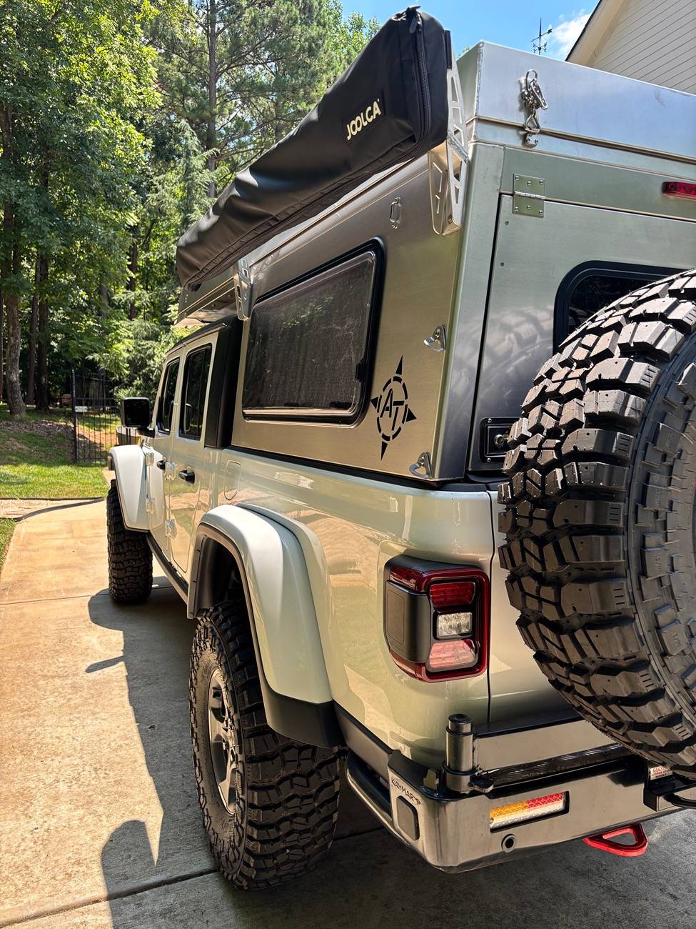

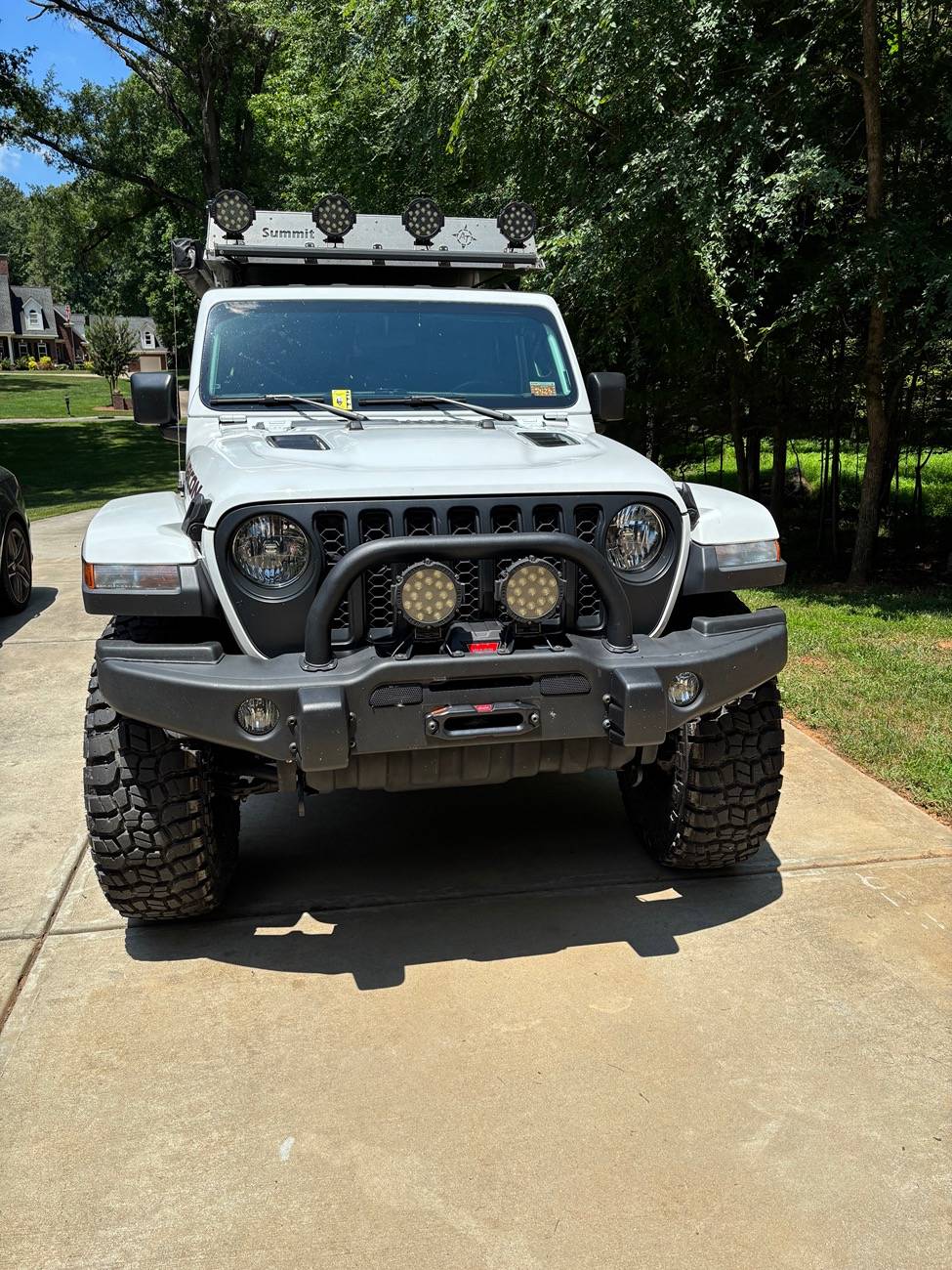

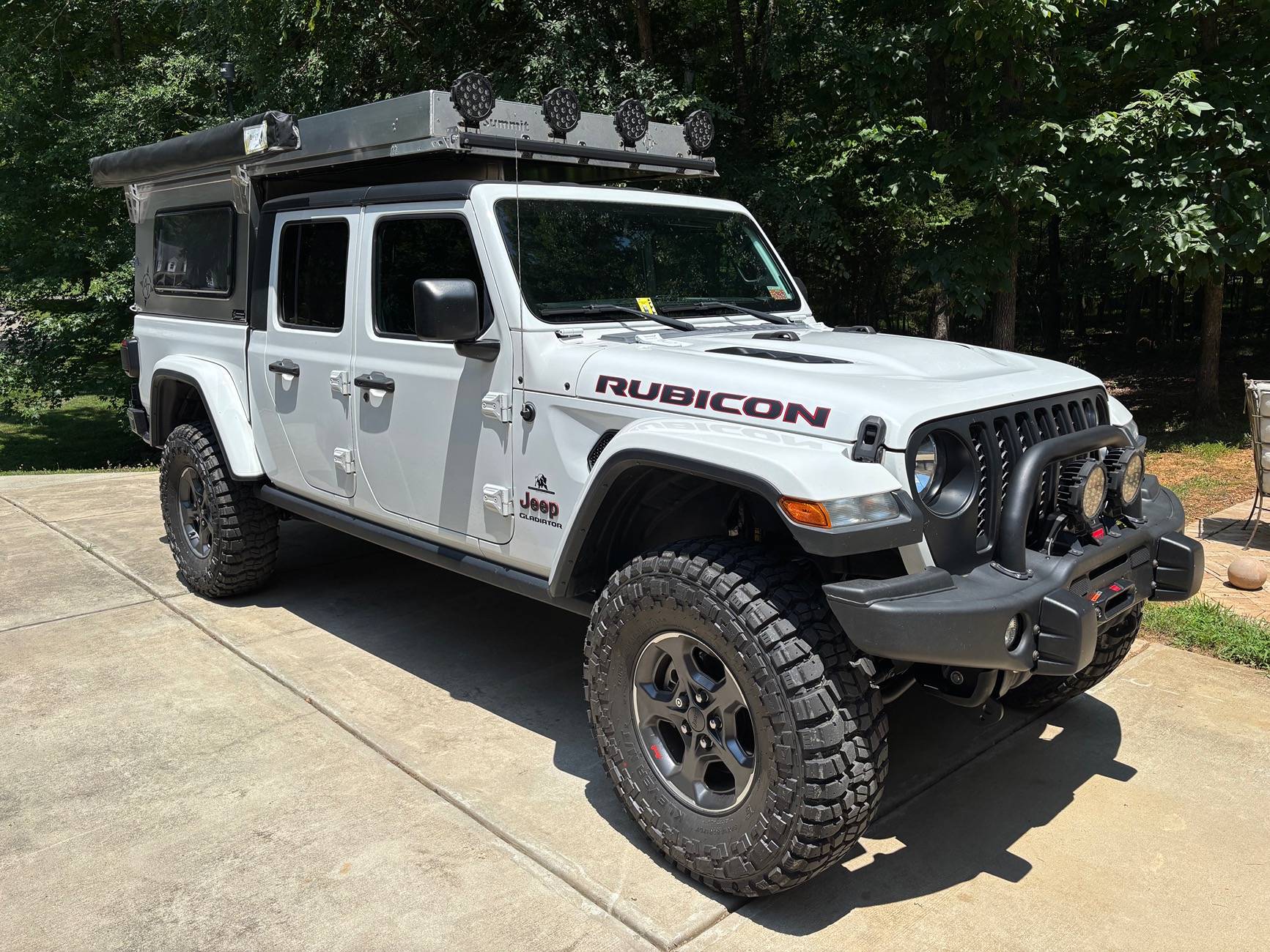

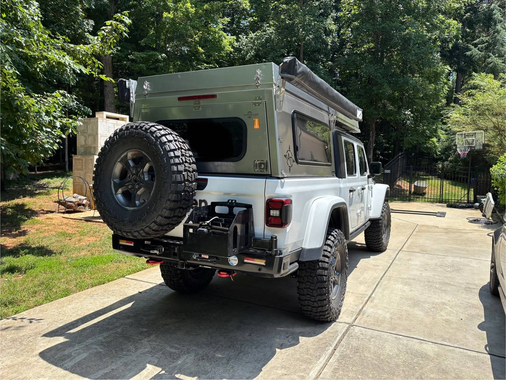

Thanks again @Rusty PW. I’ll do a writeup on mine so others have the benefit of my experience too.
Last week, I installed a set of Kenda MT2s size 37 x 12.5 R17 on stock Gladiator Rubicon 17 x 7.5 wheels. Because the 12.5 Kendas spec for an 8ā€ rim (many 12.5 tires spec for a 8.5 rim), I didn’t feel the need to change to wider wheels. This tire on this wheel (on Rubicon axles) fits flush with the fenders (my preference) and have no clearance issues (on an AEV high capacity 3.5ā€ lift).
Took a trip and already put almost 1,000 miles on these tires with no issues.
Good dry road traction and handling. Have been impressed with heavy rain and wet road traction too. Slightly quieter than my worn Falken MTs and ride smooth (even when running 50 psi to contribute to better gas mileage).
Had the chance to do a forest trail this weekend and didn’t need to switch into 4wd or air down the tires - just drove through with no slippage. Also very sure footed on steep sections that were covered in loose gravel (my prior Falkens seemed to float/dance on gravel). While I didn’t get to test deep mud, I can’t see how the aggressive deep lug pattern won’t just dig down and claw its way out.
Speaking of the tread pattern, the wide open channels between lugs on the tire do pick up larger rocks that later fly out on the highway. Smaller pea sized rocks can wedge inside the tread pattern and a few will stay (similar to AT tires).
Completely unrelated to Kenda, some shops (Goodyear plus three local tire retailers) stated they don’t have equipment rated to balance 37ā€ tires (cutoff seems to be 35ā€). After four attempts, Pepboys balanced the set but charged an extra ā€œlarge tire feeā€ and only warranty the balancing for 90 days.
I’m running stock Rubicon gears. Will need to re-gear at some point but it’s not as bad as I thought. The truck does hunt for gears more with the taller tires as expected. Uphill grades on the highway tend to be in 5th/6th gear. On extremely steep winding mountain passes the truck held 2nd gear much longer than before, so being less aggressive on the accelerator pedal avoided extended high RPMs. The taller tires definitely kept me at slower speeds which isn’t a bad thing. On the highway between 65 - 75 seemed to be the sweet spot.
Overall, I’m pleased and I’d buy another set.
