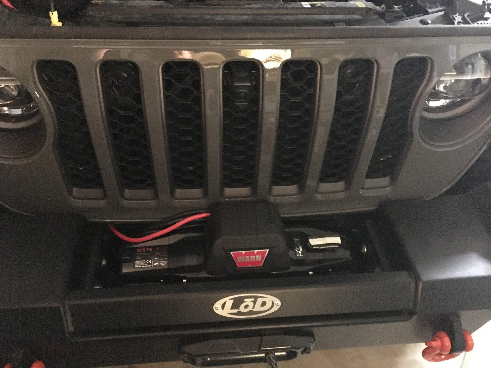

Good Sunday morning folks. I am looking for suggestions regarding my winch install. Installed a Warn winch yesterday and the cables coming out of the back are rubbing the front grill and are pretty tight up against it. Any suggestions to correct that or prevent damage to the paint? Thanks in advance.

I have a Smittybilt and the wires do the same. Have had it on for a year or so. Have not had any issues with it scratching the paint, or even scuffing it for that matter. And even if it did, I don't care it's hidden by the winch.

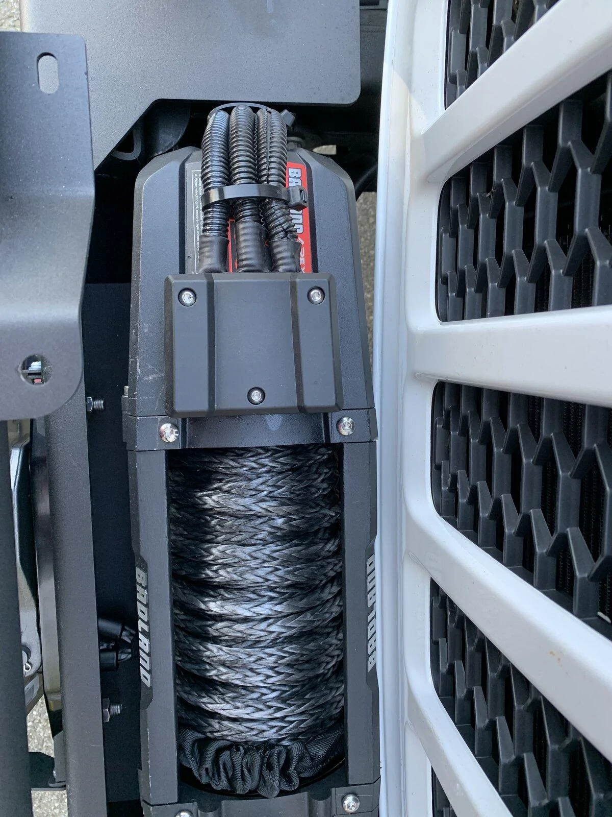

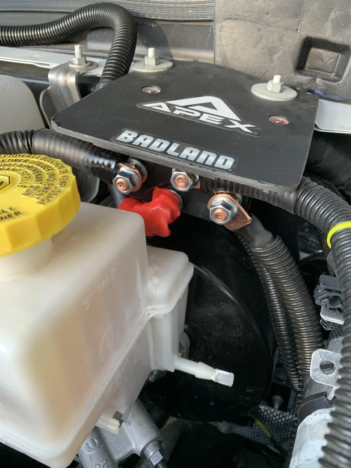

I don't know if it's doable on the Warn, but on the Apex Badland the positive cable can be relocated coming out of the head.

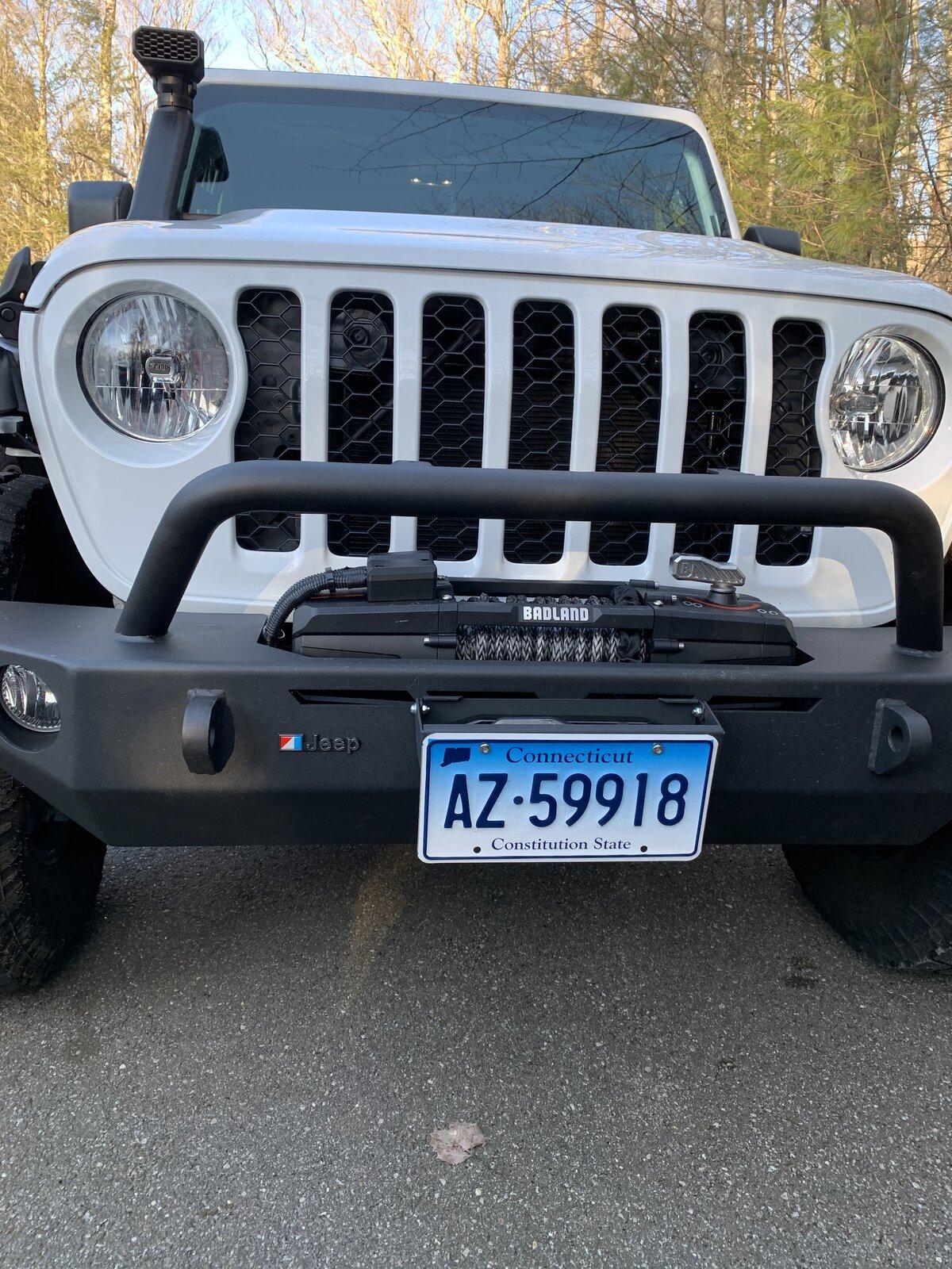

I have a Warn EVO 10s and have the same issue. I removed the control box, rotated the wires as much as I could, dremeled the housing a bit, rotated a little more, and reinstalled. It still rubs but not as bad.
i considered a relocate but have not gotten around to it yet.
i need to recenter it. The winch is centered, but the box is not, so it looks funny. But again, I have not gotten around to it yet.

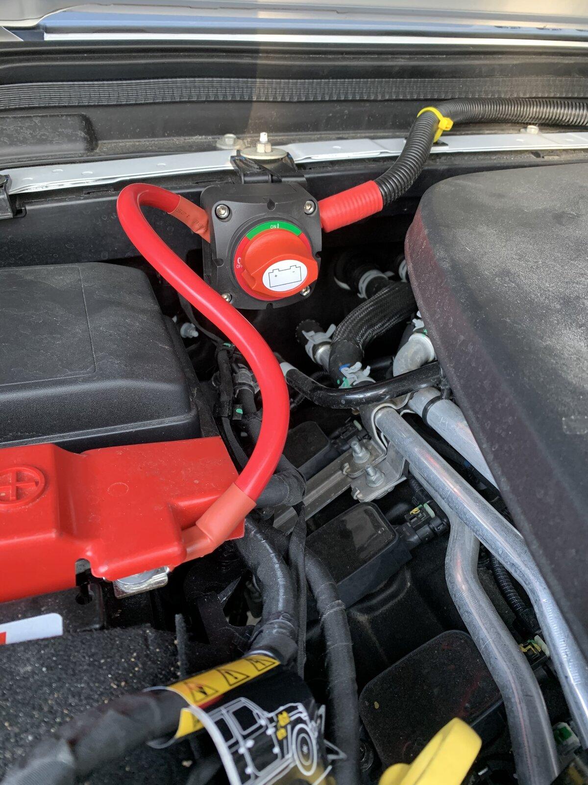

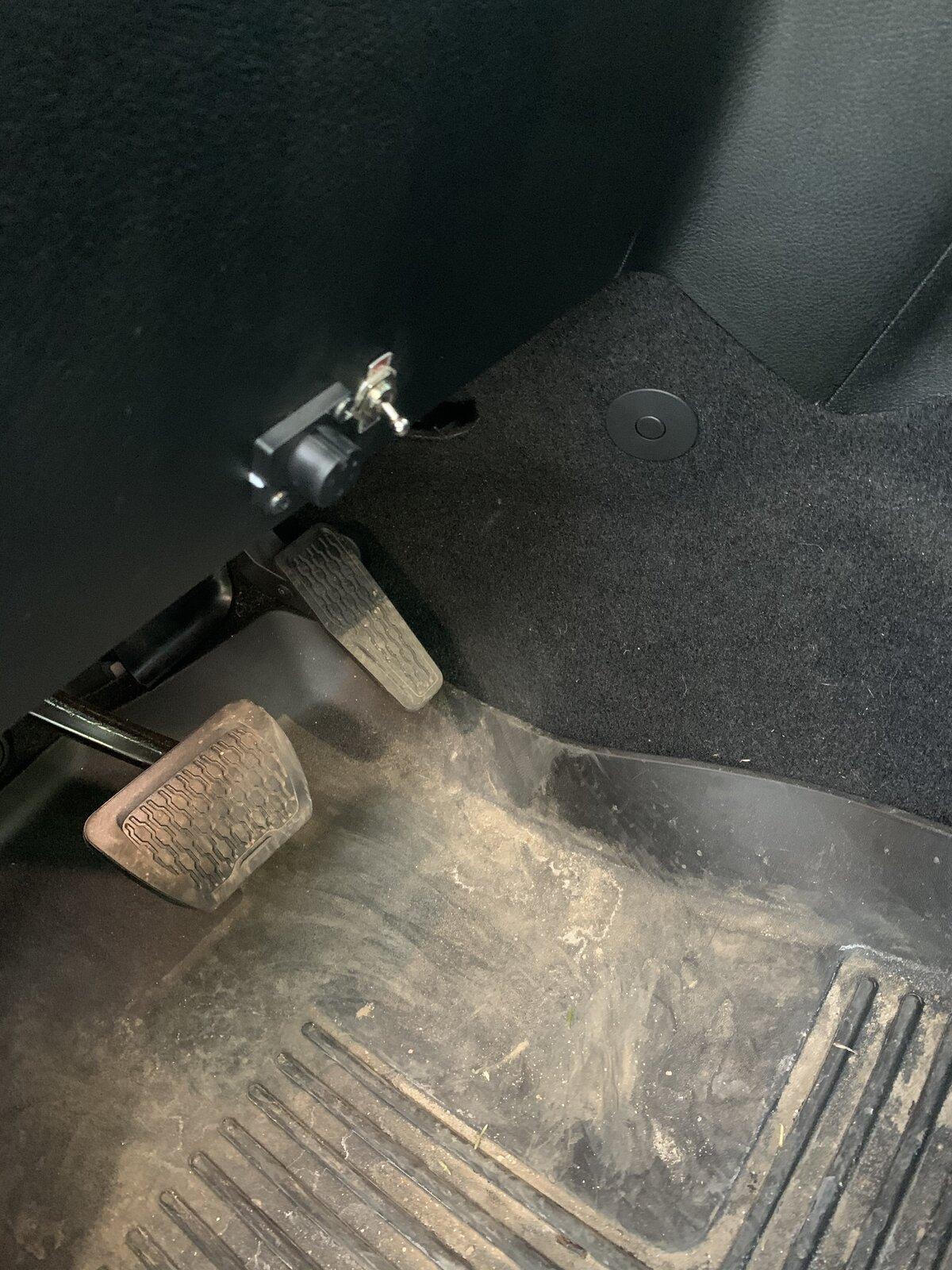

I had the same problem with the Harbor freight winch that I bought. I ended up disassembling it and relocating the solenoid under the hood. The plug for the hand controls and the switch for the wireless controller was relocated to the knee panel inside the cab.
