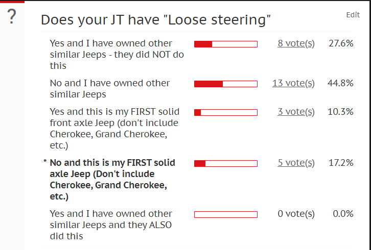

Look at my poll so far - and how many of those have OWNED OTHER SIMILAR JEEPS - perhaps Wrangler, etc. - and those were ok.
8 of the people who voted said they have owned other similar Jeeps and those did not do this.........
So far no one has responded that their OTHER Jeeps did this - so ---------------- it's not a Jeep thing according to the voters.

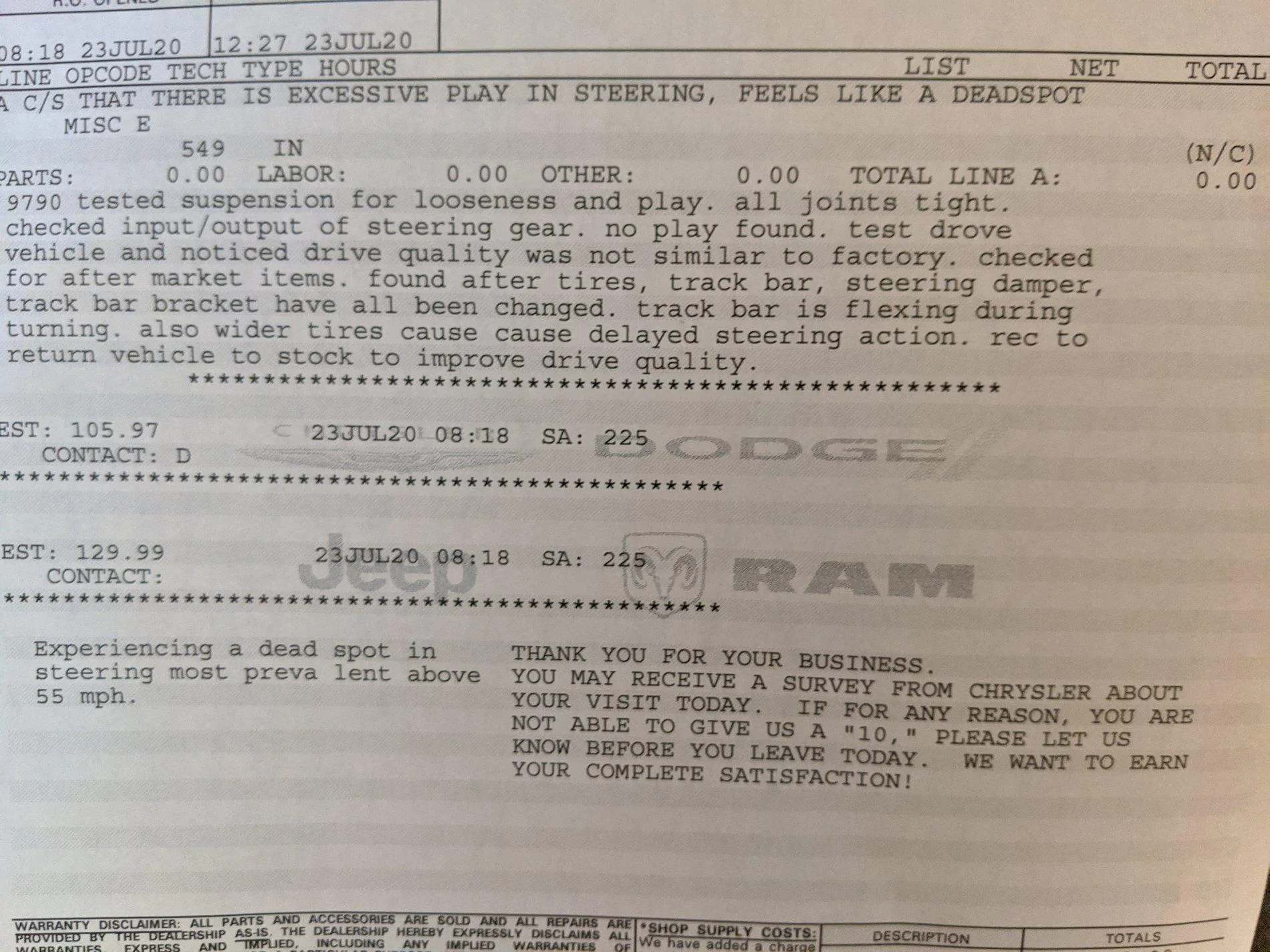

Hoping with some time passed since I last asked the dealer to take a look at the steering, I tried again. Set up @JeepCares case number (after failing first time to find them helpful) and they arranged for service manager to ride with me.
Service Manager had some backhanded comments about me calling Jeep Cares, but looked at it and agreed it was not right.
I thought for a moment my faulty steering box was finally going to get replaced. Got the call a few hours later....and nope.
The write up acknowledged an issue but my Synergy bracket, trackbar, stabilizer, and tires were all to blame.
Jeep Cares was more communicative this round and just had to defer to dealership evaluation - the way the service manager talked though it was clear he was annoyed by their involvement.
