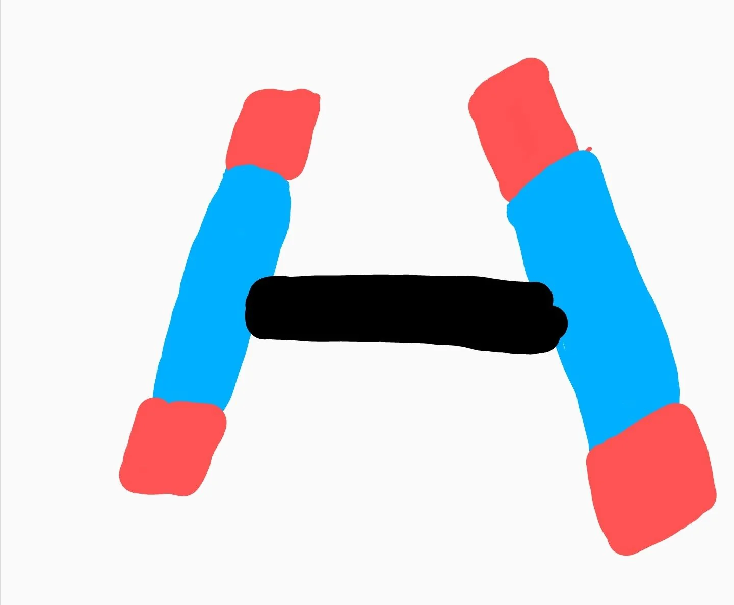

Forgive the quick cellphone diagram.
So this is looking down at the axle.
Black is the axle and blue is factory size tires with exhageration of toe in.
With red I have shown what larger tires does to the angle. 20* of toe in for blue tires is nowhere near the same as 20* of toe in for the red tires.
I have never seen an alignment machine that took oversize tires into account since even the ones that strap to the tire are still setting the flange toe to the factory spec which results in too much toe for over size tires. Go measure it I'm willing to bet you are much closer to 1/4 in toe in than the 1/16th to 1/8th that jeeps tend to work best with.
The #1 symptom of too much toe in is very small inputs to the steering wheel turn into too much correction on the road.
Imagine it this way. With too much toe in one tire is already turned. A light input turns it even further.
This is kinda hard to explain via forum if I messed it up let me know I'll figure out a better way to word it.
Sorry Professor :LOL:
but I disagree.
These alignment machines clamp on the wheels and measure angle in degrees, not inches.
FOR TOE: tire size should not matter.
OK, I stuck my weenie out there,
WHO's RIGHT?

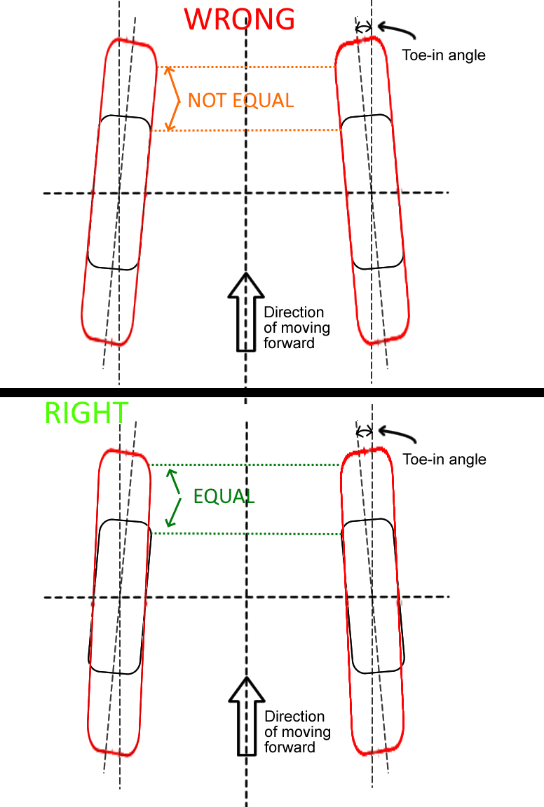

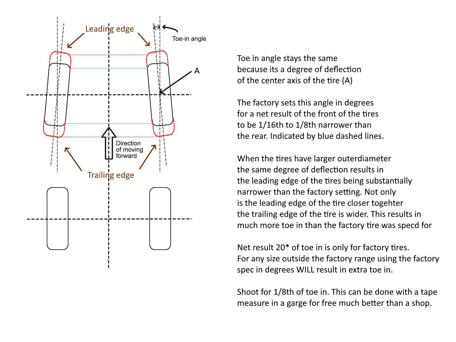

Jeep Gladiator Loose Steering? toe setti
If this doesn't explain it I don't know how else to help.
The basic gist is the further forward the leading edge is the closer the tires will be together if using factory degree setting. SO use 1/8th in narrower on the front to replicate factory toe in.

I do have a better than average understanding of mechanics, my question was directed to how much toe in degree was the 1/8” you suggested and I understand the longer the 2 angles the closer an intersecting point will get resulting in more actual toe.
So you are both right, the actual degree stays the same but with the larger tires it makes it more toe with the same degree. I get what you are both saying.

I honestly couldn't tell you because no tire is true to size. No 37 is a true 37 so figuring out what degrees makes 1/8th is outside my skill set.
But I have don't full alignments with nothing more than a tape measure.
On a lightly lifted jeep with fixed control arms it's really easy because you only have one adjustment point you can make.
