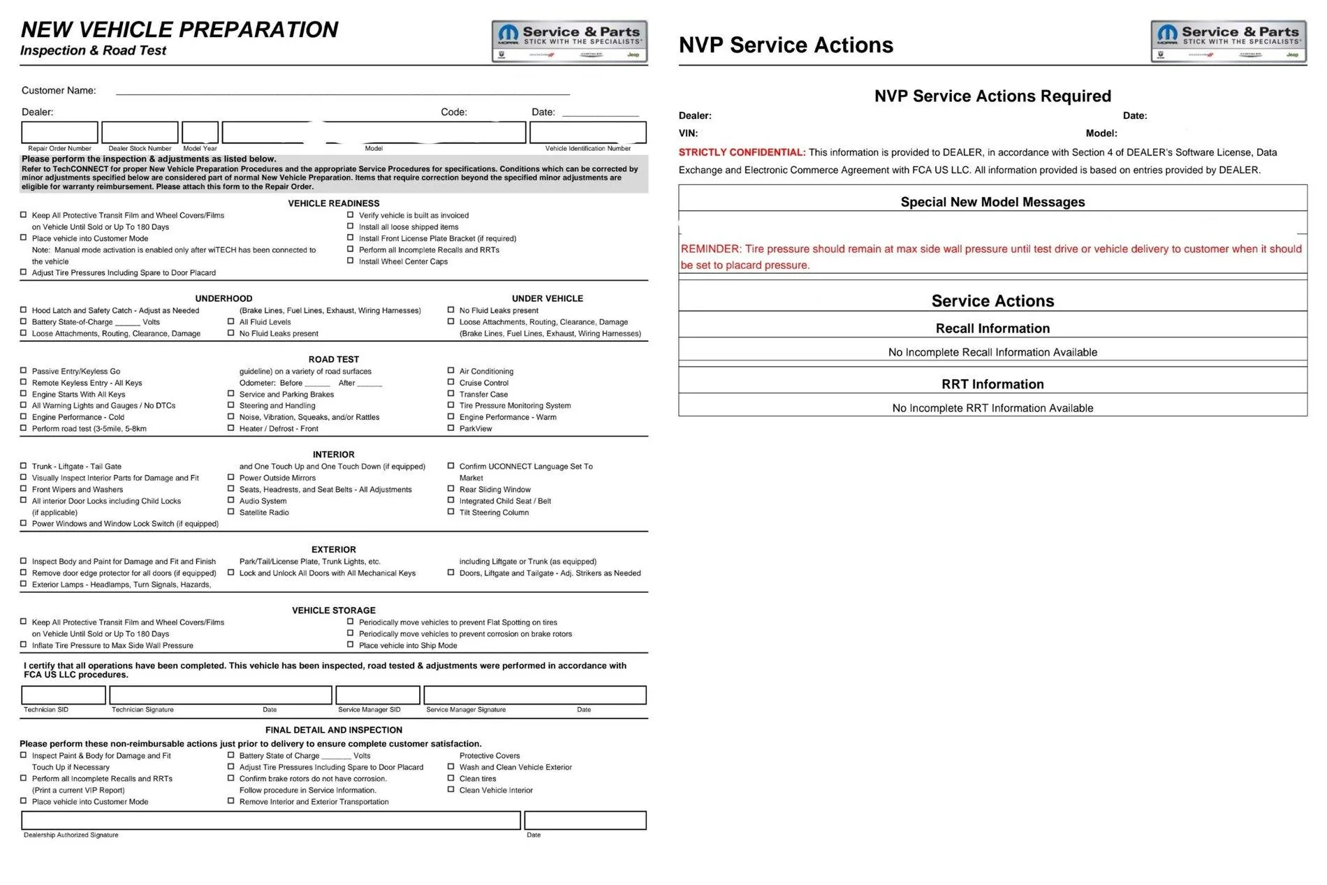

PDI form for those who are saying the dealer should have done more at vehicle check in.
Easiest way to see if it was actually done.... If your tires are overinflated it wasn't done. The factory ships them with more air to prevent flat spots.
Ask for this sheet before you sign anything. If they can't produce it while you are watching they didn't do it.

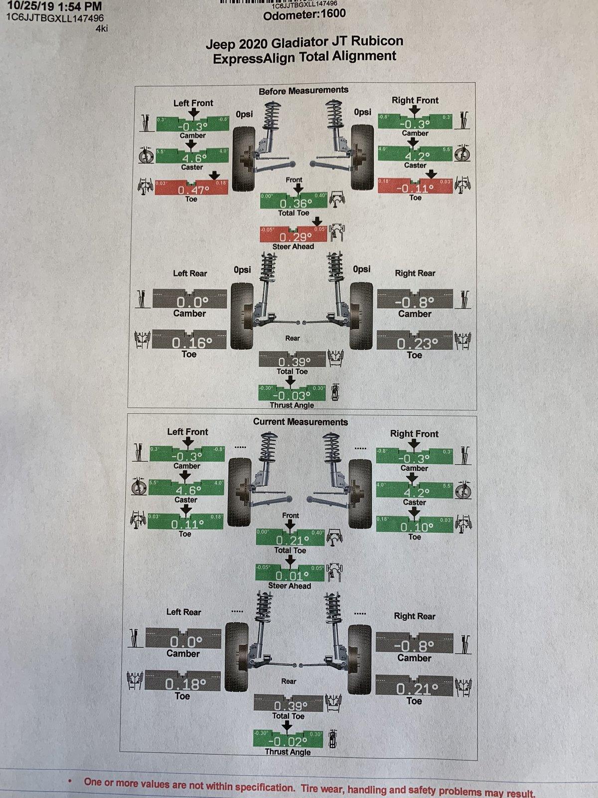

I do have a better than average understanding of mechanics, my question was directed to how much toe in degree was the 1/8” you suggested and I understand the longer the 2 angles the closer an intersecting point will get resulting in more actual toe.
So you are both right, the actual degree stays the same but with the larger tires it makes it more toe with the same degree. I get what you are both saying.
Also after watching the alignment guy adjust the toe it doesn’t look so simple to do in the garage
Was trained in alignment, did many dozens working my way through college - they publish only "inch" specs for passenger cars and vehicles with smaller tires or where tire size won't be an issue or enter into it.
Angle never changes regardless of tire/wheel size - so vehicles with larger wheels/tires or where things can vary - and with modern equipment (modern meaning newer than the Bear and other equipment of the 70s and 80s) it's easier for the computer to measure angles in degrees.
The exact same angle with a much larger tire will result not in more toe in degrees, but in a greater inch
With larger tires you have more footprint on the road - more fore and aft so toe has more impact than a tire with a much smaller footprint on the road where the fore to aft measurement of the footprint in likely half of what some of these tires put down. So these will be more sensitive to toe, toe out on turns and certain other angles and measurements.
If all the tech does or can do is read a computer screen and set according to what he's told - well....... I wouldn't want to use that guy to do my alignments (I used to do mine but I no longer have the equipment available to me since I moved and set up my own shop again).
That's about what they were supposedly doing yeeaarrs ago - so not much has changed - they are supposed to ROAD TEST it and that doesn't mean a trip around the block but for most, I bet that's the extent of it. Some dealers have to deal with 15 minutes of busy downtown traffic just to get to a place where they can go over 25 mph. We have a couple dealers like that - land-locked in busy city traffic. So they don't drive vehicles. You can bet many just put the check marks in there, sign it and pass it along. They do that when you go in for basic service these days - I've received those sheets where you go in for oil, filter, etc. and you look down the sheet where they are supposed to check the vehicle over - and they have things checked your vehicle doesn't even HAVE! They simply check the boxes. As a former tech, still restoring cars today, I know when someone is BS'ing and they often are on things like this.
Yep. Time is money and the dealer will cut corners to make more money. If the tire pressure is wrong they will redo the whole thing while I watch.

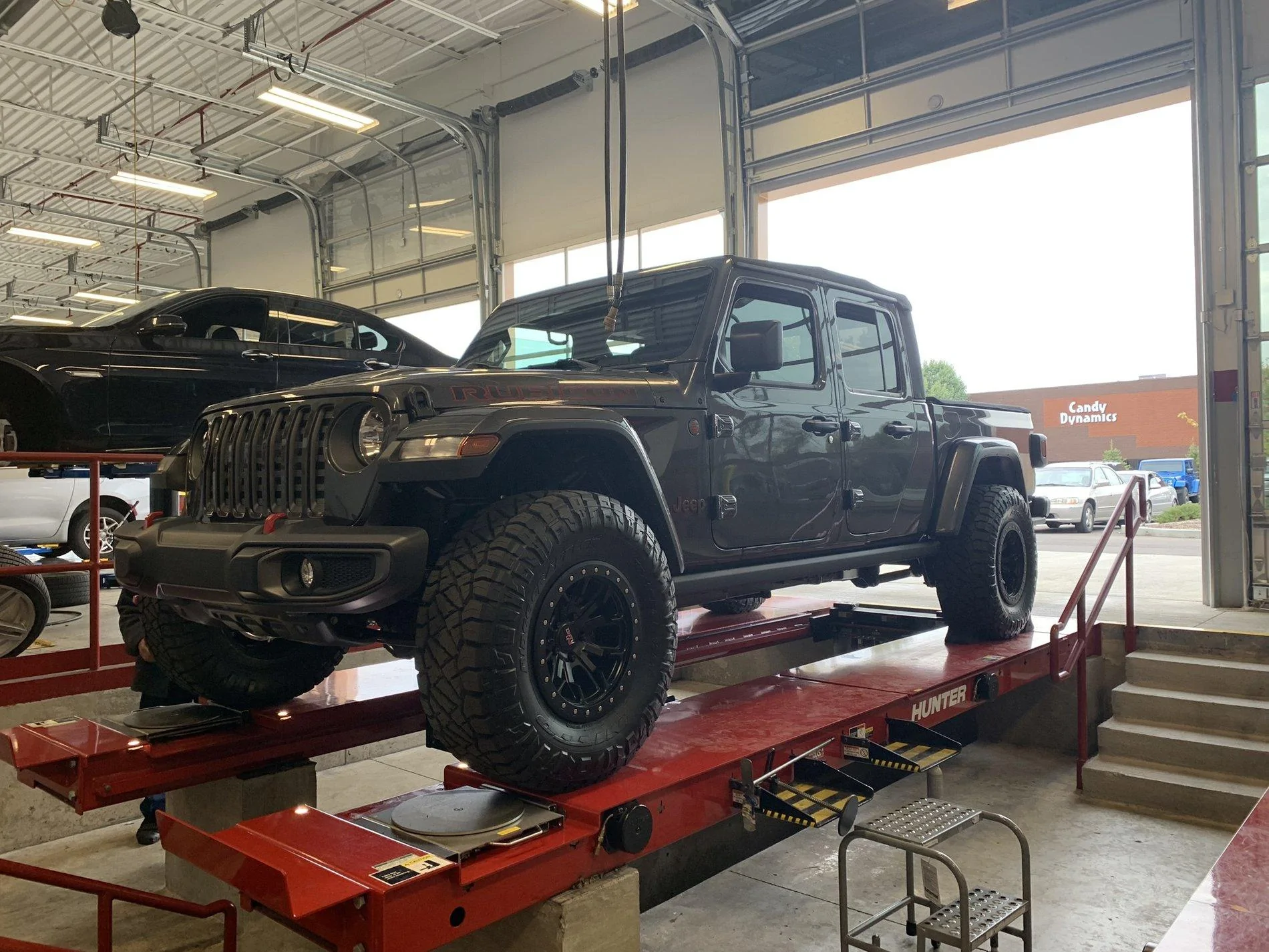

@Oscar Indy & @JP1 per our previous discussion I finally took time to manually measure my toe. With my 35’s and factory recommended toe setting of 20° (21° actually was the closest he could get mine) total toe I had done a few weeks ago, I am sitting at 1/8” toe-in which is what the majority seem to suggest/recommend. I’m not implying either of you were right or wrong I’m just sharing my measurements. I measured as close to center (hub) as possible and measured from the front and rear of the tire. Hope this helps other members

Taking mine to a shop next week, will try to get the before and after specs. For $65, I'm not going to wait for FCA.
