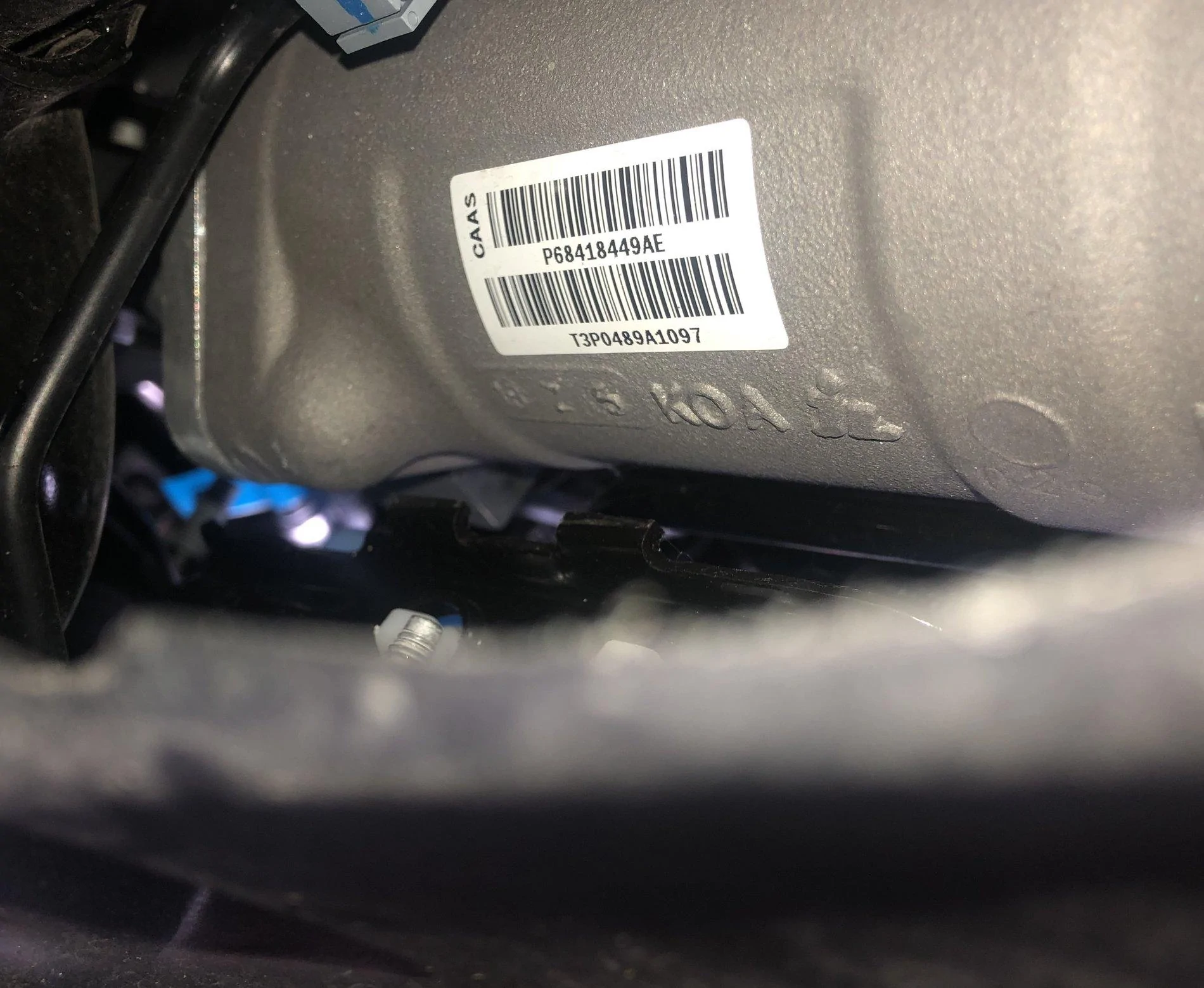

I appreciate your time on this Rocksalt, one more ask if I can... If you (gently) pull back on the ridiculously flimsy splash guard, that p/n sticker should be there. Here’s mine:

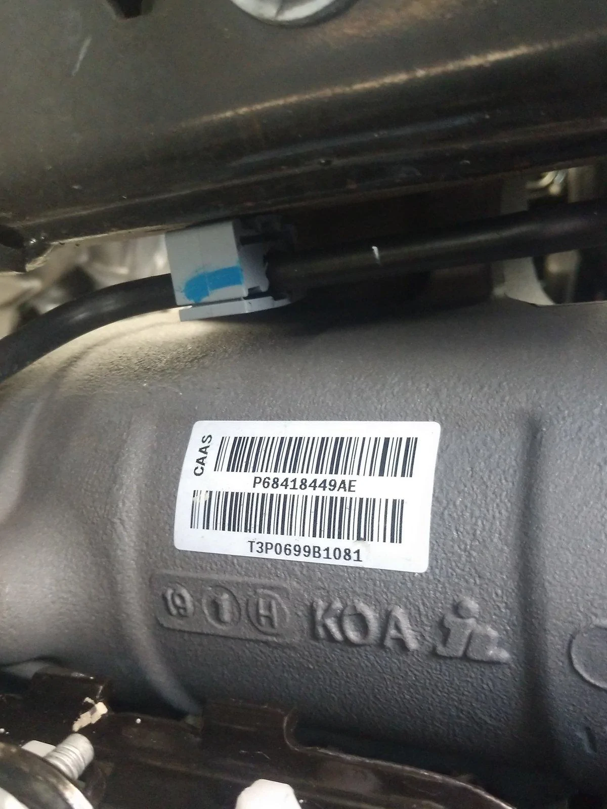

Here's mine. My jt doesn't wander too bad, but it's worse than my 2000 xj

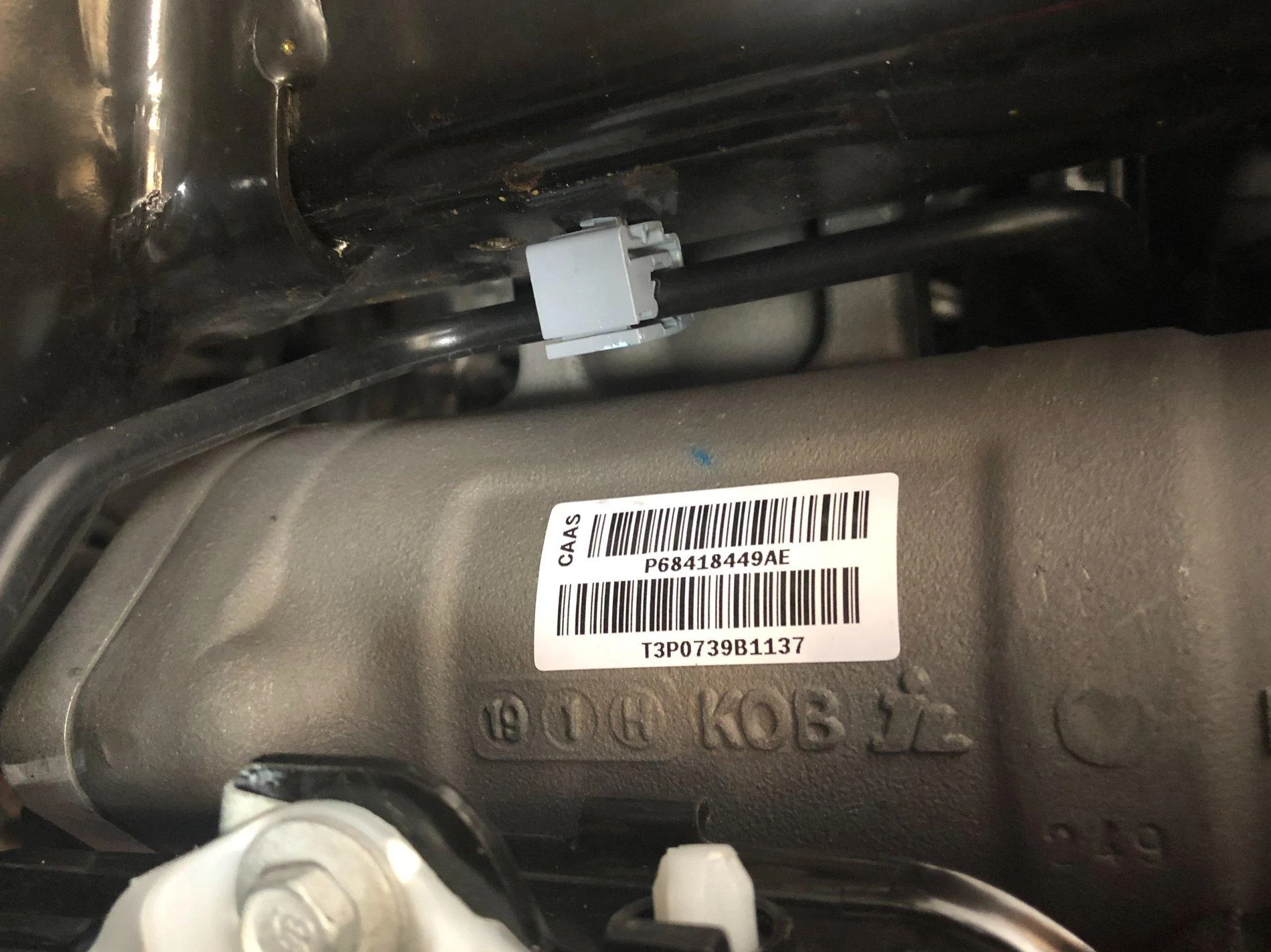

Here is mine.. no wander no looseness
I’m sure that made you appreciate your splash guards more (sorry)... but thank you for the pic.

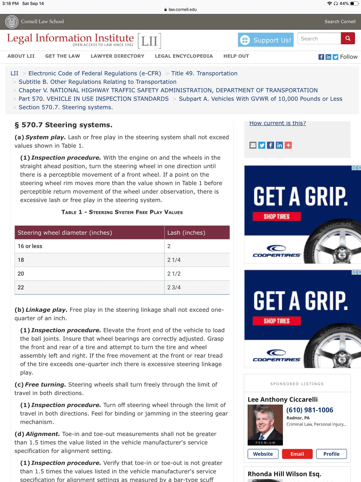

So the steer boxes haven’t changed. Going by the federal guideline for measuring steering play mine is at 1 1/4” which is well within limits for a 15” wheel. I guess it’s time to get it on an alignment rack.
