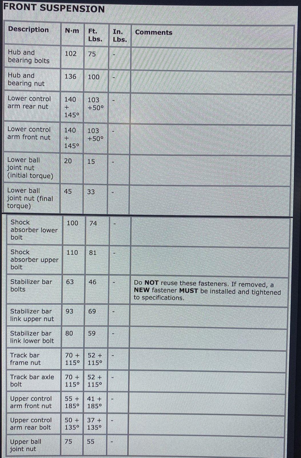

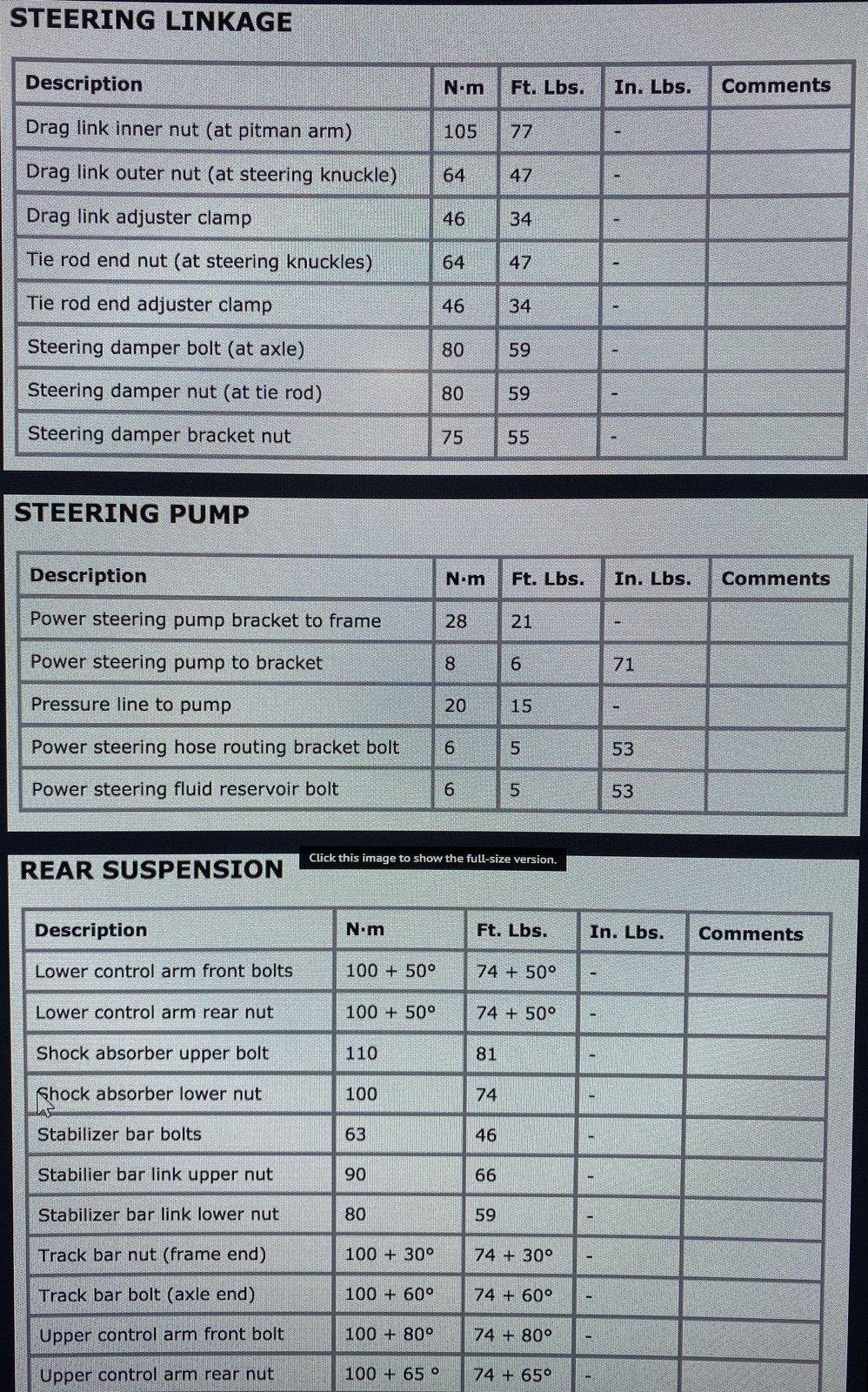

it was insane as I was tightening Down the tie rod and drag link at the knuckles it literally took a bunch of pulls on the torque wrench before finally hitting the 47 ft lb torque spec from the service manual

WTF indeed! Seems like they should come from factory set to torque specs...
a bunch of members on the JL forums had the same findings on their JL. I’m not sure what’s going on. During the manufacturing process they use those torque limiting impact guns that are programmed to a certain torque setting but it seems they may not be working correctly lol
Unacceptable!
BUT, very informative post, so I’m quoting it for all to see again. We need to get info like this compiled into a sticky thread.
