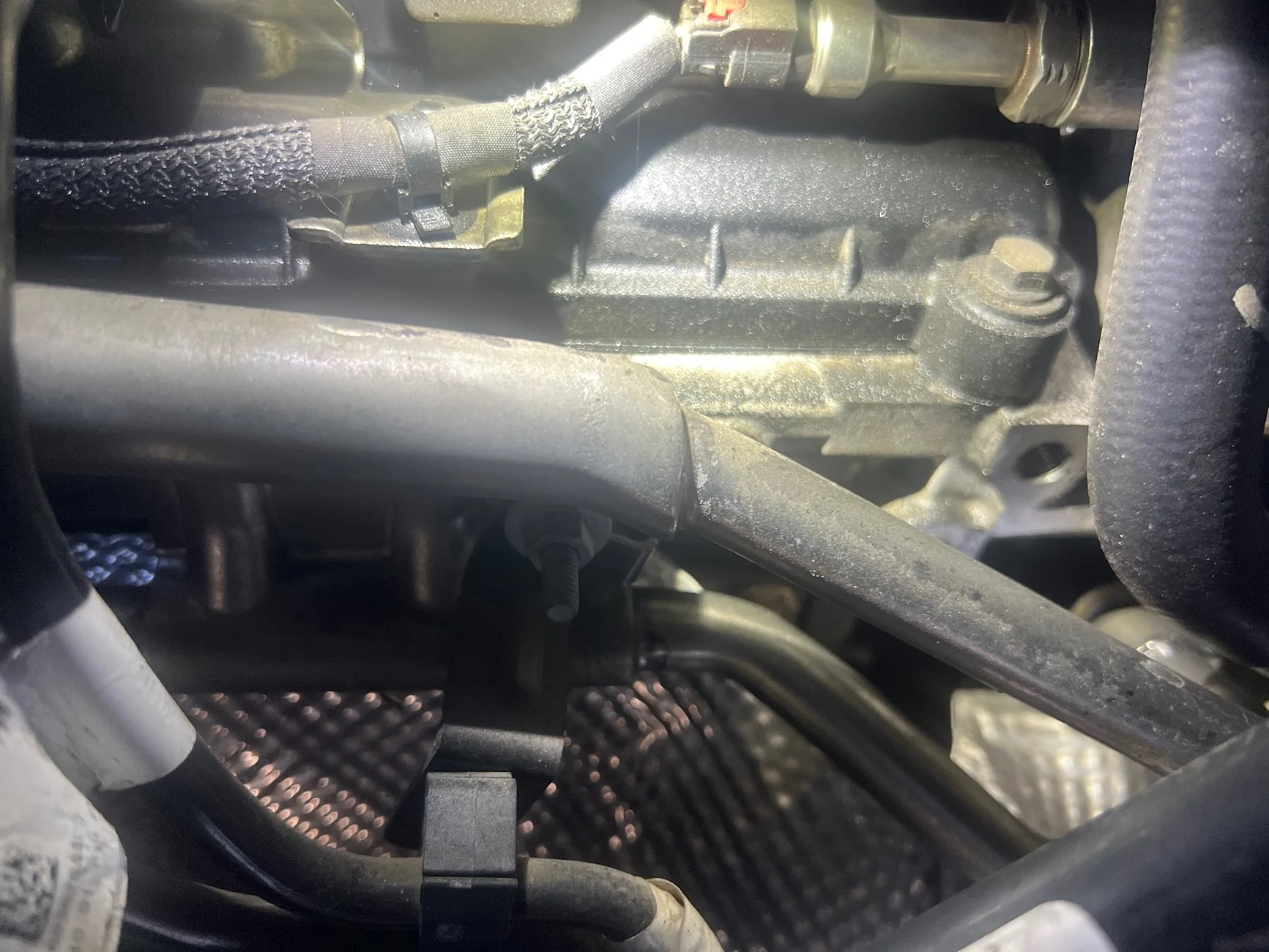

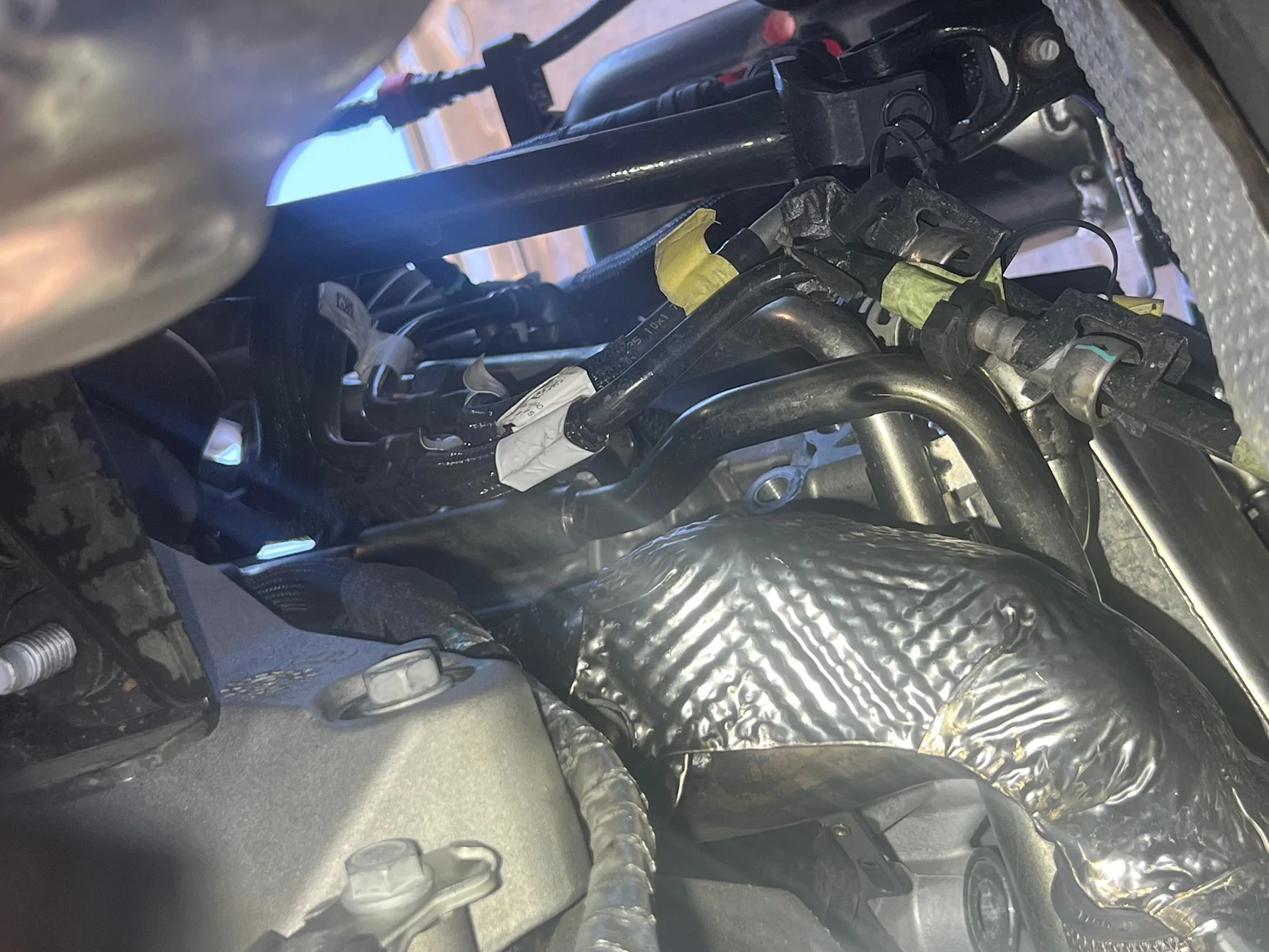

Jeep left me stranded yesterday, I was driving about 60 mph approaching a stop light I let off because it turned yellow but it was late at night and no cars were in sight so I let off the brake and accelerated. Right after that I started to lose power. I pulled over and the jeep turned off completely, I shut it off for a few seconds and attempted to start it and it just cranked for about 5-8 seconds but it didn’t turn on. A bunch of lights came on the dash. After that I didn’t attempt to crank it, I stepped out and noticed what looked like oil dripping down. This morning I went under the hood and jeep to inspect. And the weird thing is that the residue doesn’t feel like oil it almost feels like diesel. Any ideas of what it could be? I will be getting it scanned for CEL codes.
I noticed a lot of oily residue on the driver side top of the engine.
Jeep Gladiator Lost power, oil started leaking out? Or fuel? IMG_5084
Jeep Gladiator Lost power, oil started leaking out? Or fuel? IMG_5083

I see one oil drop in the first photo, what am I missing in photo #2?
2nd photo has oily residue all around the valve cover gasket. Almost feels like diesel to me.
