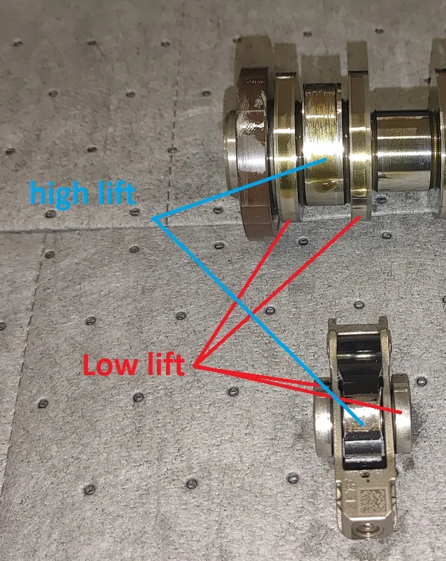

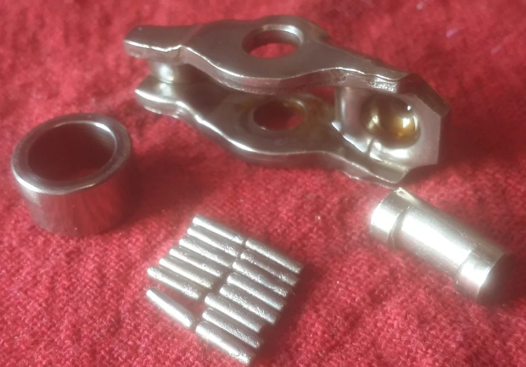

My JKU had all rocker arm lifters and camshafts replaced, does our JTs have a different problem that causes that tick?
Yes.
The JK or Gen 1, had bearing failures in the follower rollers.
Jeep Gladiator Loud ticking when engine running 2014-follower
Ours fail on a non-roller high lift portion.
Jeep Gladiator Loud ticking when engine running cam-follower

Yes.
I'm thinking ours is a better design and have fewer break downs yes? :fingerscrossed: Again, thank you @ShadowsPapa for the info!

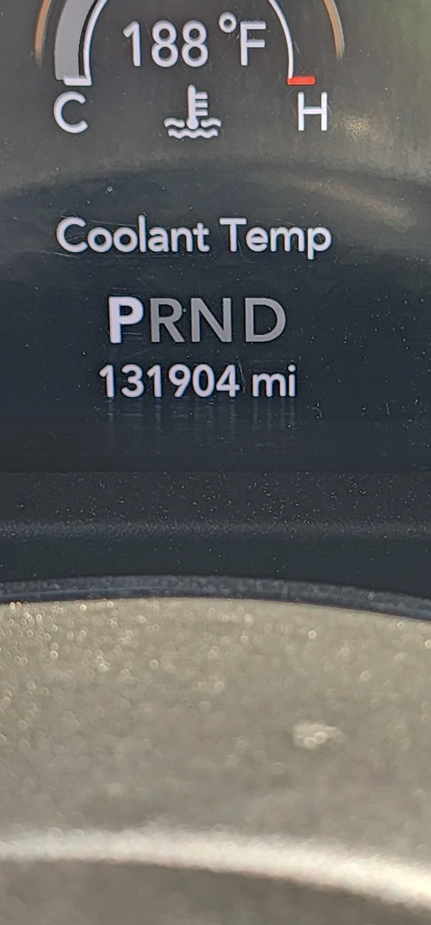

How many miles do you have on your engine? How long have you used Seafoam?
I have 131,904 been using seafoam approx every 3rd full tank for a few months then off for a month or 2 then back again been doing this for about 2 years.
