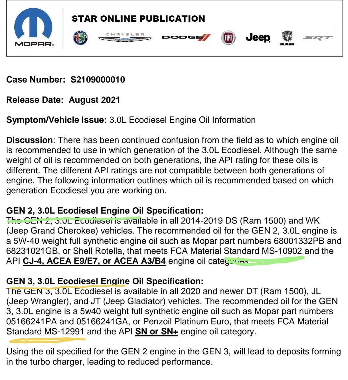

Ram/Jeep put out a STAR Publication saying, "Using the oil specified for the Gen 2 engine in the Gen 3, will lead to deposits forming in the turbo charger, leading to reduced performance."

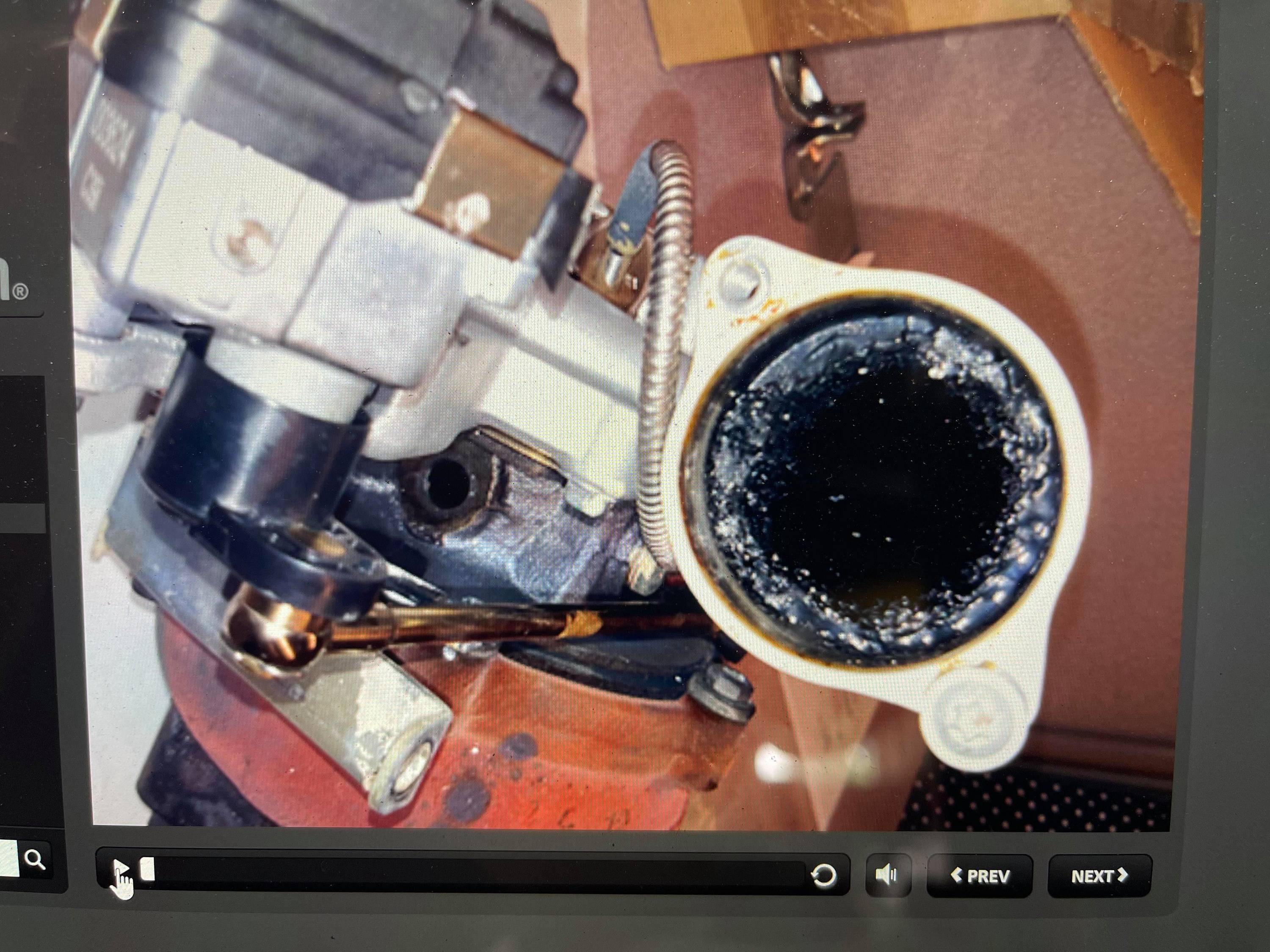

A MasterTech for Mopar also showed the following image of a turbo that was taken off one of the test mules.
I know this is a little off-topic, but once these things are gummed up like that, are there any alternatives to removing them to clean the system out?
No, there's not much you can do. It's important to run a good quality oil that meets specs. I would also be careful about extending oil changes without an oil analysis to guide those decisions.

Damn Jeep be contradicting and makes it confusing as hell. I thought they had updated the MY2022 that MS-12991 is now recommended, and that any with API SN/SN+/SP are okay to use? Did they just changed their mind again?
Nothing has changed. They still recommend the MS-12991 spec.
Unfortunately, most MS-12991 spec oils are a mid to high-SAPS.
I'd rather to replace a DPF once in awhile than to tears the engine apart to cleans internal components. So MS-12991 for me lol
Most? I haven't heard of any MS-12991 oils that aren't mid to full SAPS. Are you aware of a verified low SAPS oil with MS-12991 spec?
As far as I know, all MS-12991 oils are either a Mid or High SAPS. Some EcoDiesel owners are running a Low SAPS, but they are not MS-12991.
