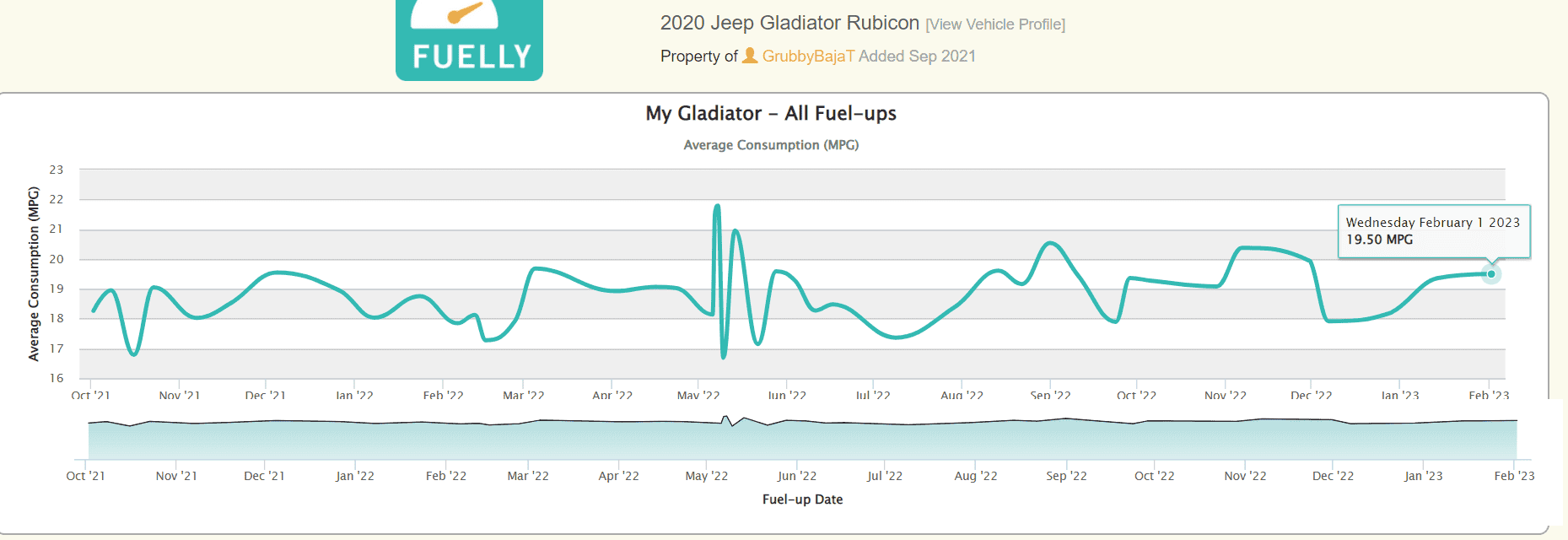

GrubbyBaja
Nov 12, 2019
219
314
Titus, AL (Wetumpka)
2020 Sting Gray JTR, 6-speed
Retired Electrical Engineer
Stock 2020 Rubi, 6-speed, w/28,000 miles. Most of my driving is 2-lane highway less than 60 mph with less than 10% city driving.
Jeep Gladiator Lower MPG than expected. Anyone else? 1676571285426
Jeep Gladiator Lower MPG than expected. Anyone else? 1676571358926
