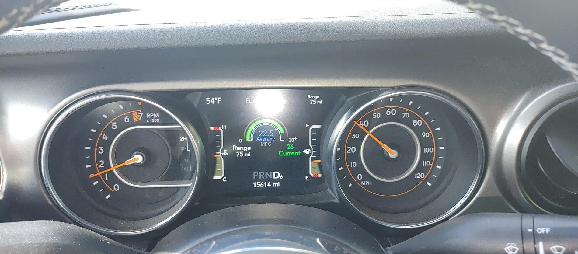

Might be tipping a few back, but I was pretty stoked today, driving to lunch. I was at 13.6 on EVO11. 600 miles on on EVO2X
Nice. Does it report accurately with the injector change?
