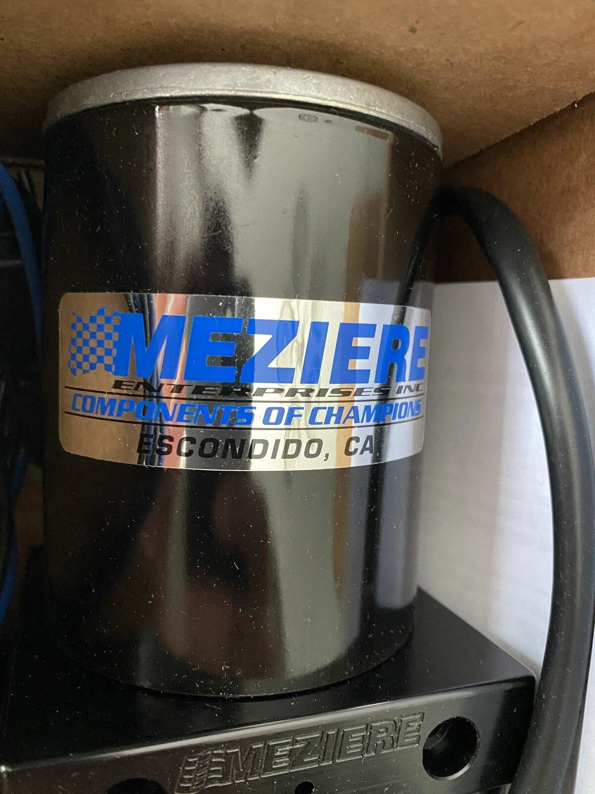

Mmmmmmm.... 22gpm....
Jeep Gladiator Magnuson TVS1900 Kit Available Now F6DA007D-6940-4E74-8286-CEE44597E3EB

i wants aaaaalllllllllll the cooling.
Man your timing will be right on. I just about have this tune figured out and you will have all the goodies. Be a sweet running truck out the box.
