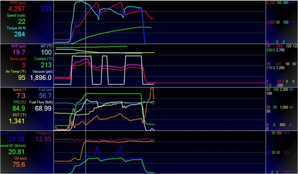

@DAVESC1 can you look at this and make any sense for me? I know some of the numbers are inaccurate due to the way they are calculated but I do not believe I am making the power I should be and not just off the hp or tq numbers shown, which are probably false, but also the pressure and vacuum numbers? Let me know what you guys think, this was a 0-60 mph run with wot
Jeep Gladiator Magnuson TVS1900 Kit Available Now 0-60
