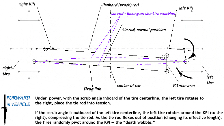

Suspension engineer Bob Sheaves wrote:
"Death wobble" first showed up in vehicles in the 1960s with early aftermarket lift kits, primarily on Jeep CJs and Land Rover S1s. The steering linkage was a single rod from the pitman arm down to the tie rod, attached at both ends with a ball joint (tierod end) called the draglink; and a single rod from the left to right knuckle that was the tie rod.
Jeep Gladiator Major stability issue at highway speeds death-wobble
And this is going to piss off some of the hard-core guys:
This is why I keep harping on SCRUB RADIUS (Scrub Angle) and if you have TALLER tires, wider wheels, or if you decide you like the looks of big tires sticking out - you are literally asking for death wobble. May not happen but the suspension is designed specific ways by engineers - making such changes negates the engineering.
You totally change the ANGLES of the the linkage - suddenly things aren't being compressed, they are being "bent" or "bowed" due to the downward angle. They flex. They'll resist end-to-end compression but can't resist bowing or flexing. The bigger the lift and the bigger the tires, the more prone to death wobble.
The stuff above is from engineers and experts - not the arm-chair type from all over fakebook and other places.
So taller tires, wider wheels, setting the center of the tire outward - doing any or all of that without doing the math............

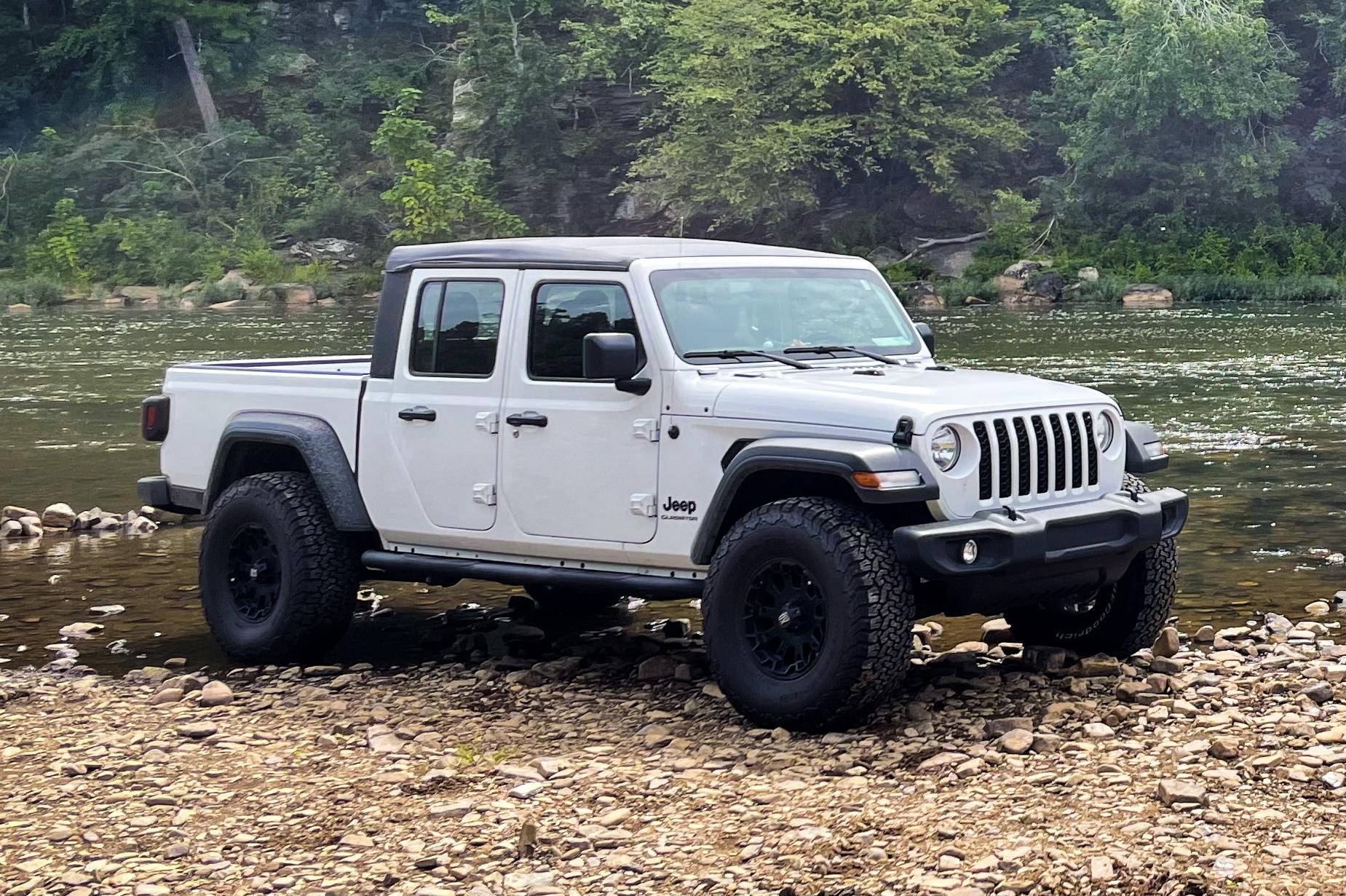

Jeep Gladiator Major stability issue at highway speeds 9988D637-CA8D-4EBB-80A9-126C7FFBD123
Here is a picture of my truck since I’m so hyped that it can be driven again
