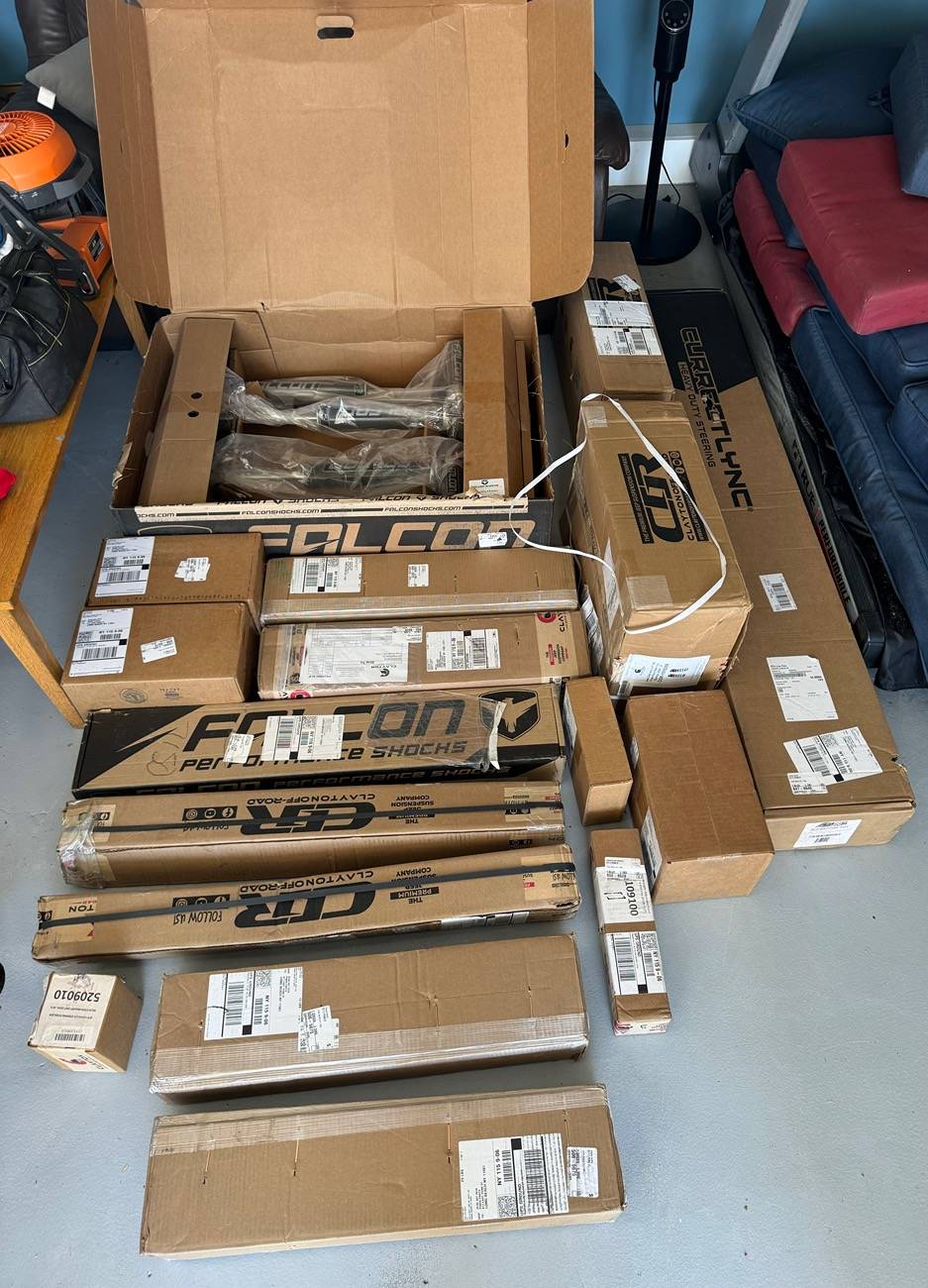

THE WEIRD THING IS, THE STEERING WHEEL DOESN'T SHAKE, THE BODY JUST ROLLS/SWAYS MORE AND MORE AGGRESIVELY. LEFT TO RIGHT. I GUESS UPGRADES ARE NEEDED BUT STOCK SUSPENSION SHOULD BE ABLE TO HOLD UP WITH THIS WEIGHT FOR MORE THEN 3,000 MILES.

I PURCHASED FALCON 3.3S ALREADY, WAITING ON THE CLAYTON LIFT KIT TO COME IN NOW. I WANTED TO FIX THE SWAY ISSUE BEFORE INSTALLING AFTERMARKET PARTS BUT NOW I'M NOT USRE IF THATS POSSIBLE.
It’s not. You’ll resolve the issue by getting rid of those springs and shocks. They can’t handle that weight.

I RECENTLY ADDED A BED CAMPER TO MY OVERLAND BUILD AND HAVEN'T EXPERIENCED ANY ISSUES DRIVING UNTIL ABOUT 2 MONTHS LATER. THE JEEP STARTS TO SWAY/ROCK LEFT TO RIGHT ONCE I REACH SPEEDS OF 55+ MPH, IF I CONTINUE AT THAT SPEED THE SWAY/ROCKING GETS SO BAD THAT THE FRONT LEFT/RIGHT TIRE WILL HIT/RUB ON THE FENDER. I UNDERSTAND THE WEIGHT MAY BE AN ISSUE BUT THE PROBLEM SEEMS TO BE GETTING GRADUATLY WORSE AND WORSE. HAS ANYONE EXPERIENCED THE SAME ISSUE? IS THERE SPECFIC PARTS I SHOULD CHECK?
*STOCK SUSPENSION*
*35 INCH K02 TIRES ON 17 INCH FUEL COVERT WHEELS*
*WEIGHT IN BED WITH DRAWERS/CAMPER AROUND 600-800LBS*
I believe the Clayton kit will solve your problem as other kits designed for Overlanding are all designed to handle the weight your carrying and the stock suspension isn't. You may notice a slightly stiffer ride when you're rolling empty however.
