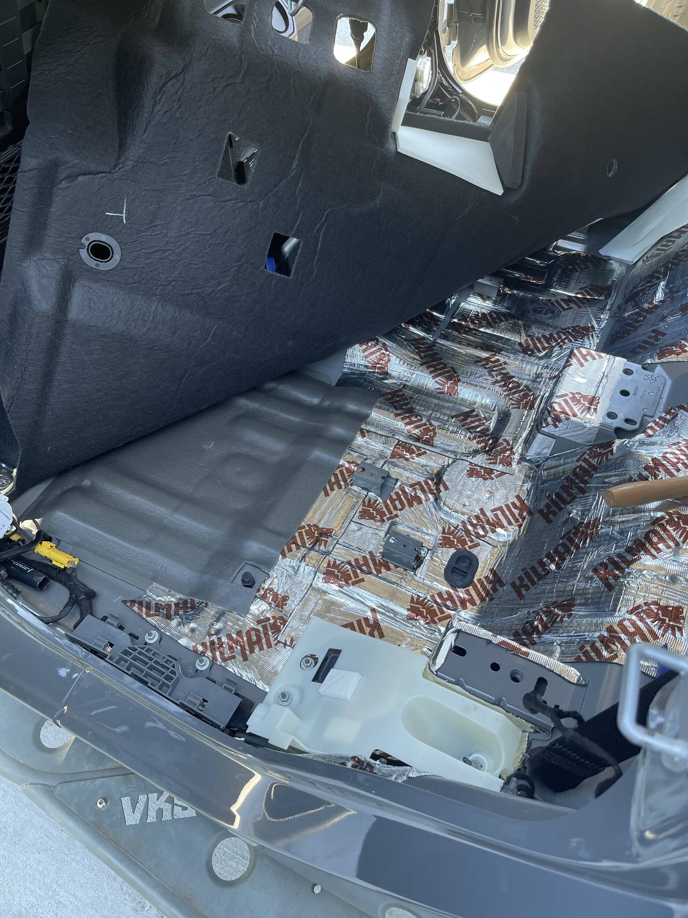

My goal was to reduce the resonance on as many of the flat sheets as possible without trying to get every single piece covered. I tapped around on the door to find anything that sounded ‘tinny’. I also put some on the inner liner plastic in a couple of the large flat areas. On the passenger side I also added a couple pieces to the inside of the outer shell. I concentrated on the large flat unobstructed areas.
The net result so far is a significant reduction in the hollow drum-like resonance. Tapping the outside of the door made a real change to the sound transmission and changed the tone. Now to do the front doors …
I worked in phases floors then doors… I noticed a huge difference with the door skins and as many videos that claimed this was easy… I found the removal to be kind of a pita…. Worth it though ??? next big one is the rear portion of the hard top.

Started on the front doors today. Found MOPAR already put a sound deadener on the upper half of the skin above the brace.
Jeep Gladiator Making a quieter truck, where to start? IMG_9299
I tried to find a part number but could only locate a production date. I decided to go ahead and apply another layer there and do the rest of the door.
Jeep Gladiator Making a quieter truck, where to start? IMG_9311
Then I used the scraps for the inner and outer skins.
Jeep Gladiator Making a quieter truck, where to start? IMG_9313
Jeep Gladiator Making a quieter truck, where to start? IMG_9314

All doors now done. Next is the rear wall and floor like @caryt did, though I’m probably not going to be as good as he did.
The rigid material that was already in the front door is interesting because it appears to be some kind of fiberglass composite. Very rigid. The monkeys who put it in left several lumps in it rather than making it completely flat. Went over it again with the Siless anyway since I was there and have the materials.
