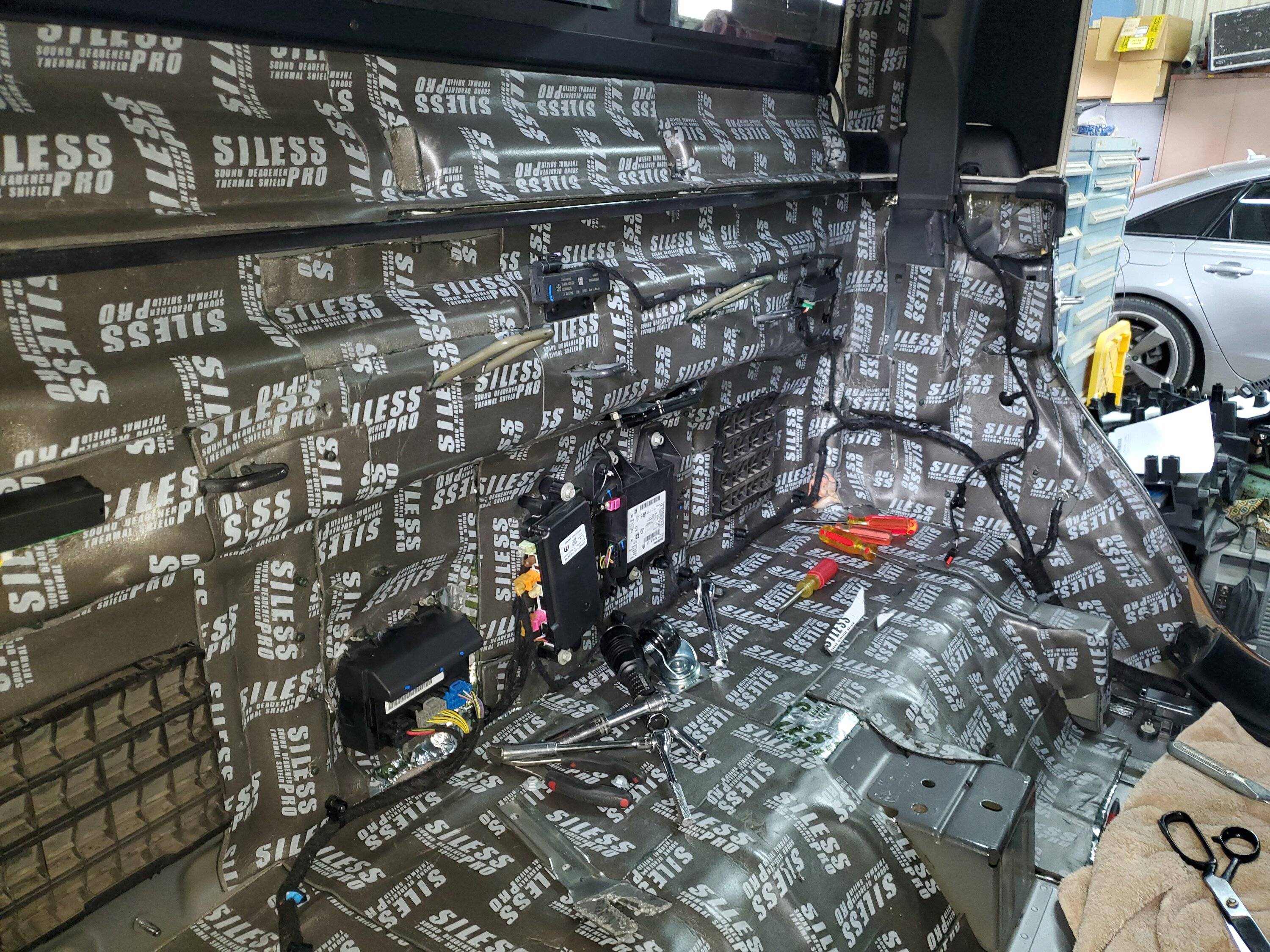

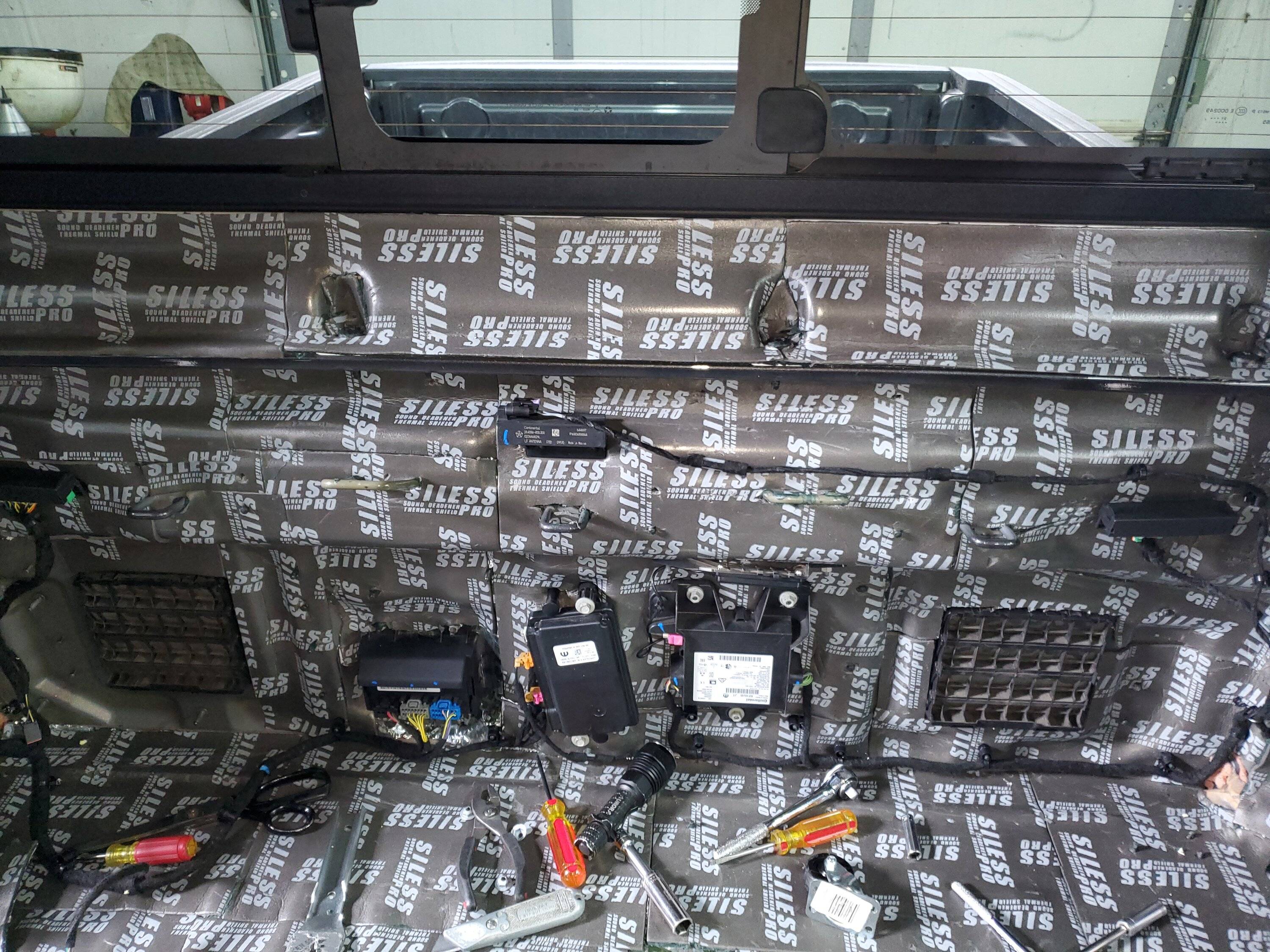

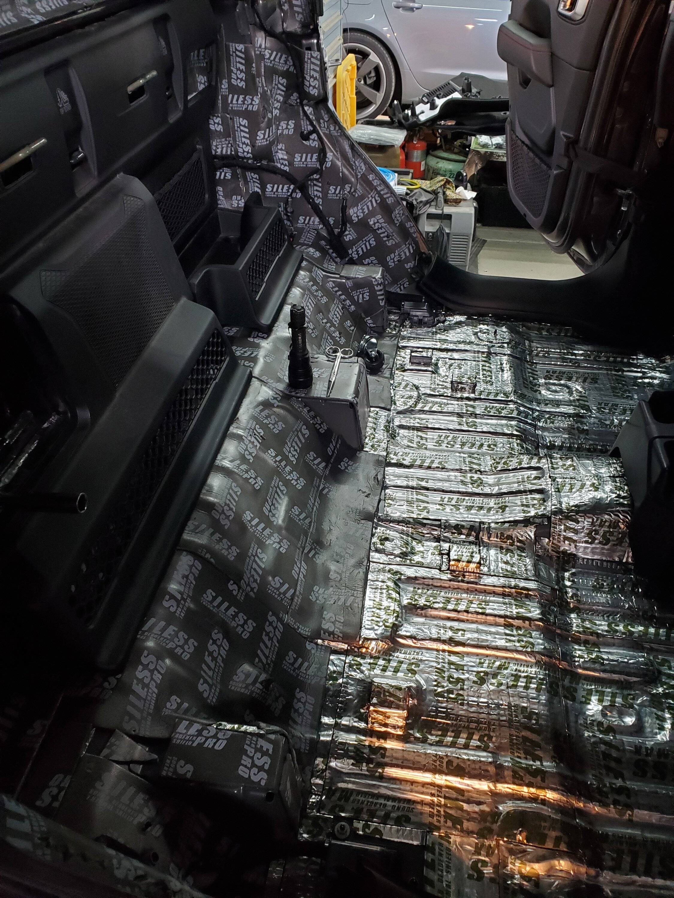

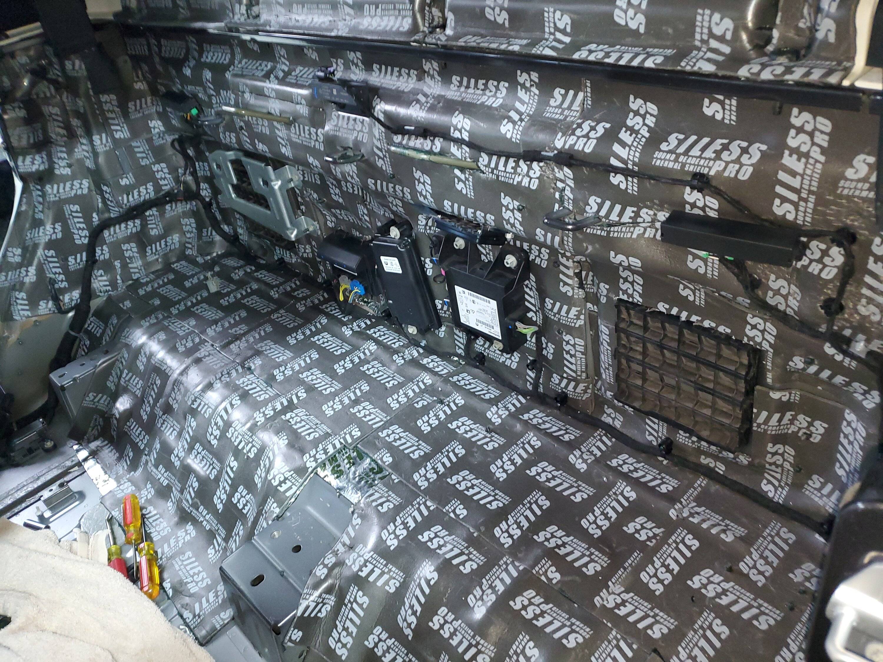

I did the rear so far then got a used 100% Goose Gear rear delete ..seems to helped some.
One layer of each then carpet went back on 100% coverage. Thinking once I figure out how to retain the 8.4" radio and remove the amp I'll remove the back panel and sub completely and install a JL Audio HD900/5 Amp, and 10" Subwoofer and Box that I have.
At that time I'll do the front half. Top need something better than the Hot Heads..not worth the $ IMO so will address that also. May go 1/2" closed cell neoprene.

Dang dude! You went all out! Whats the difference between the silver and the black?

Wow, did that quiet your Jeep down much?

Some what..I didn't take a spl reading or a frequency reading I will for the front. It is better I can hear my wife and have the radio on at 60 but 70 up..wind noise gets worse...its a jeep.
Info on the product https://siless.myshopify.com/

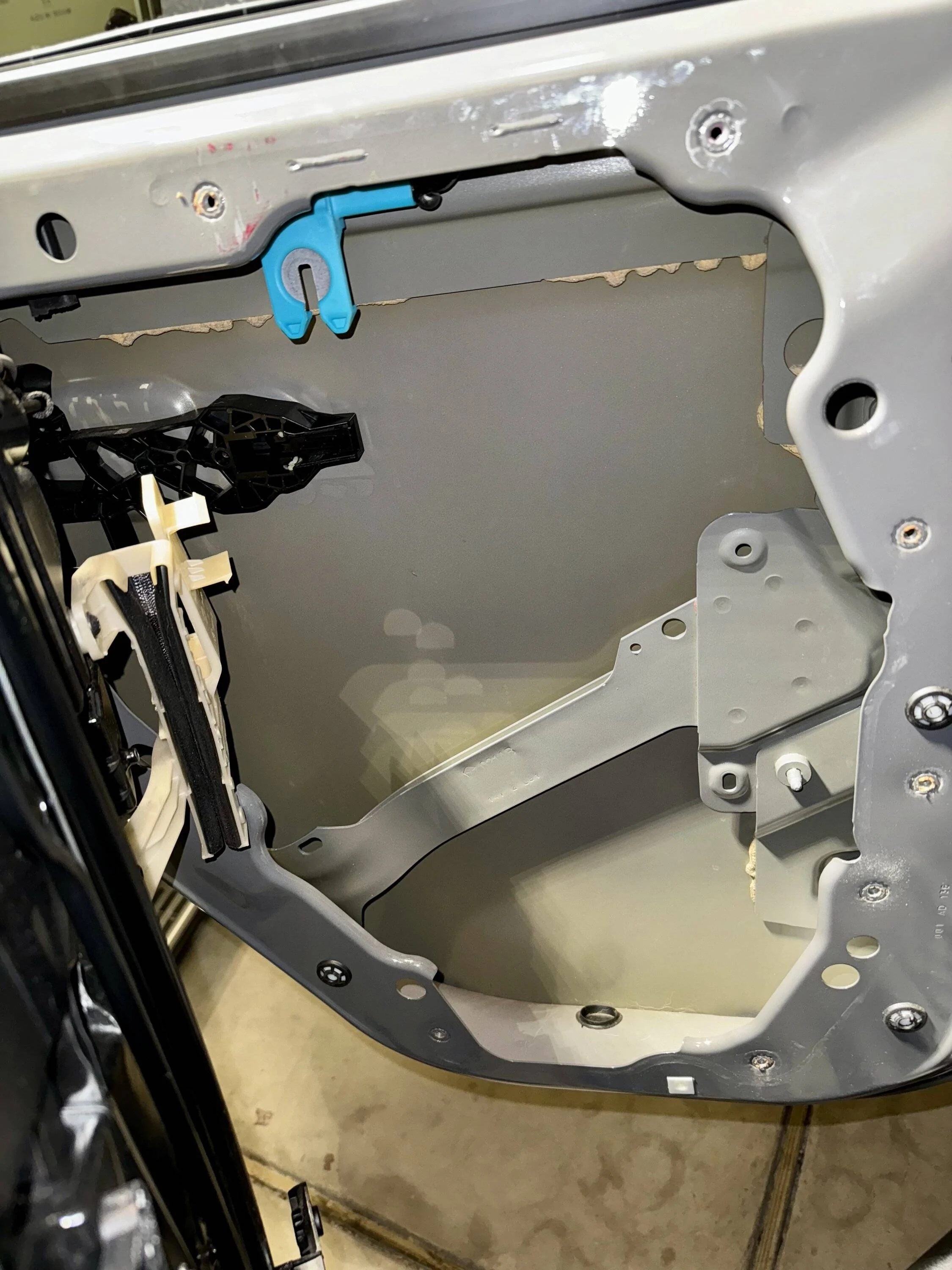

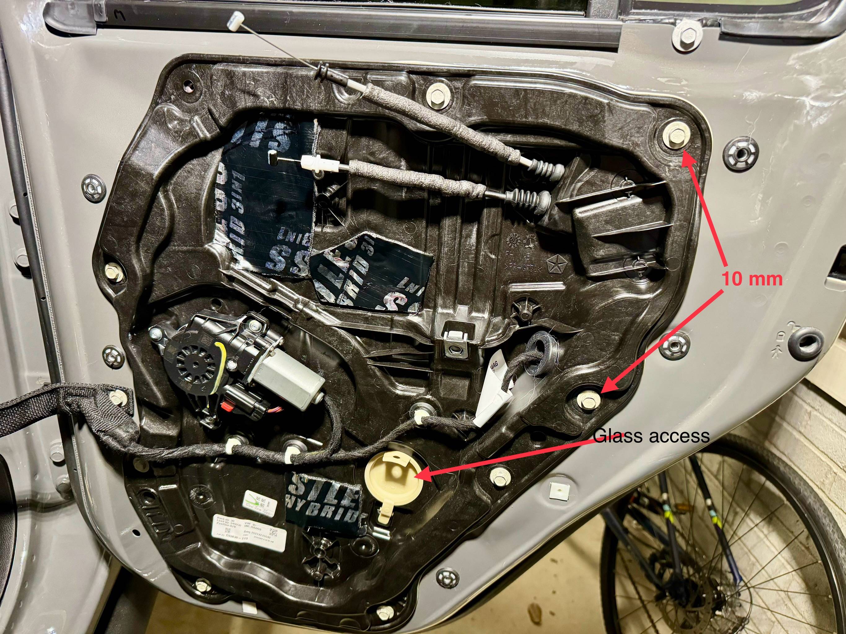

This is the passenger side rear door inner skin.
Jeep Gladiator Making a quieter truck, where to start? IMG_9284

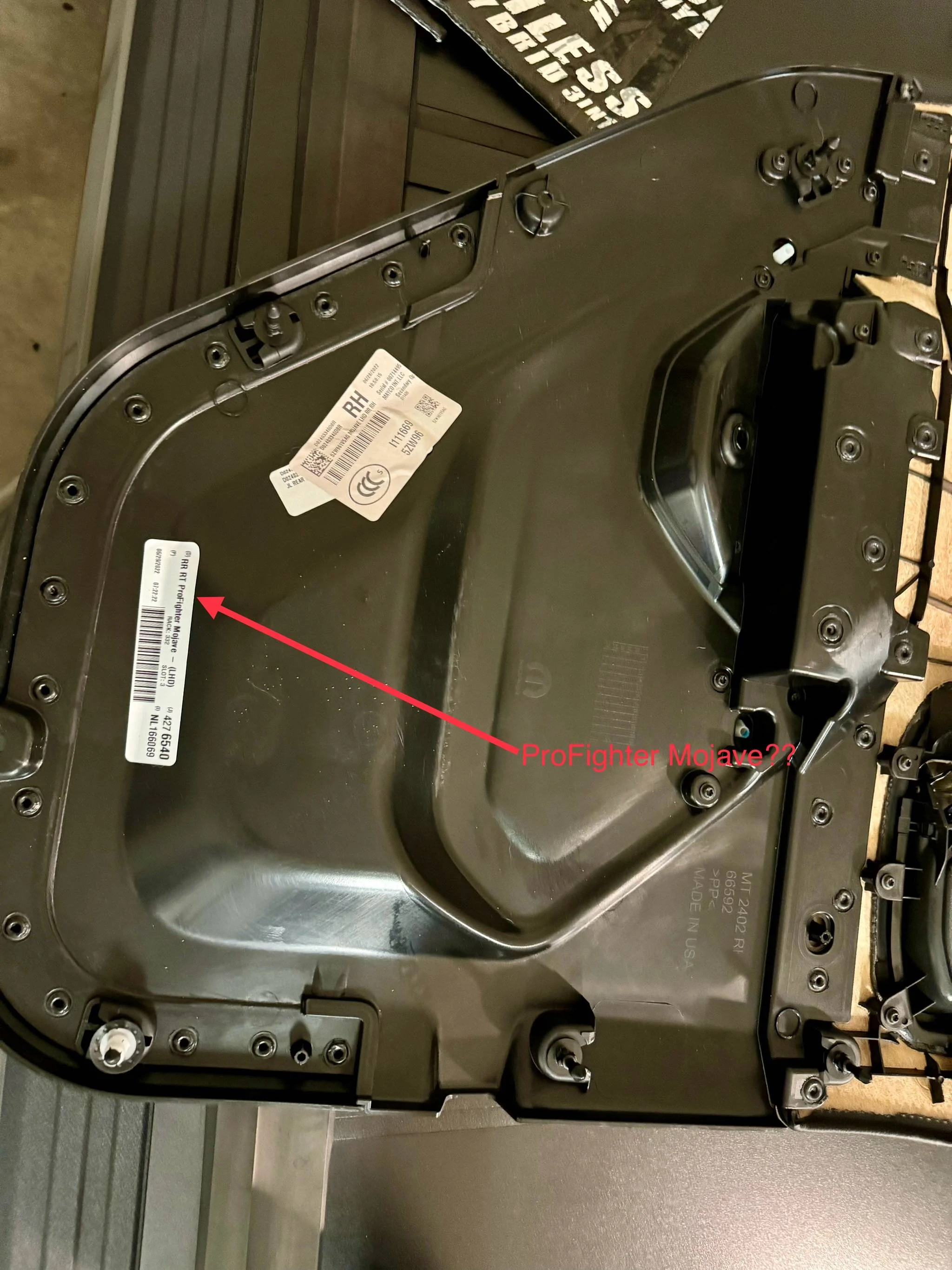

What is the “ProFighter Mojave”?
Jeep Gladiator Making a quieter truck, where to start? IMG_9287

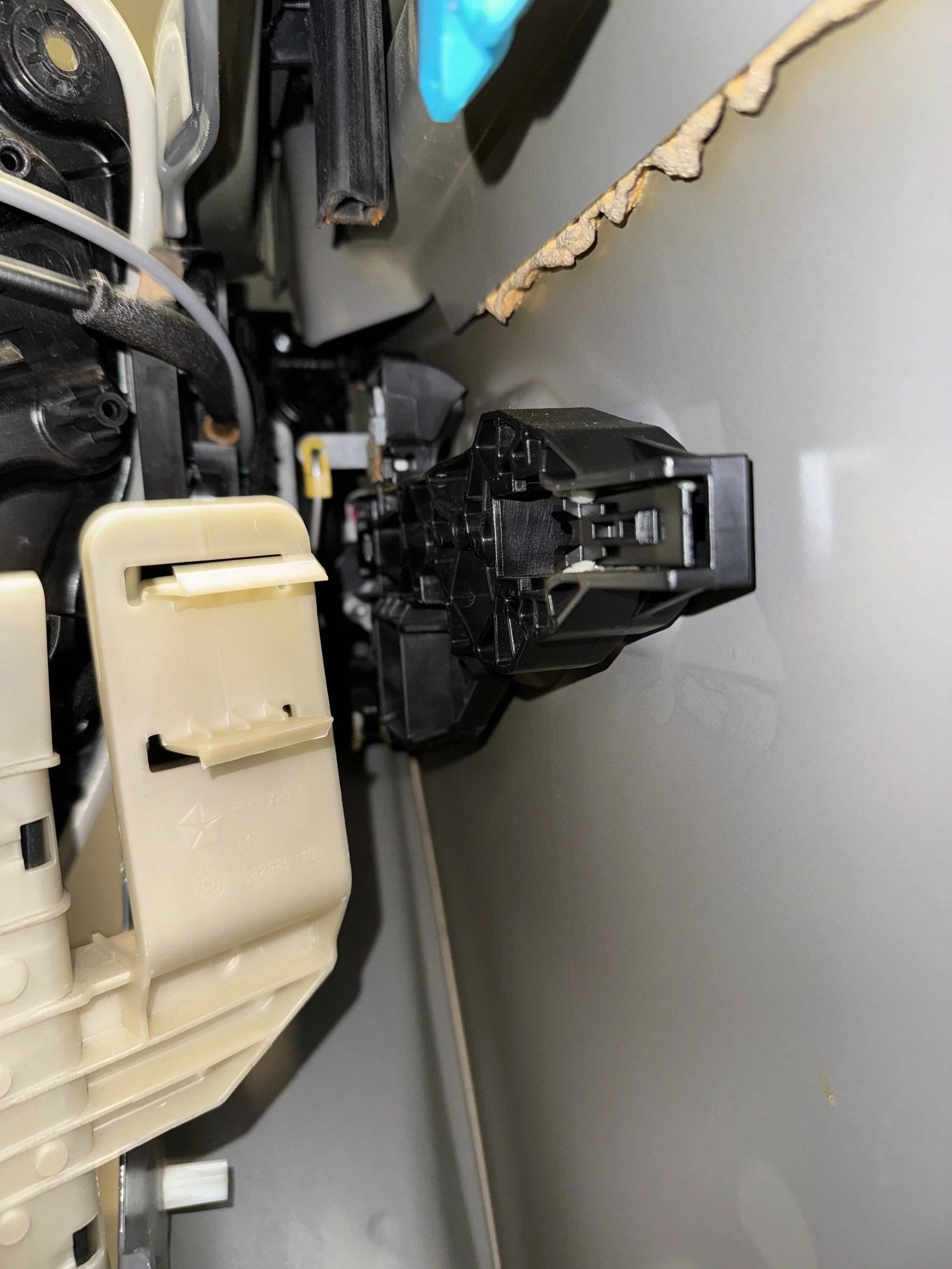

This is the driver’s side rear door inner skin. Kind of a pain to maneuver out to this point.
Jeep Gladiator Making a quieter truck, where to start? IMG_9238

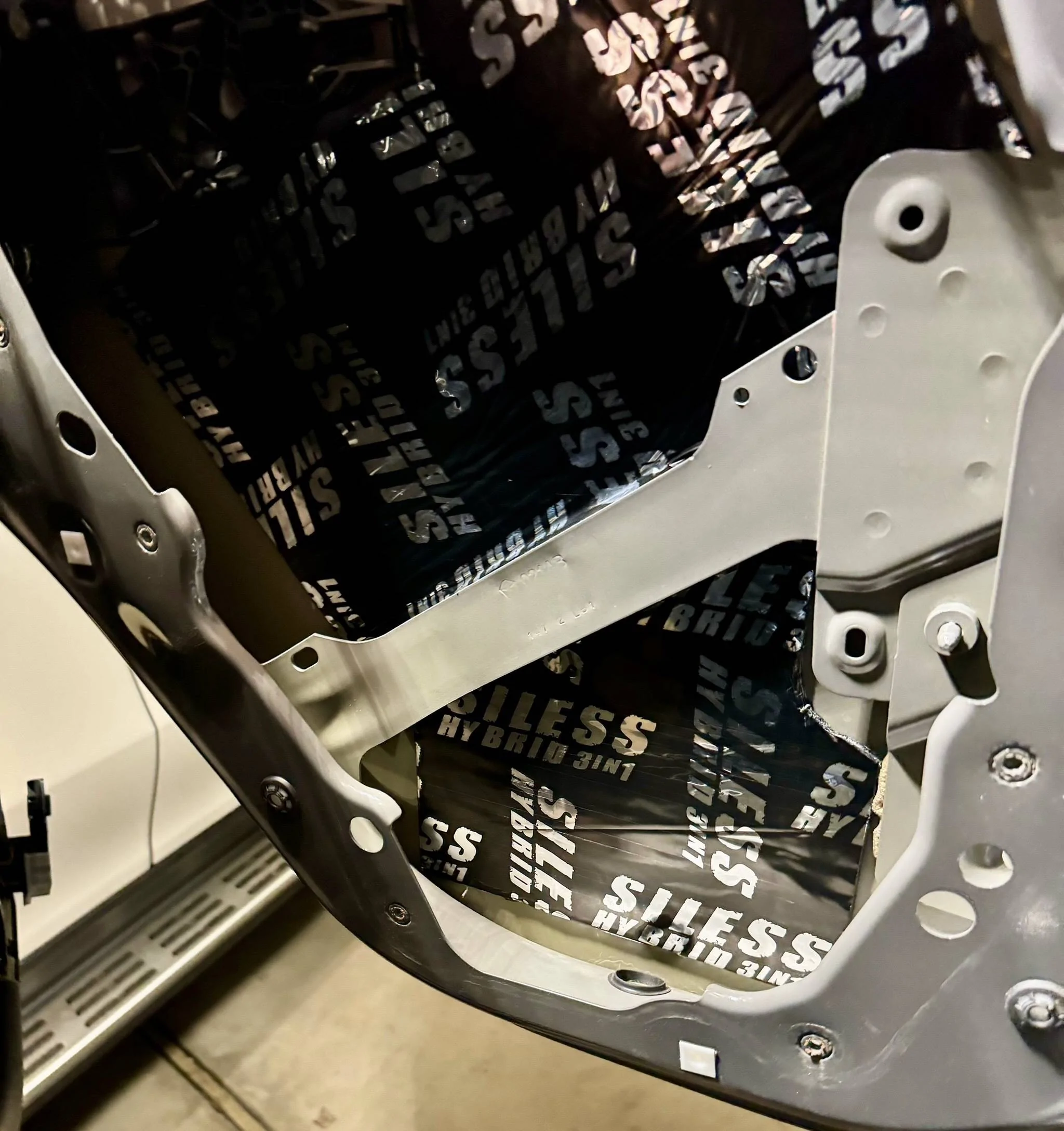

This is the inside of the door. Lots of bare flat open sheetmetal to act like a drum. The blue thing is a part of the window lift. The diagonal is merely a brace and does not move. It is glued to the outer skin.

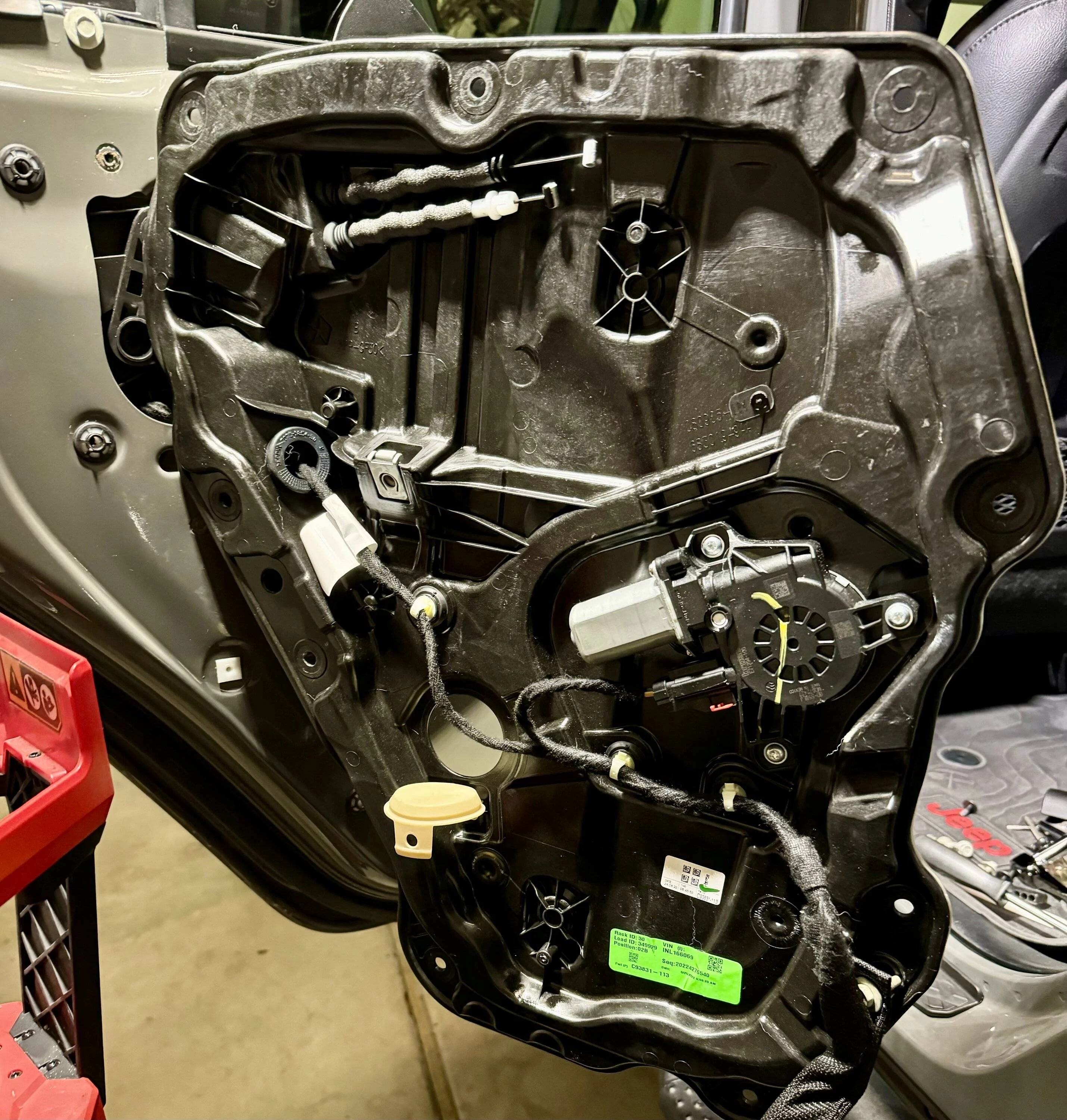

The bone color plastic is a guide for the window. It is held in with two torx screws. Removing it helped to get the inner liner out of the way and helped access to the inside of the door.

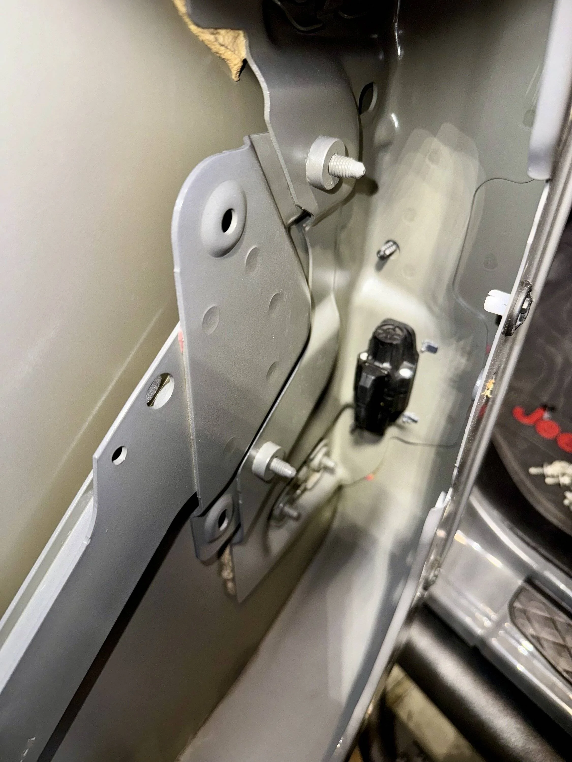

My goal was to reduce the resonance on as many of the flat sheets as possible without trying to get every single piece covered. I tapped around on the door to find anything that sounded ‘tinny’. I also put some on the inner liner plastic in a couple of the large flat areas. On the passenger side I also added a couple pieces to the inside of the outer shell. I concentrated on the large flat unobstructed areas.
The net result so far is a significant reduction in the hollow drum-like resonance. Tapping the outside of the door made a real change to the sound transmission and changed the tone. Now to do the front doors …
