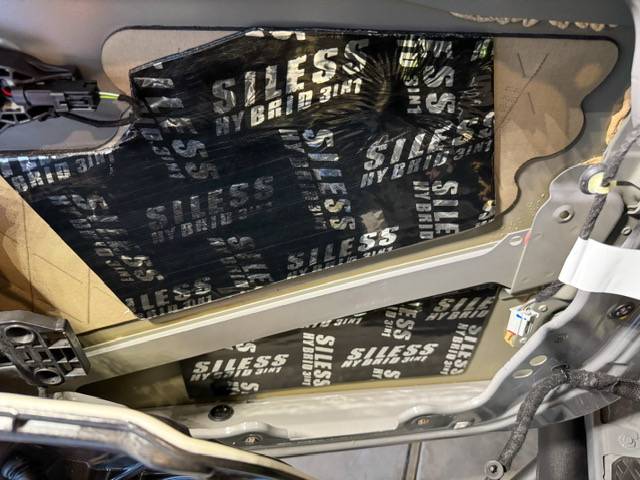

I worked in phases floors then doors… I noticed a huge difference with the door skins and as many videos that claimed this was easy… I found the removal to be kind of a pita…. Worth it though ??? next big one is the rear portion of the hard top.![]()

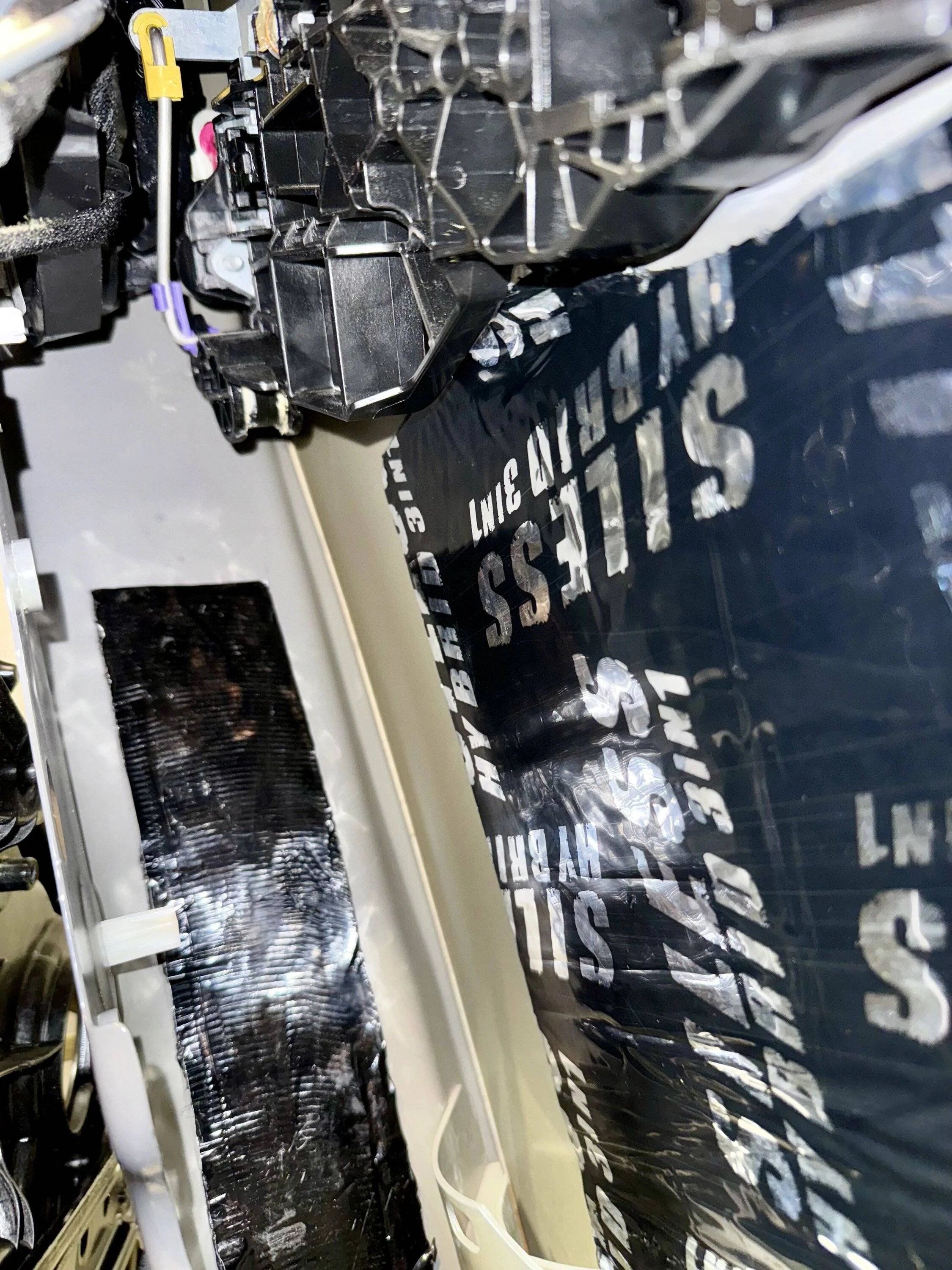

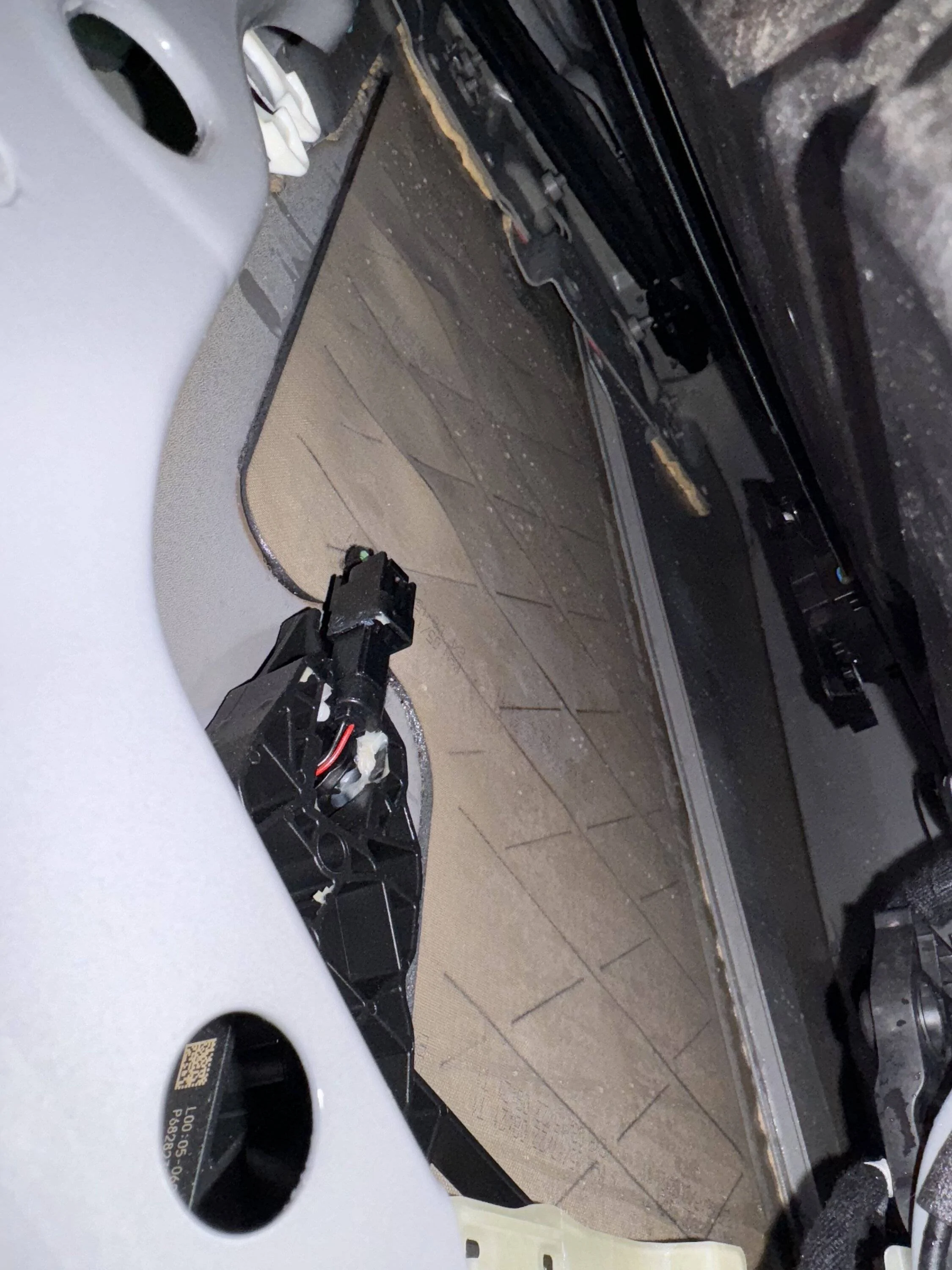

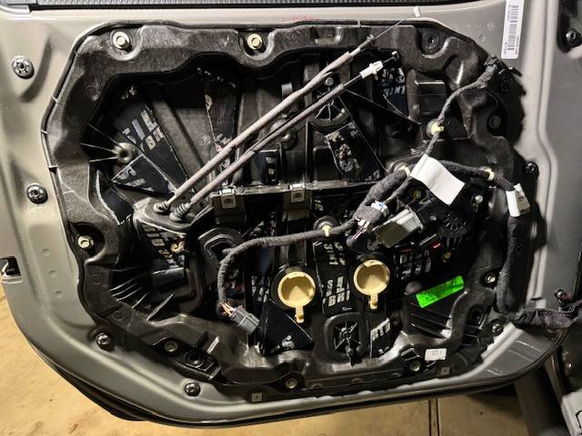

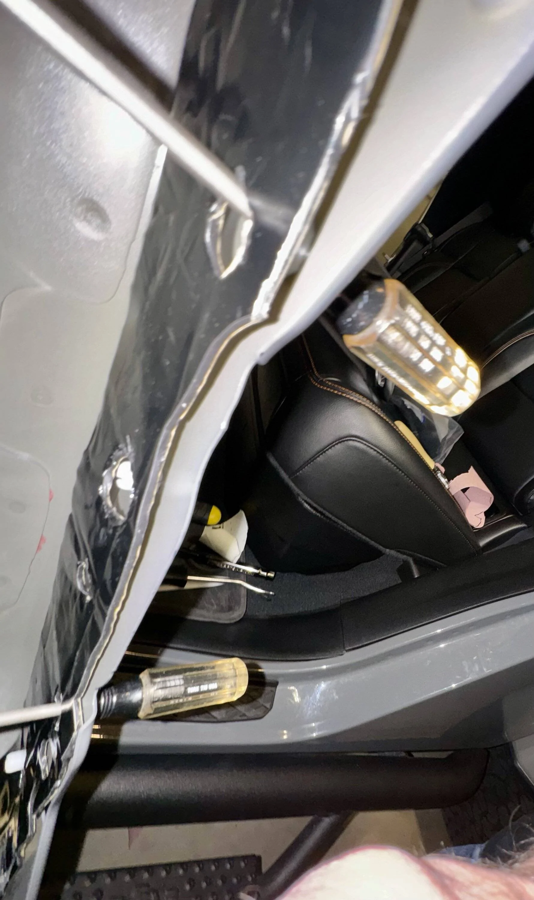

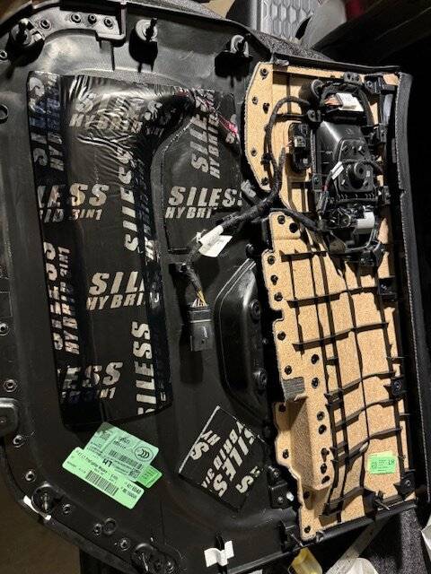

My goal was to reduce the resonance on as many of the flat sheets as possible without trying to get every single piece covered. I tapped around on the door to find anything that sounded ‘tinny’. I also put some on the inner liner plastic in a couple of the large flat areas. On the passenger side I also added a couple pieces to the inside of the outer shell. I concentrated on the large flat unobstructed areas.
The net result so far is a significant reduction in the hollow drum-like resonance. Tapping the outside of the door made a real change to the sound transmission and changed the tone. Now to do the front doors …
My tester sits in the passenger seat and she seems impressed with the improvement. That’s as scientific and measurable as I’m going to get.
