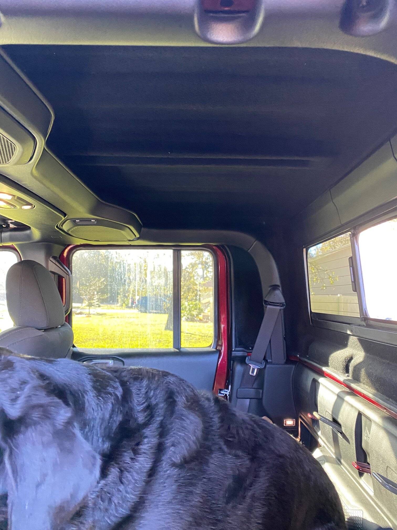

I installed the full Topliner from Cover King... LOVE it. Wasn't a terrible install, you take your top off, upside down on a blanket, clean it, stick the adhesive, then install the mat... it's basically a heat molded carpet. I almost put in some Killmat underneath it, but I was low on time... I don't think it was necessary, the liner covers 100% of the white fiberglass inside, and man, it WORKS! Not sure on the temp changes, but it really cuts down the noise. I love it, AND love the look too...

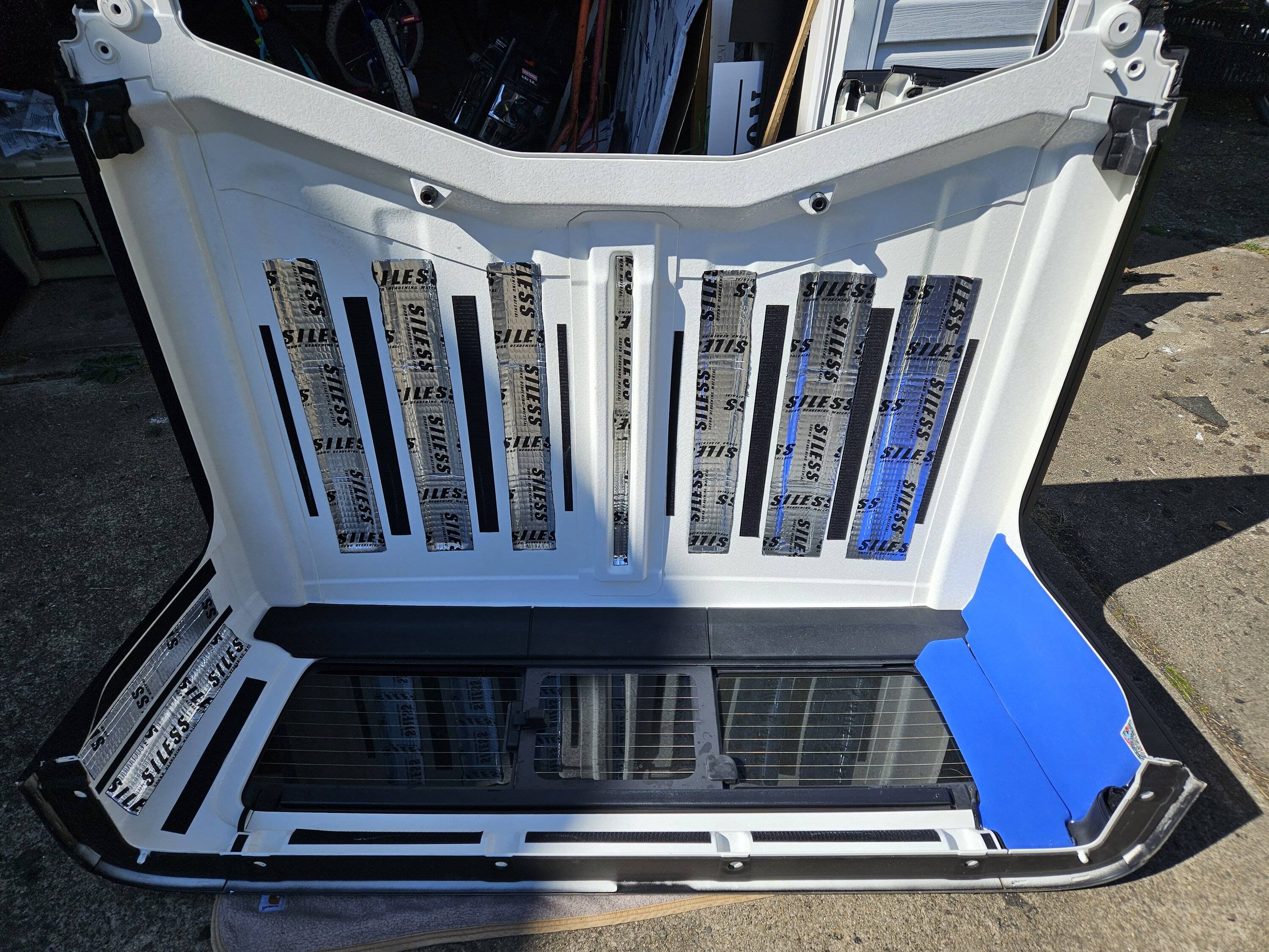

interesting vid from Hothead. This kit doesn't completely cover the roof, just did strips. Seems a little under done?

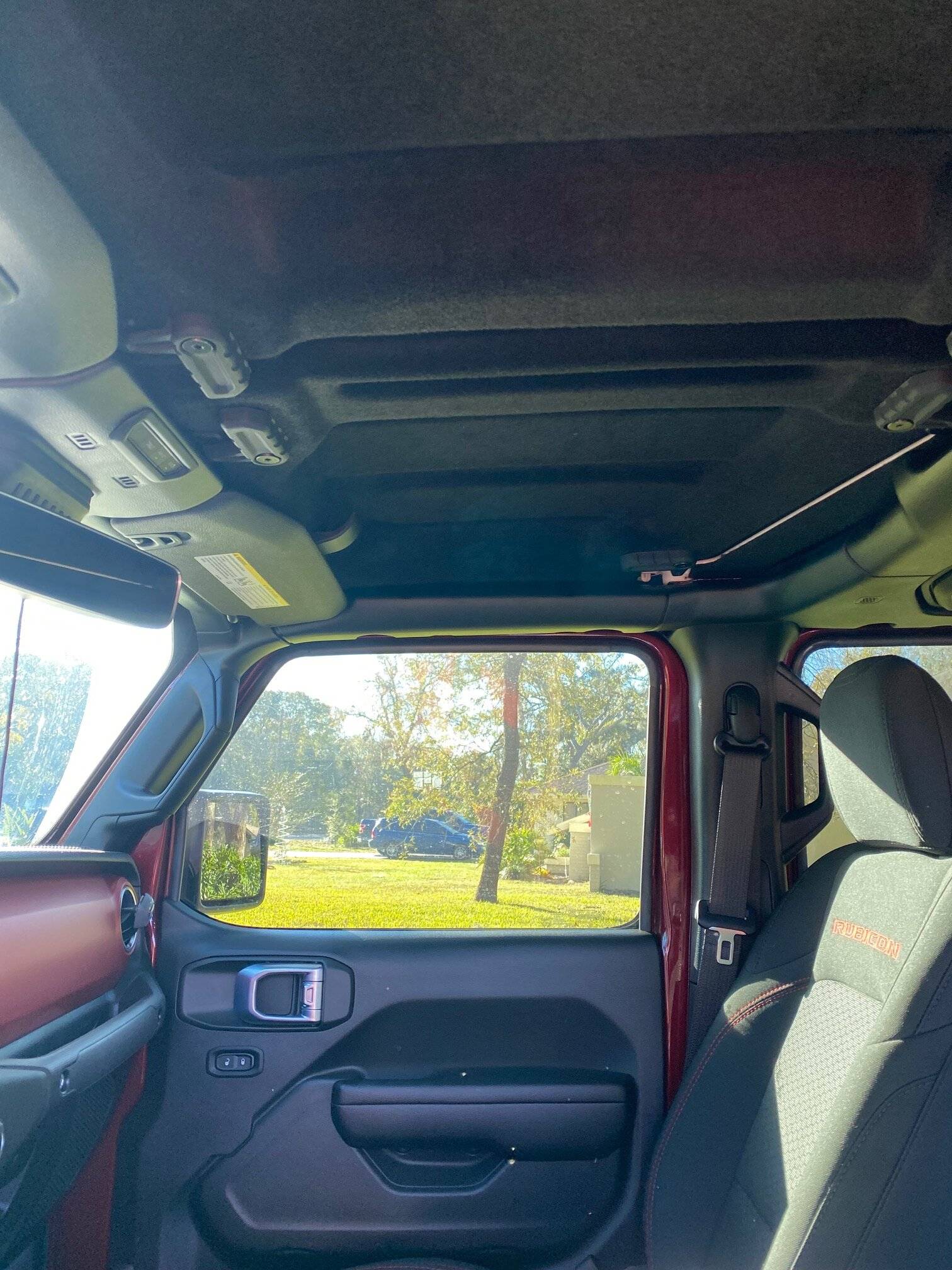

Agreed. Posted a while back the difference Coverking made when paired with sound deadening on the fiberglass cap. Looks incredible as well..

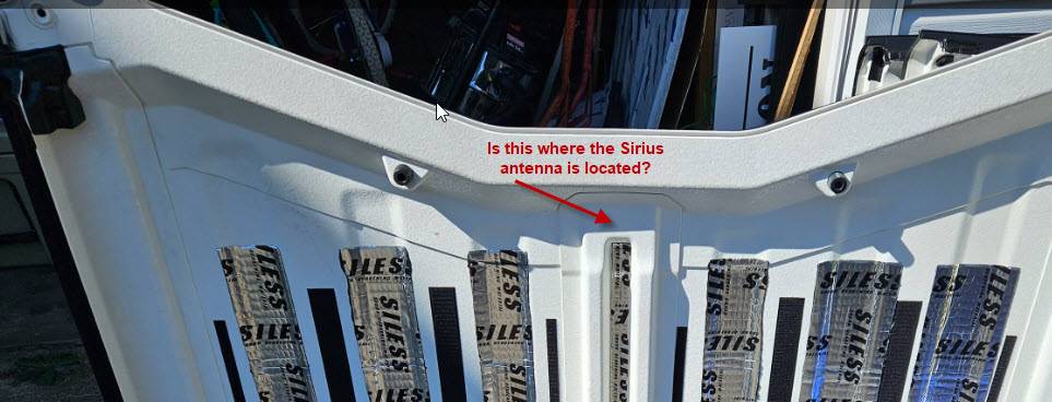

The one caution I would tell you is, if you plan on using the satellite radio, know where your antenna is and don’t you sound deadening over it. It will block the signal periodically and you will not be happy.. Other than that…amazing.

Agreed on the cover king, I installed on mine with sound deadening. I really did not like the white fiberglass look and now it looks a lot nicer.

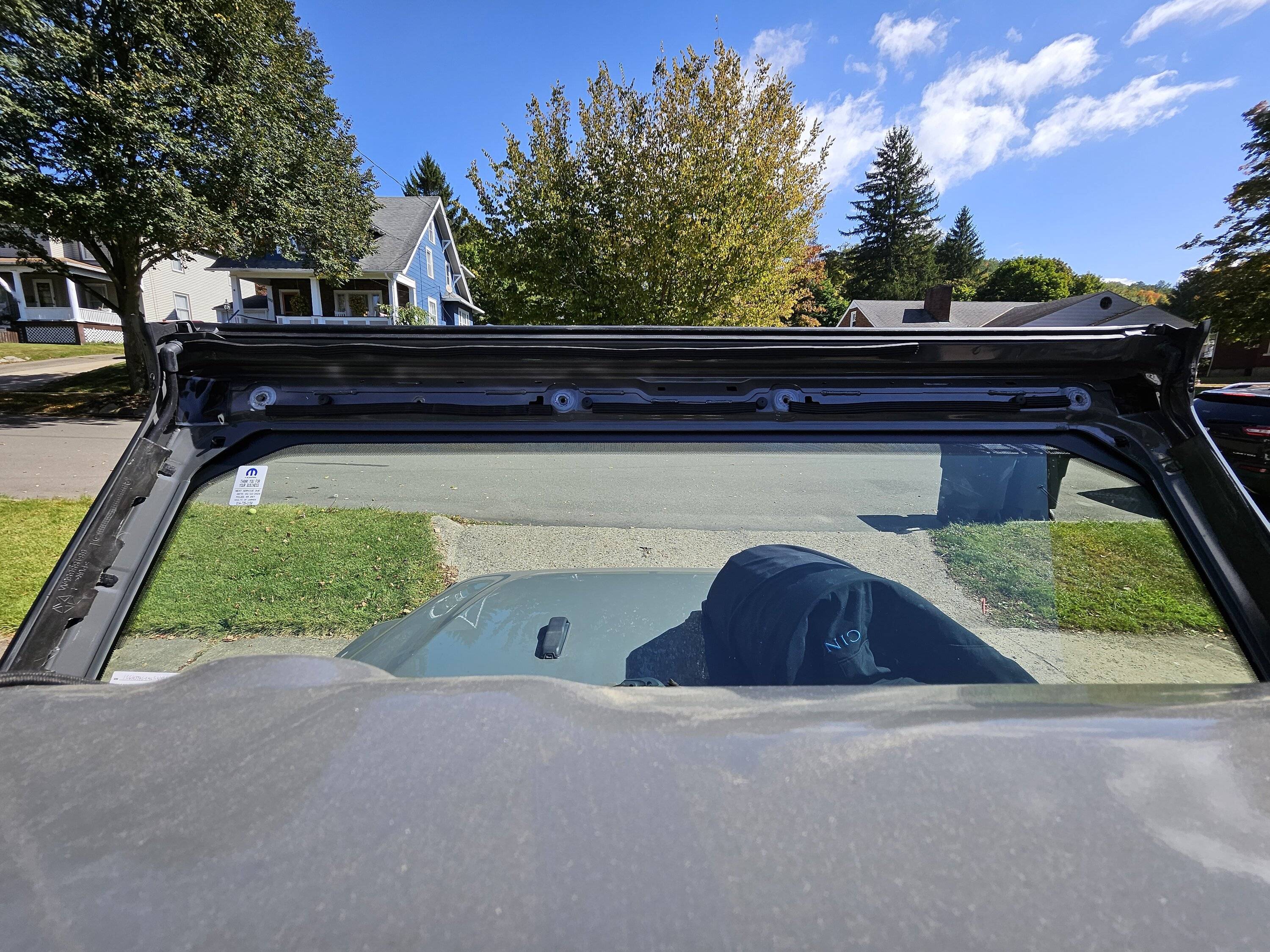

Finished up the roof and windshield
Jeep Gladiator Making a quieter truck, where to start? 20231001_122255
Jeep Gladiator Making a quieter truck, where to start? 20231001_124402
It's WAY quieter than before. Even got positive comments from the skeptic. I've got a full sheet of it left so I may go up the fire wall some more.

Using Alpine's pic. Is this where the satellite antenna is located? I know they say not to cover it with the sound deadender.
