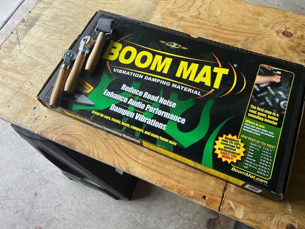

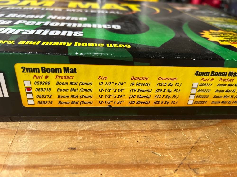

EDIT: I didn't catch the "whole interior" piece of your question. This was just for every bit of white fiberglass...
Here's what I used: 2 boxes with no full sheets remaining (but a lot of remnants)
https://www.amazon.com/Design-Engineering-050210-Material-Adhesive/dp/B0039Z3SL6/ref=sr_1_3?crid=30ZY3N1HZEV03&keywords=boom+mat&qid=1695226711&s=automotive&sprefix=boom+mat,automotive,147&sr=1-3
Jeep Gladiator Making a quieter truck, where to start? BoomMat2
Don't forget the rollers...they are worth it.
https://www.amazon.com/gp/product/B08QRS49ZZ/ref=ppx_yo_dt_b_asin_title_o09_s00?ie=UTF8&psc=1
Jeep Gladiator Making a quieter truck, where to start? BoomMat1

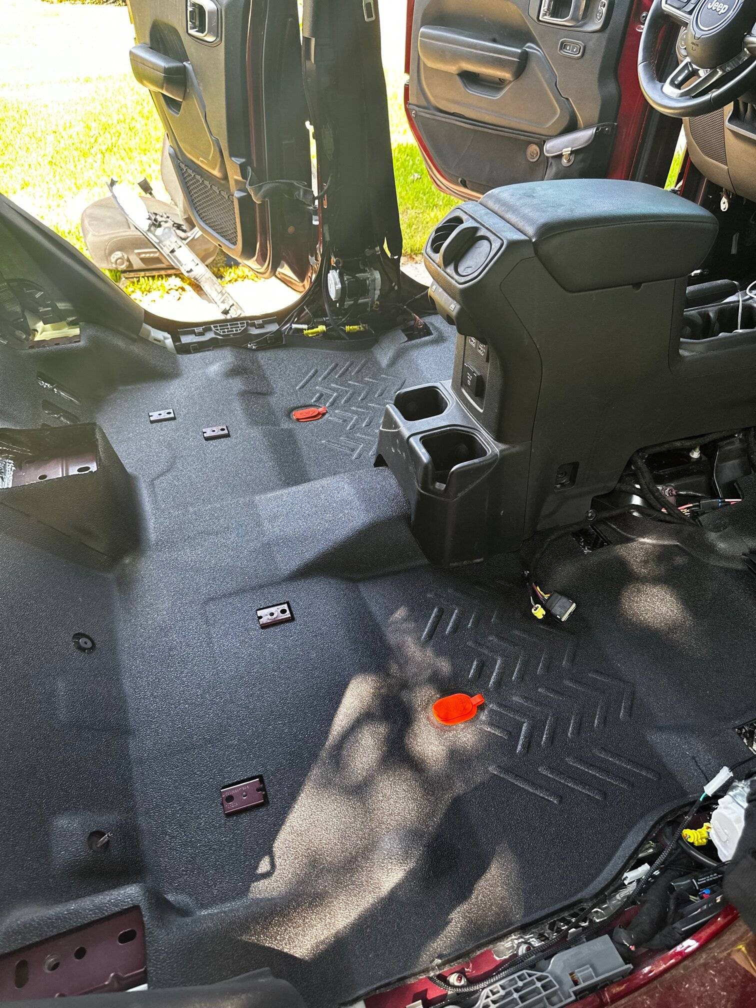

Material wise it took 2 boxes of 80mi 36sqft Killmat. $100 on Amazon. Photo shows Killmat with 4mm siliss liner over parts of the Killmat…. Pretty sure the Killmat did 90% of the deadening…
My first post on page one ???
I was looking at that and wasn't sure if you did all four doors along with the floor and roof

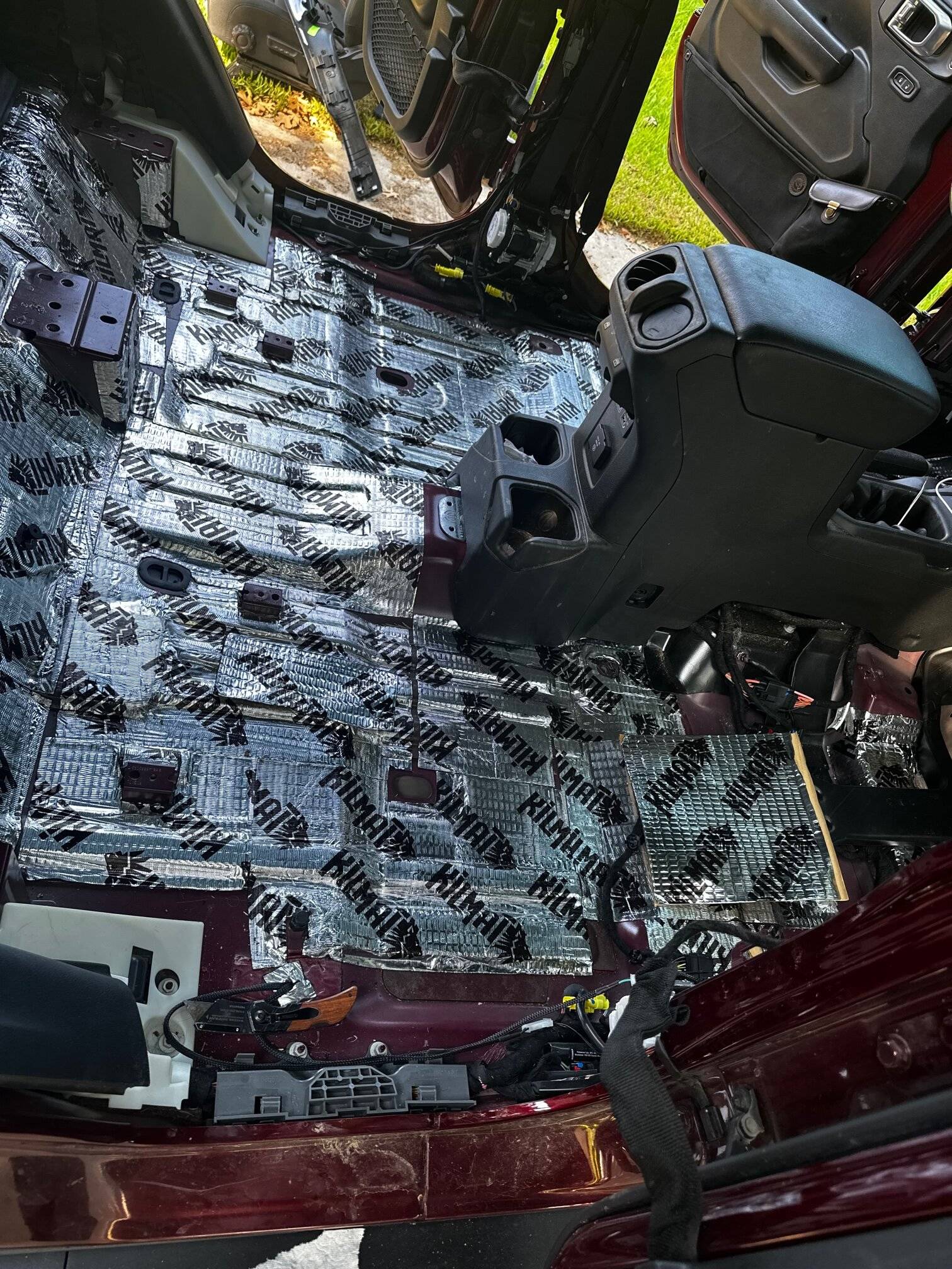

I used 50 sqft doing the roof and entire floor. I did not have any left over. I also installed cover king on the roof, which also helped. Later I replaced the factory carpet, after It got ruined, with armorlite and that help even more with the road hum.
But quiet is relative and I'm still driving a brick down the road with big tires.
Jeep Gladiator Making a quieter truck, where to start? 71475616077__99F4D342-F3E2-44ED-8699-B580ECFAFB2F
Jeep Gladiator Making a quieter truck, where to start? 71476007305__8471C59E-4BE5-4BC4-A7F1-087540AA498F

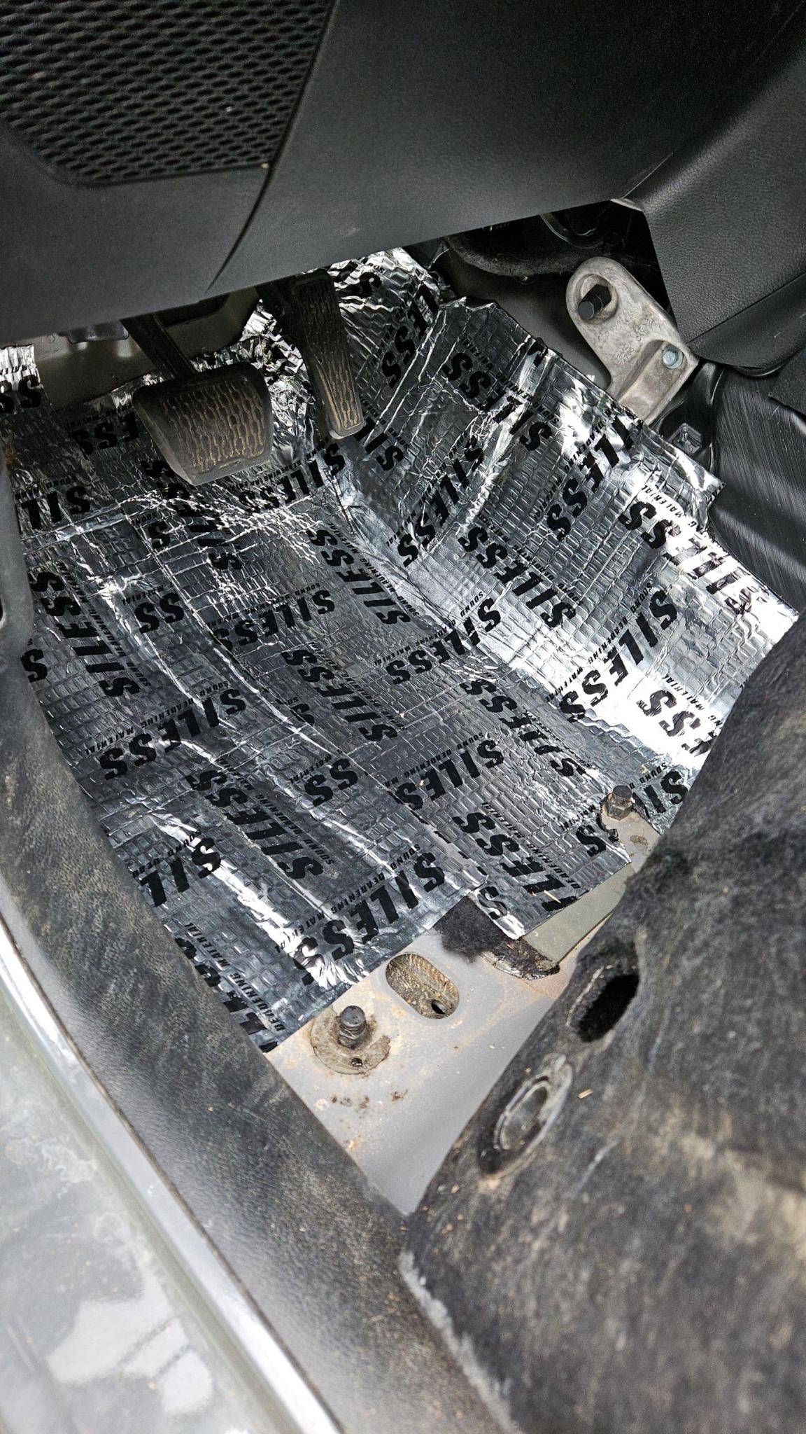

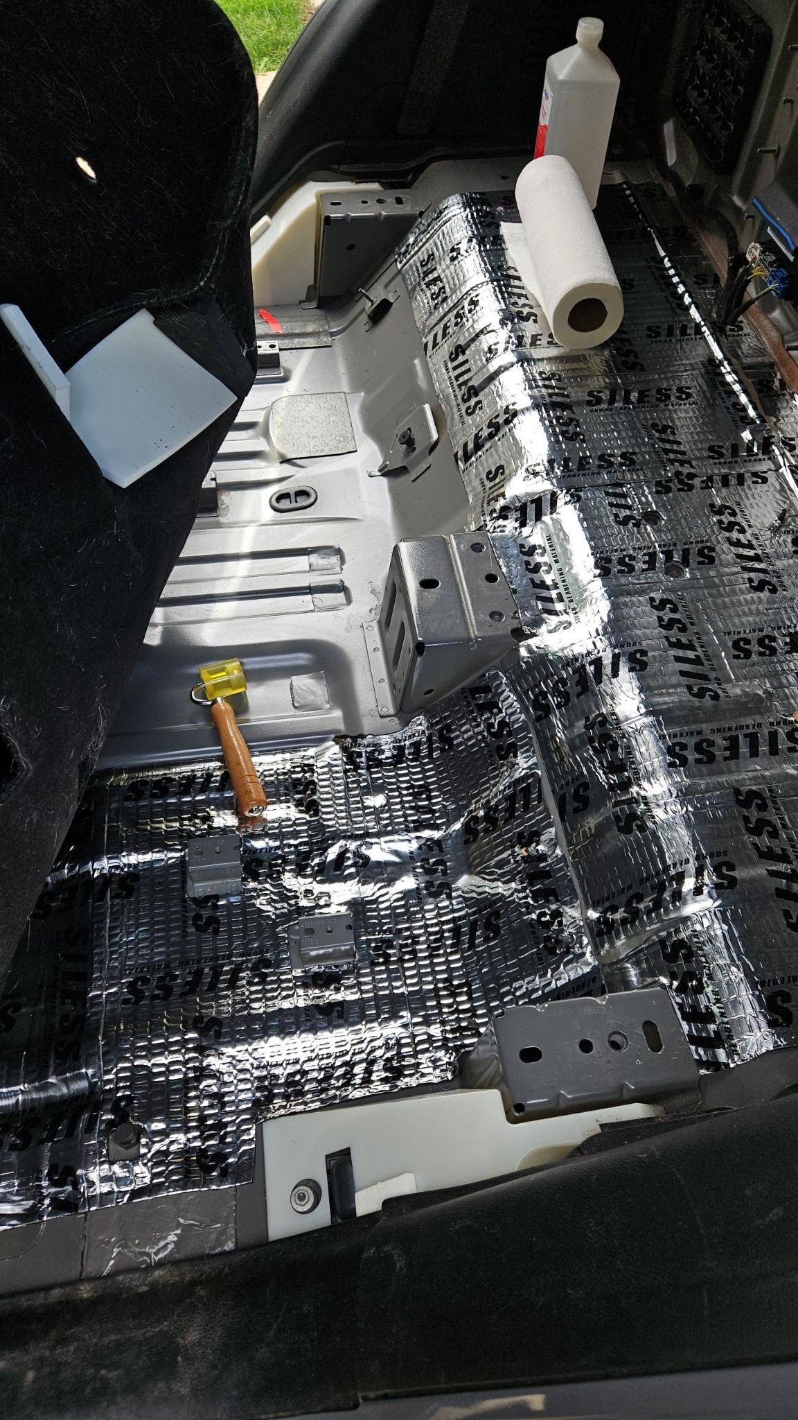

Sweet, I think I'm going to do the windshield and part of the floors tomorrow. I bought a 36 sq ft box of Silless 80 mil. We'll see how it goes. Maybe concentrate on the areas closest to the wheels.
I can't line the outer door skins because I already had the whole thing rustproofed. SO I'll have to see what I can do under the door panels....

Well, I got a 36 sq ft box of 80 mil. I've gotten it across the back floor and then installed it in the front footwells too. Even the skeptical navigator admitted there's a difference in the noise level.
Next is the windshield and then how to deal with the doors that have been Zeibart treated on the inside. They said I can't apply the sound deadener inside because of their treatment, so now I'm trying to decide what to put in there.
