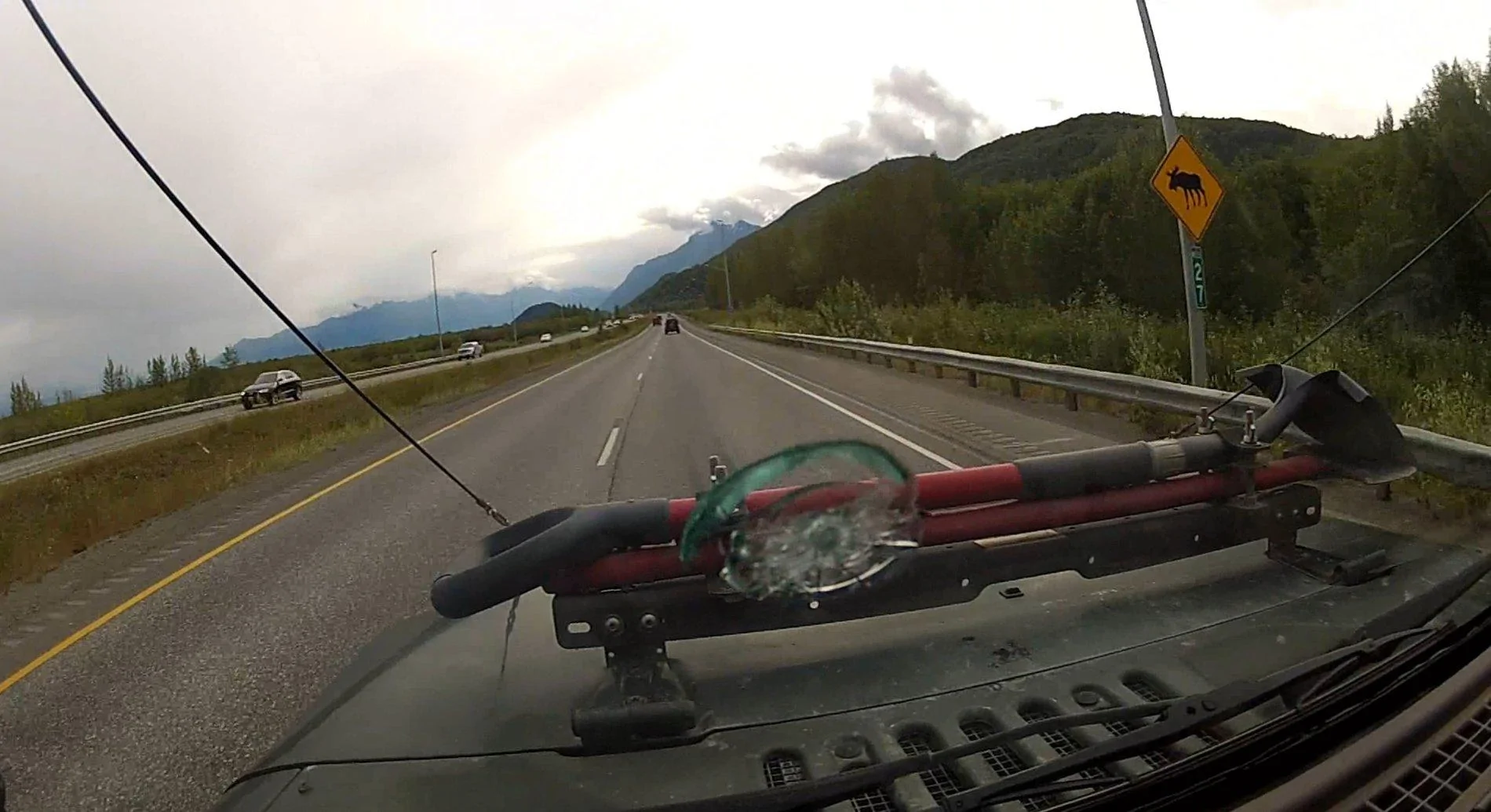

P.S.--A couple years ago driving my Jeep right past where you live, I had my five day old windshield plastered by a truck carrying gravel. Yeah, I've been all over AK and western Canada with my Jeep--and that other one that I drove to MT. You live in one amazingly beautiful state. If you're interested, you can find the video series on YouTube DigitalByDoiron, Mark and Ray's Al-Can Adventure.

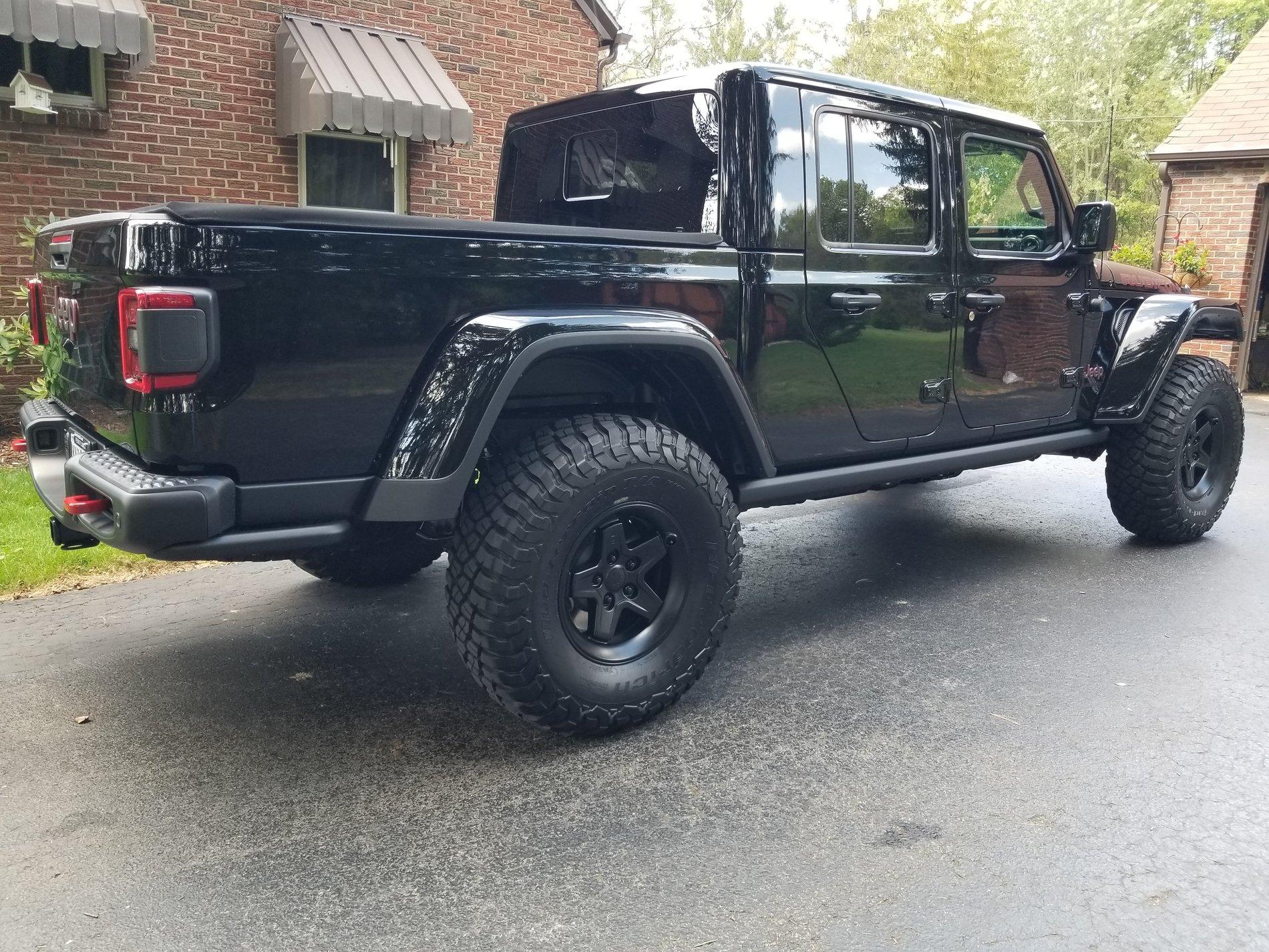

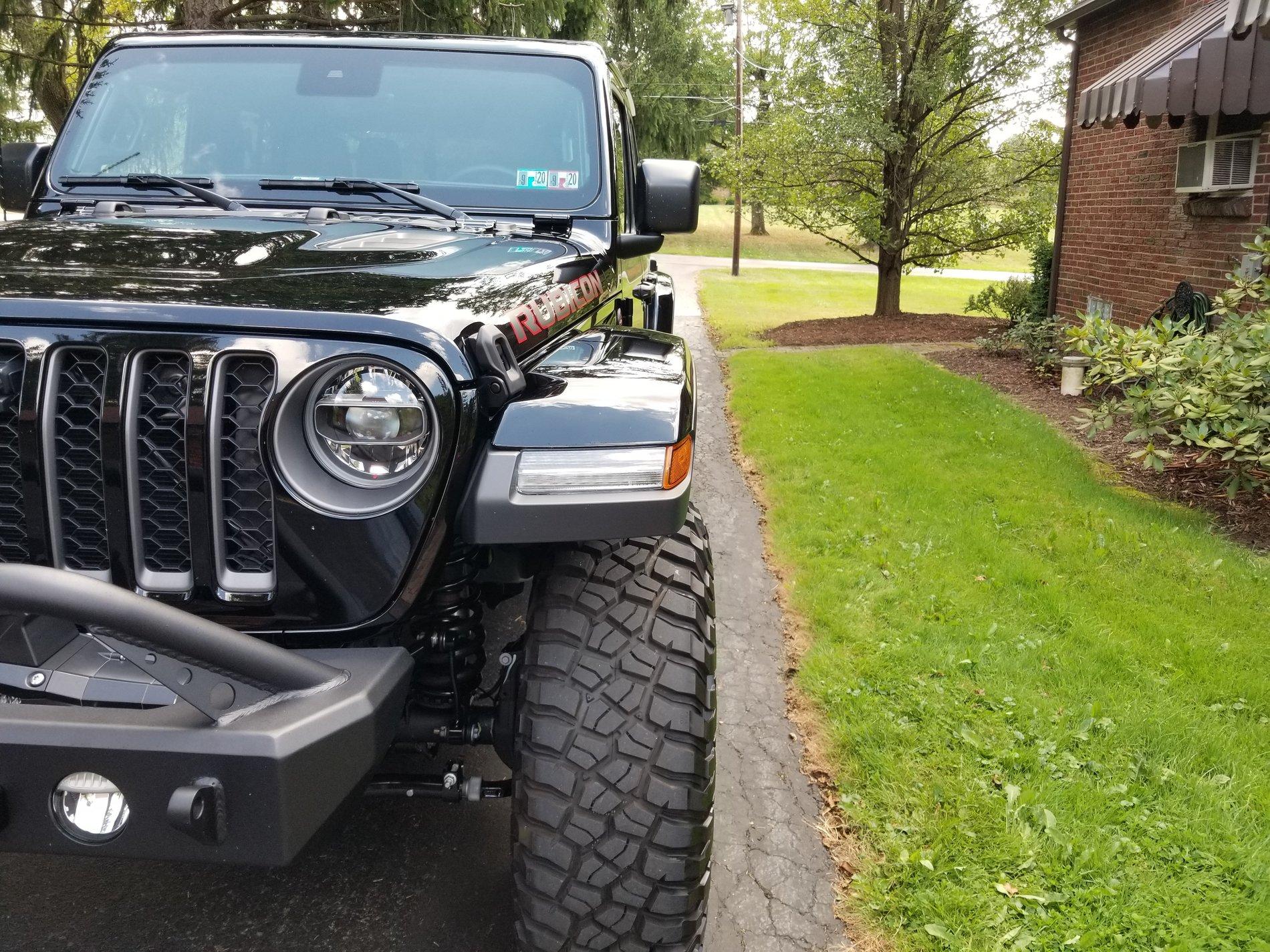

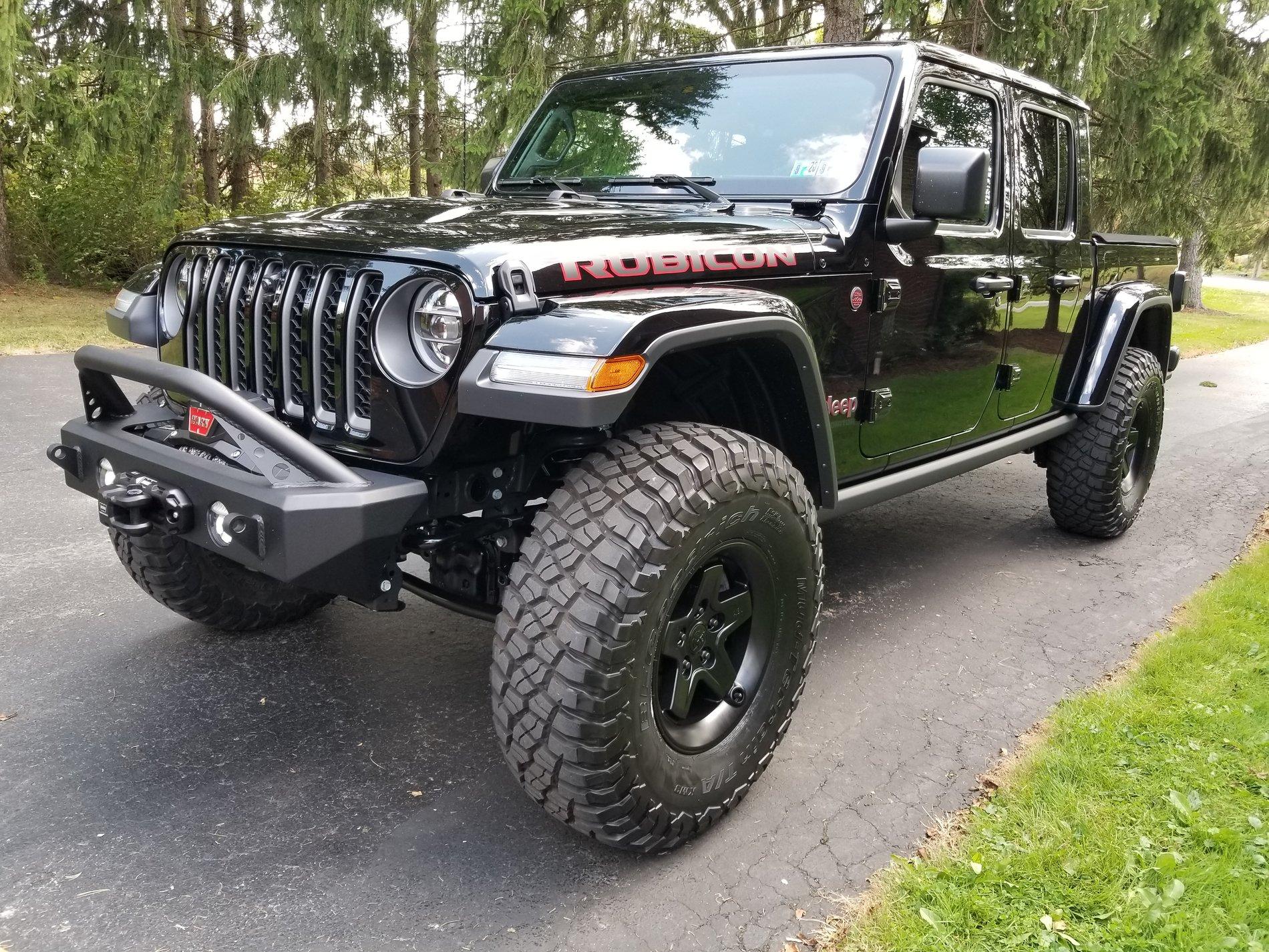

Jeep Gladiator Manual Transmission Club 20190922_134704-
Jeep Gladiator Manual Transmission Club 20190922_134732-
Jeep Gladiator Manual Transmission Club 20190922_134828-
Don't have a ton of time in on it, but first impressions are about what I expected. Had a good bit of highway coming home, 6 on flat and downhill, 5 handled moderate uphills, 4 for steeper highway uphill. I think it did pretty well, actually a bit better than expected, but really about what I thought. I don't expect it to have pickup in the OD gears, I'll downshift for that... just needs to sail. After Tazer-ing for tires at 36.5, I'm babying it around at about 17mpg. Not bad.
I'm actually struggling more with the gap between 2nd and 3rd. I tend to run up to 2500 or so and shift, and at 2500, 3rd isn't ready for the speed. I have to relearn to run 2nd to 3000. Which I do by feel of course, but I've been looking a bit to see what it's doing. Same downshifting, drop down through 4 and 3, then to 2 and VROOOOOOOOM. Hard habit to break. Say you're making a square left or right turn... it's ready for 2nd right as you cut the wheel, not before.
It's getting better as I learn it, just a brain retrain from manuals of the past. Clutch is light and the engagement isn't sharp, but I'm getting the feel. There's nothing hard about it, it's just different, and when you're in the groove it's real smooth.
I think it's a joy on back roads and such, rides and handles great, steering is good (for a rolling straight axle brick lifted with 37s), and at those speeds the high gears aren't needed, you're just 2 3 4, up and down. Having a blast with that. I even think it leans into corners well, in the way that lifted trucks on 37s do! It's fun to feel it tilt a bit then hunker down on the springs and stay there.
All in all, I'm super pleased.
