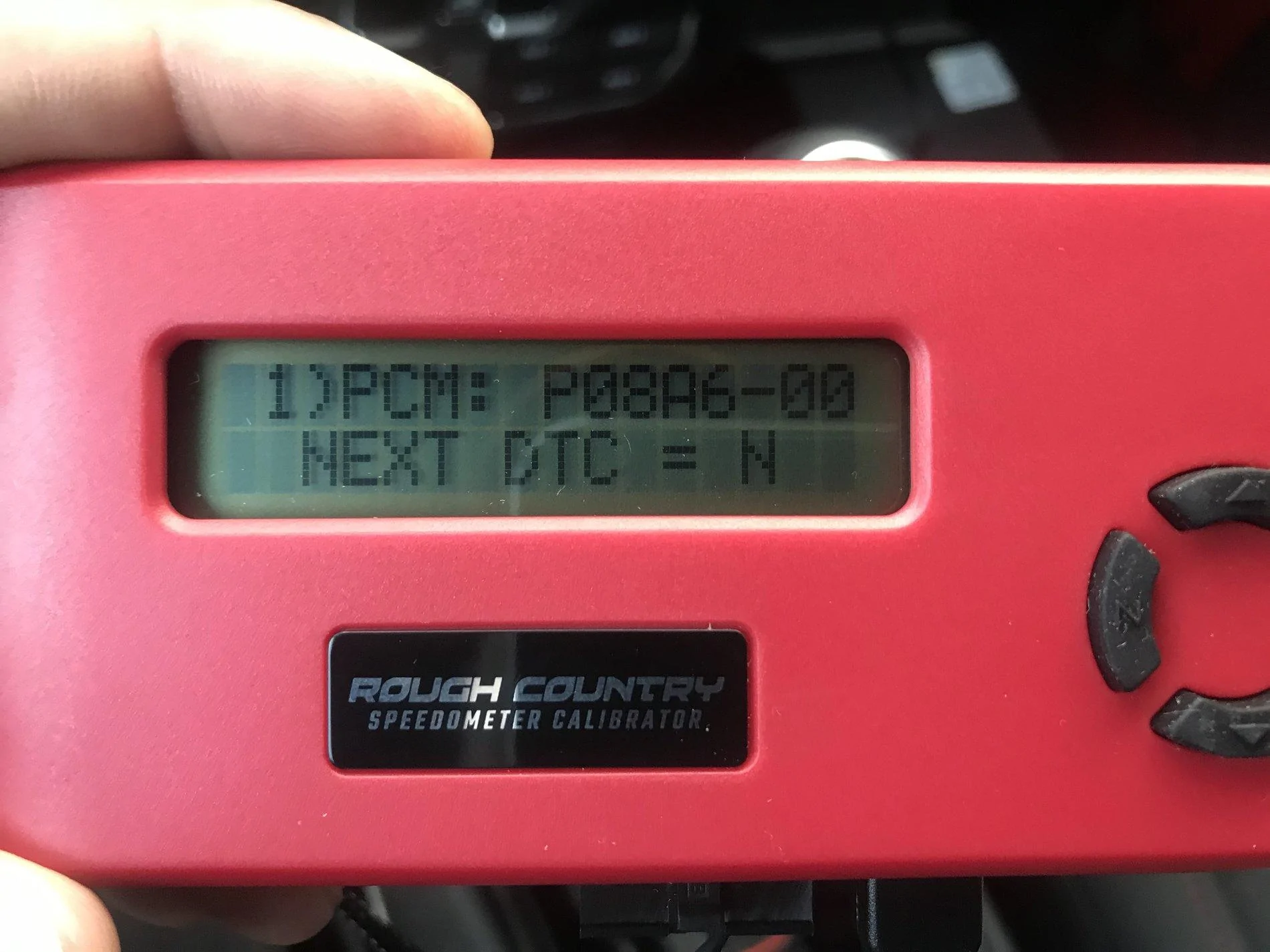

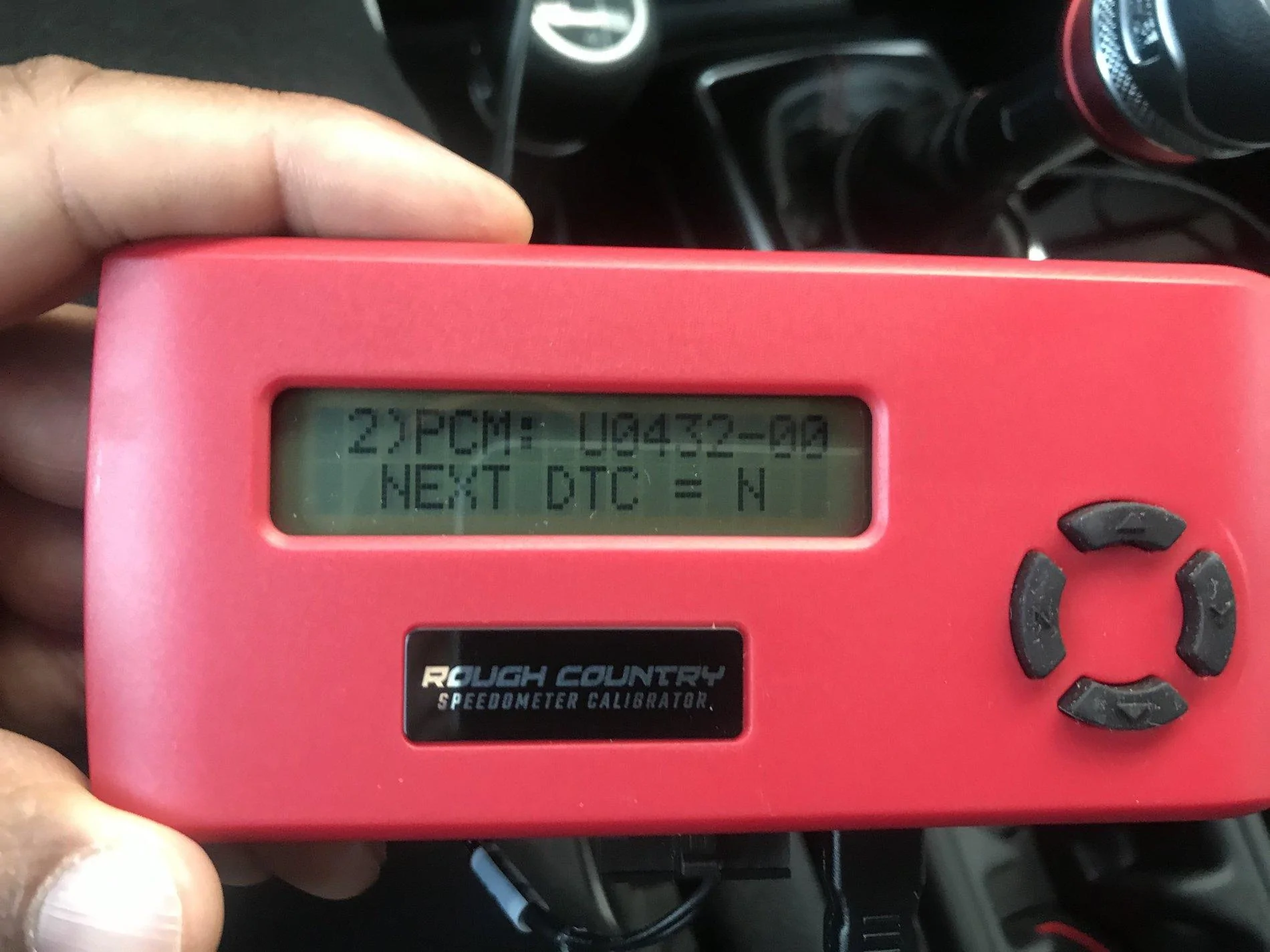

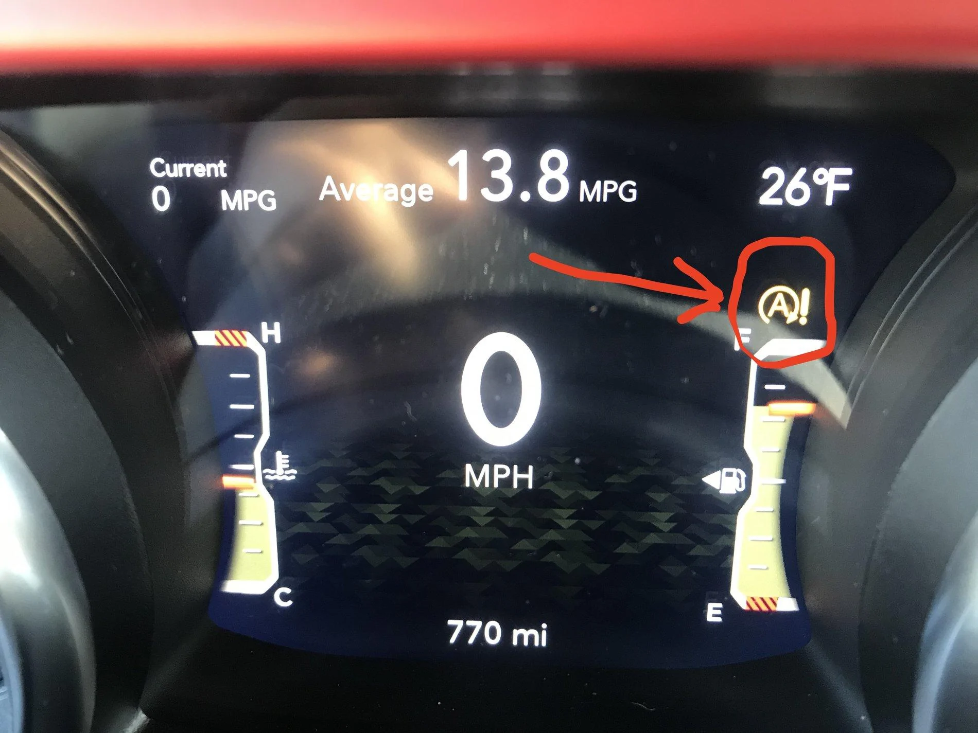

I ordered Tazer mini to do mineWhat did you 6 speed manual guys use to recalibrate your speedometer for larger tires?
Here's my experience with RC's Speedometer Calibrator.I ordered Tazer mini to do mine
Tazer mini has a manual transmission specific process/addendum you have to follow.Here's my experience with RC's Speedometer Calibrator.
Definitely corrected the speedo BUT...Disabled my Start Stop (with an accompanying warning to "service the start stop" ... and a dash amber warning light for the same) and threw 2 PCM codes.
When I put it back to stock it corrected everything.
Notified RC and they are working on a program to address it. (Sounds like I am the first to report this issue)
Others with the auto have not had this problem to my knowledge.
And YES...I had updated their latest software.
Good to know....Tazer mini has a manual transmission specific process/addendum you have to follow.
