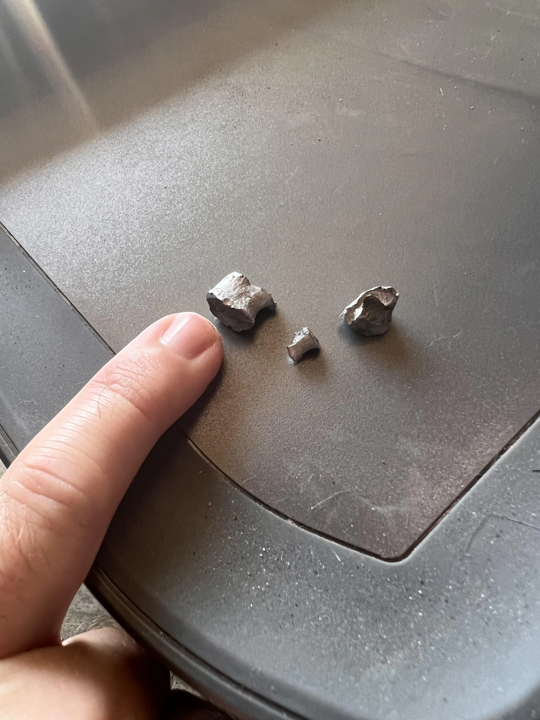

No updates. New engine arrives tomorrow. Dropping the JT off Monday. Will be interesting to see the extent of the damage - I have a feeling there is a lot more at the rear or potentially visible once the transmission is removed and flywheel is exposed. Today I discovered these bits of aluminum sitting under the flywheel, where the rubber grommets seal the engine and transmission.
Jeep Gladiator Mark another one dead 45DC0C32-CC58-4C72-A53C-EF63D67E3641

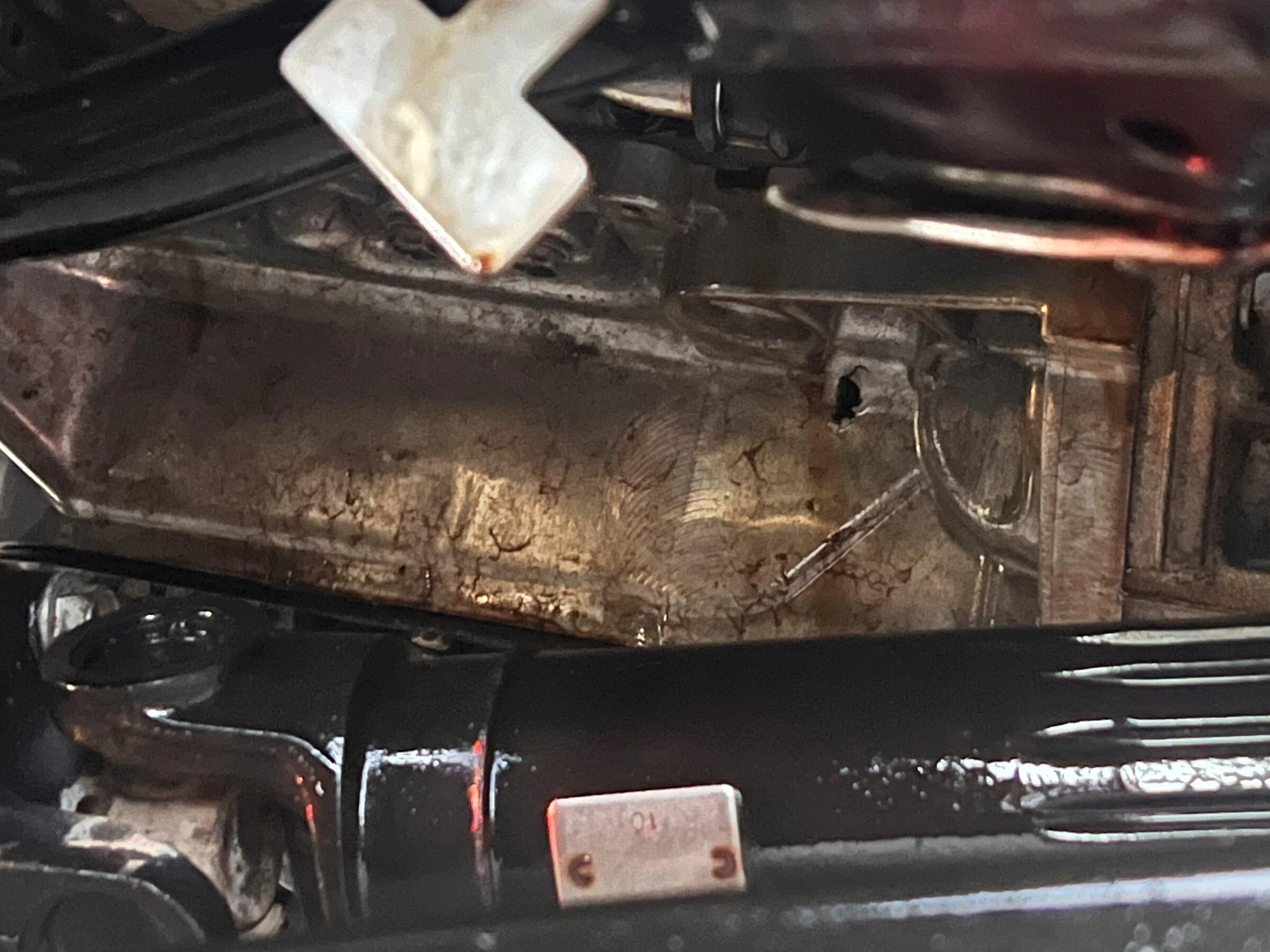

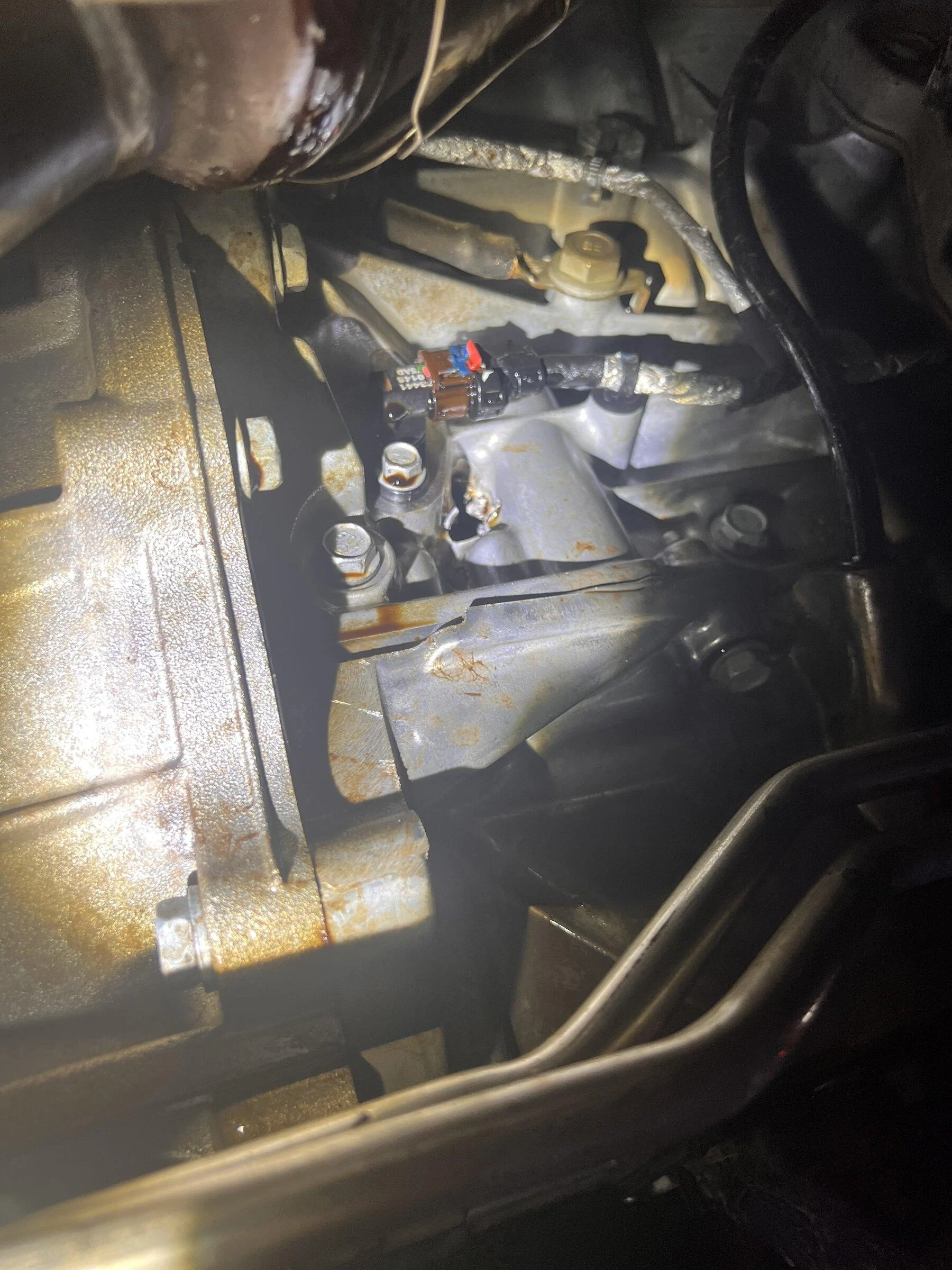

Ugh. Found a new huge hole next to starter. Unknown if starter motor was damaged. Debating to order a replacement now and get ahead of it in case.
jsalbre
Jeremy
Mar 17, 2021
676
812
Idaho
‘21 Sarge Mojave, ‘21 VW Tiguan SEL-P RLine
Security Engineer, First Sergeant
Wow. When that thing went it *went*.
