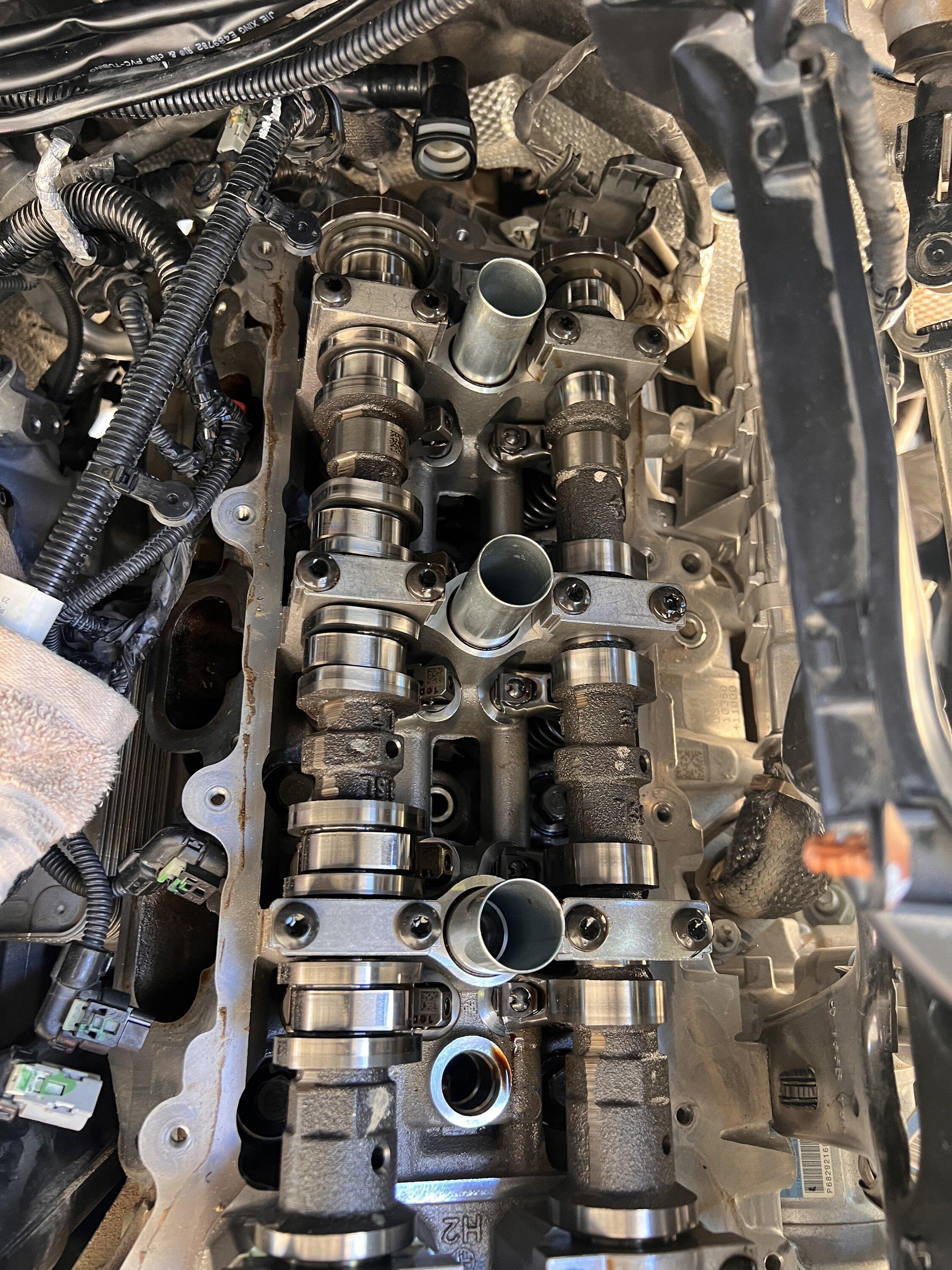

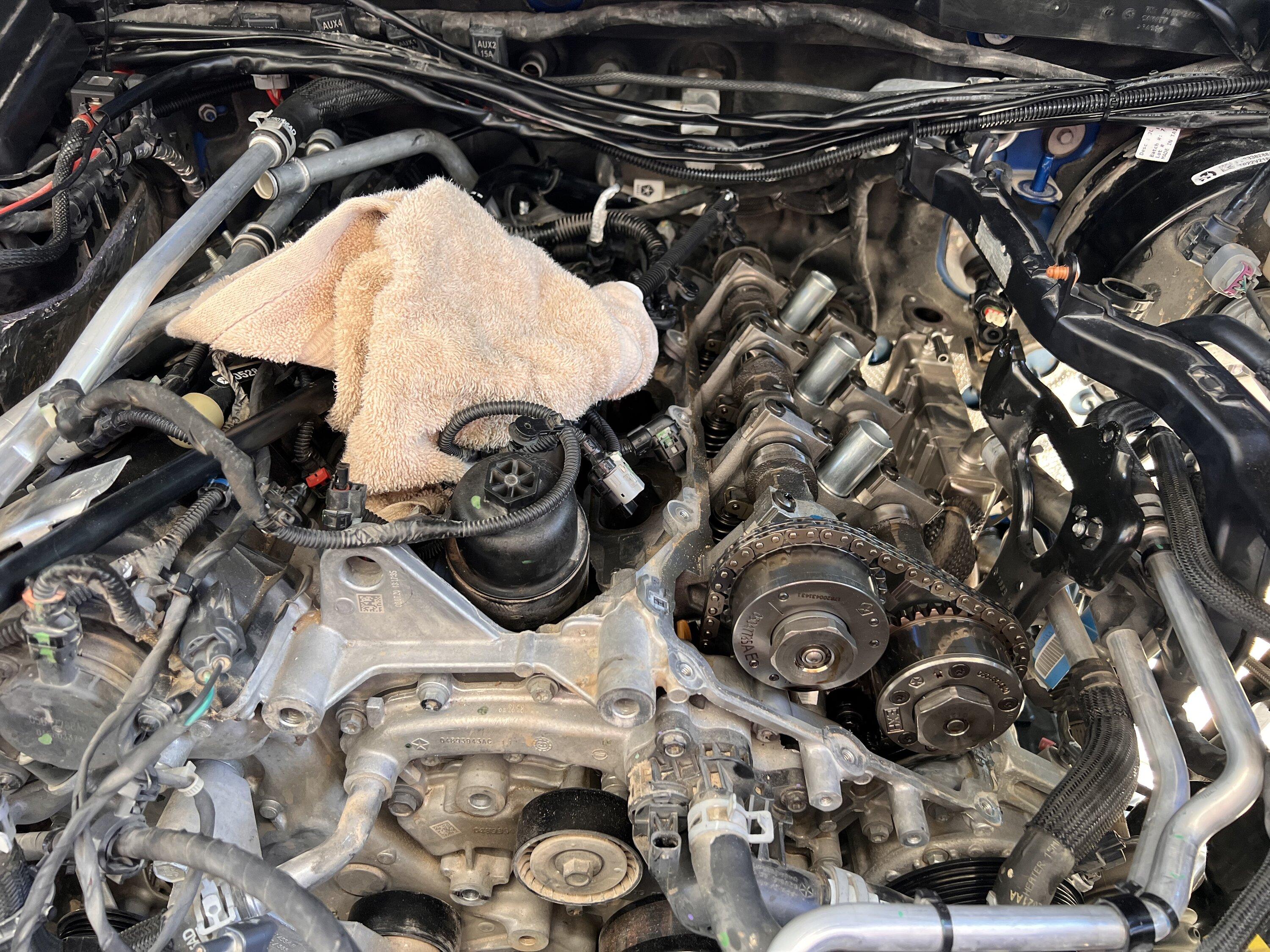

Not sure how much further I’ll tear it down. Don’t believe I have the right tools for the cam anyways.
Jeep Gladiator Mark another one dead D30047B4-EFCC-4B1C-B895-0B3DD05AFB33
Jeep Gladiator Mark another one dead FEB62614-1633-4C7E-A03C-2CC37372C5C2

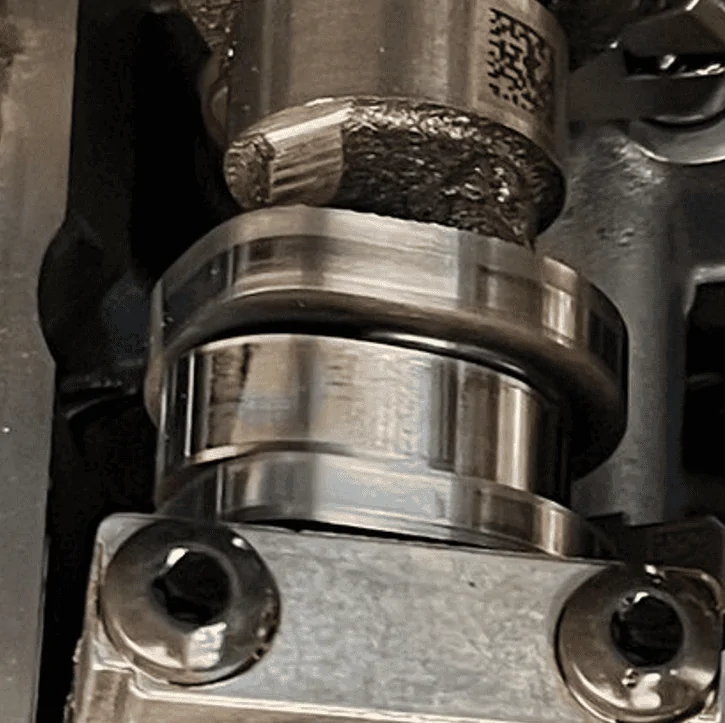

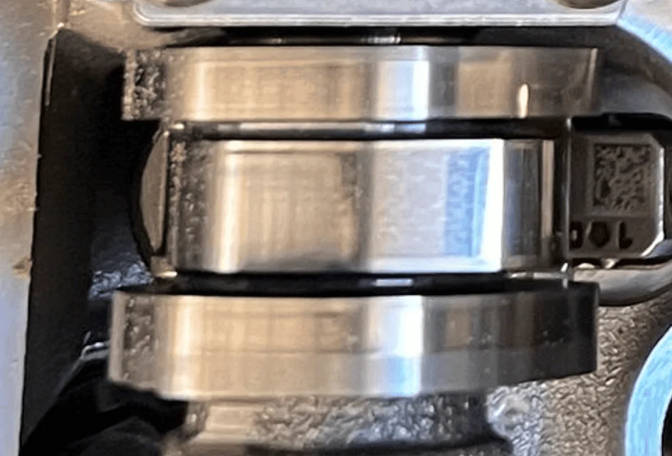

I am not positive, bit it looks like your intake cam is wiped. How many miles are on it?

Is the Grey residue on the brown ring on the back of the cam?
