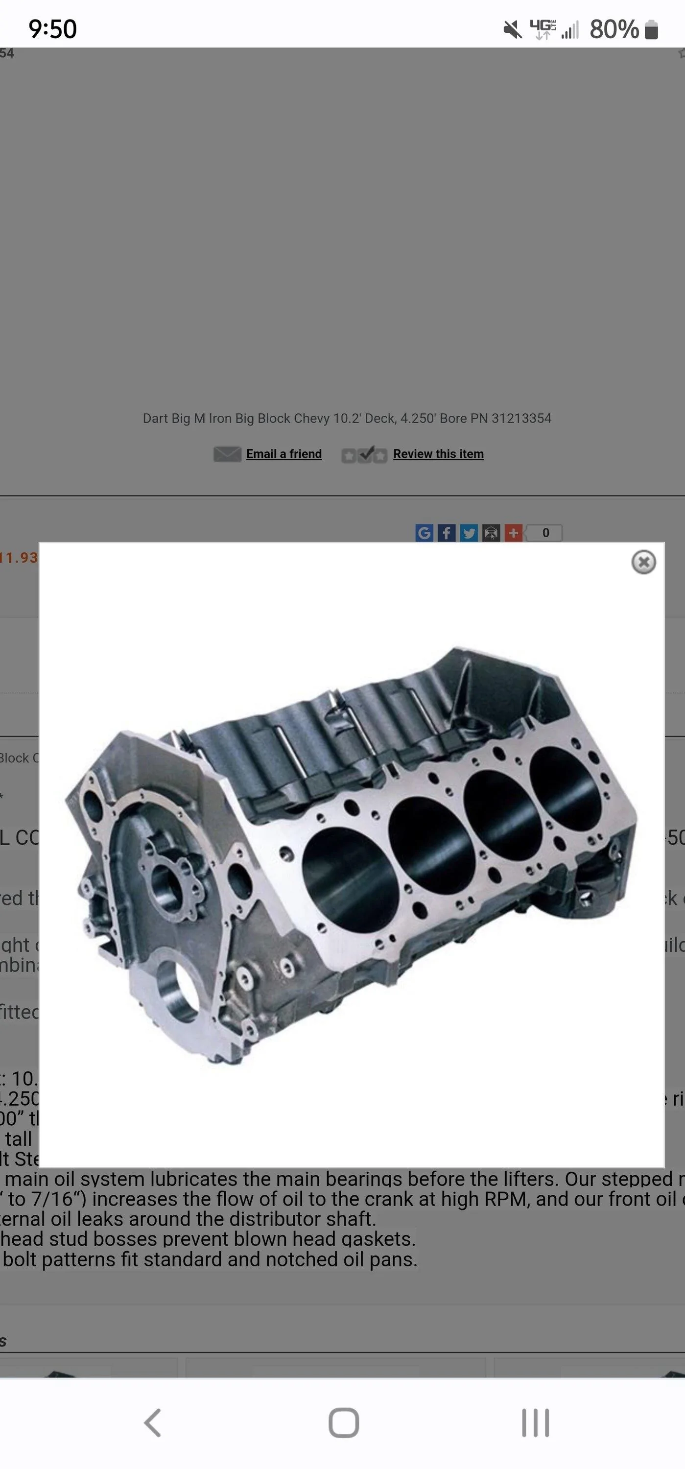

Closed deck on top open deck on bottom
And as a whole that’s worse for forced induction?
Thank you btw. I know a pretty decent amount about engines, but less about forced induction other than forged internals are good and avoid detonation. Hah.
edit: And I wished I had forced induction when I lived in CO. Hah

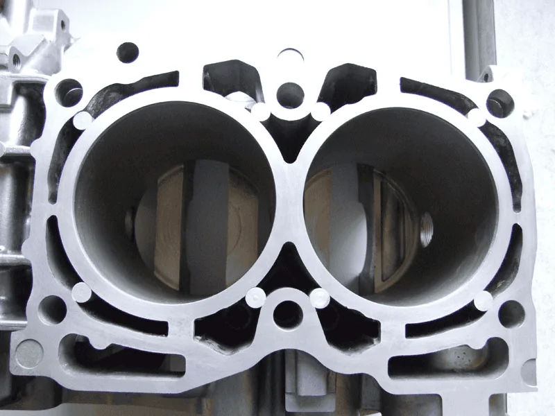

There's a lot of people running SCs on open deck engines, some even from the factory.
Open deck allows more coolant around the combustion chamber and a lighter block design.
Here's another closed deck engine ->

Open deck gets better cooling but has less bore support. In higher hp motors with higher pressures, the bore can deflect a bit. This does bad things to pistons and other parts. ie BOOM!
Closed deck gives the most support to the bores.
More goes in to it and I only know enough to make myself look silly.

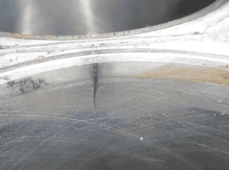

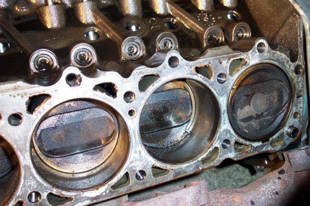

Actually, most of the time it's not boom, it's most common for the cylinder liners to crack at or near the very top. The cylinder can flex at the top due to the extreme pressures - and no bracing...
This is the most common damage -

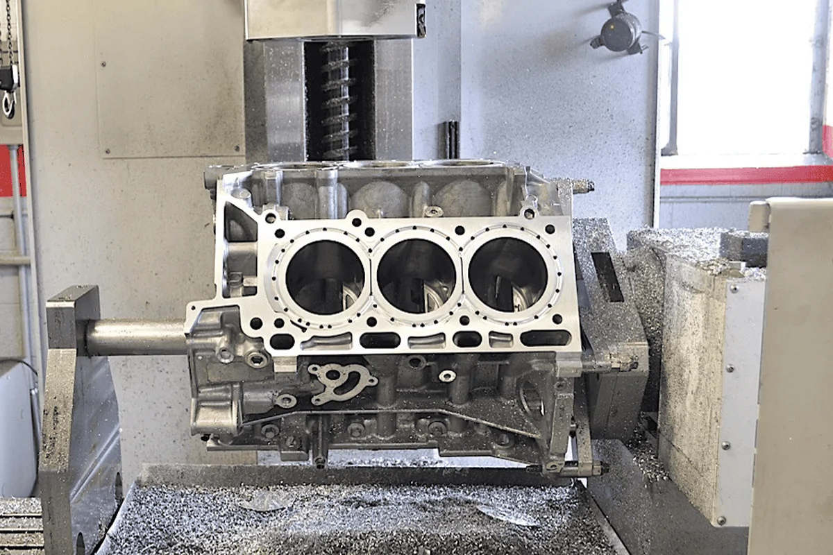

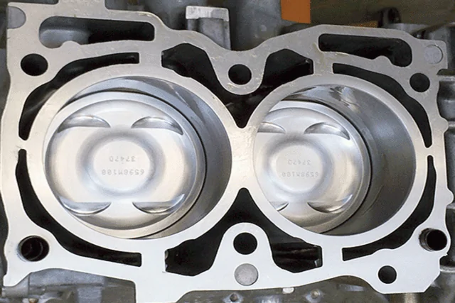

But then there's also semi-open (or semi-closed, same thing) deck, and you can brace an open deck engine block.
Semi-closed ->
Jeep Gladiator Mark another one dead 1656681264198

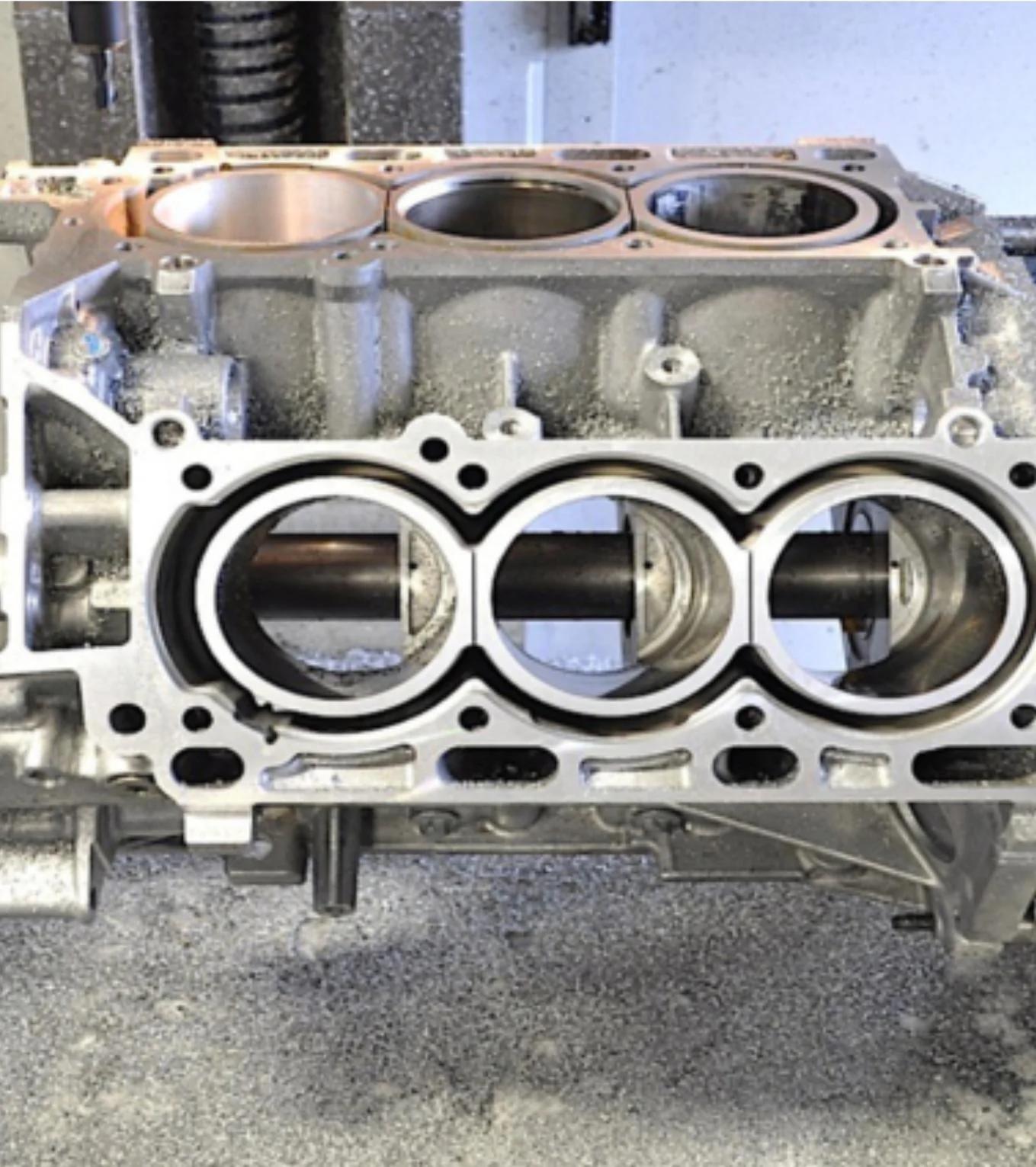

You can also sleeve an open deck block ->
Jeep Gladiator Mark another one dead 1656681412864

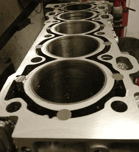

This is one way to brace an open deck block -
Jeep Gladiator Mark another one dead 1656681489642
Jeep Gladiator Mark another one dead 1656681587531
Check out what Subaru performance people as well as others are doing....... some will handle some pretty good boost.
That looks exactly like what happened to my Subaru. New short block under warranty though.
Yeah, that pic might even be one I found a couple of years back when researching my stupid idea or a SC on my truck...........
I talked myself out of it. But it was close, especially with Dave doing the hard part. I almost started an account to save up for it.
If one is going to fail, that's the most common failure right there. When you build crazy pressures in a chamber, that chamber would love to expand and when it does - CRACK, right up top because that's where the weakest link is. (that would make a good name for a TV game show....)
Cylinders flex. Heck, even bolting a head on flexes a cast iron block - that's why there are special plates to bolt to the top of the block when honing to size - to sort of replicate the block distortion caused by bolting a head on.
