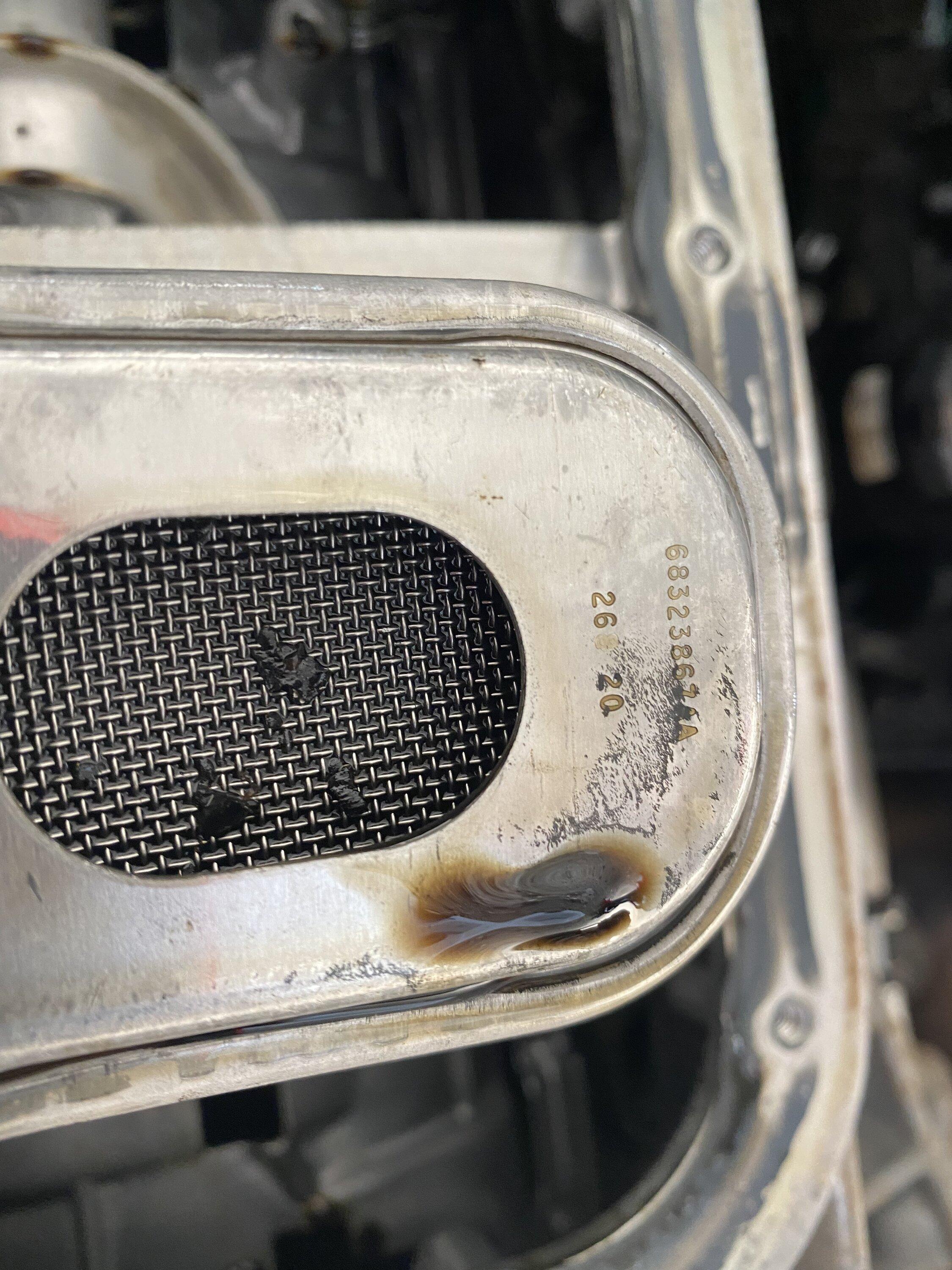

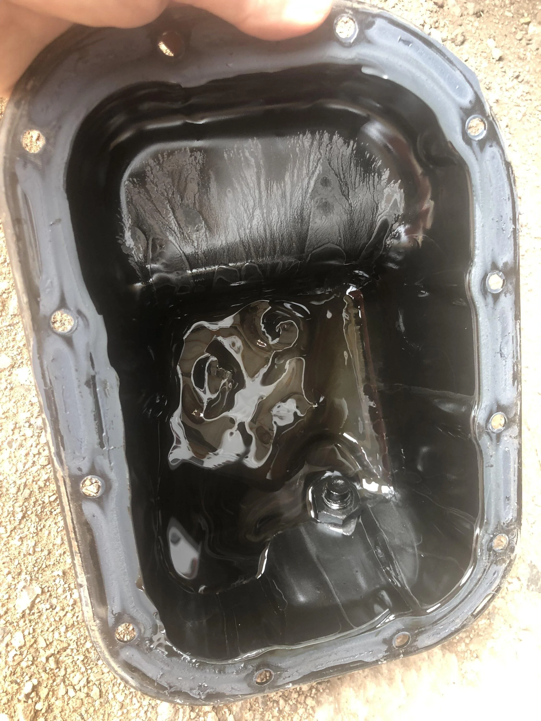

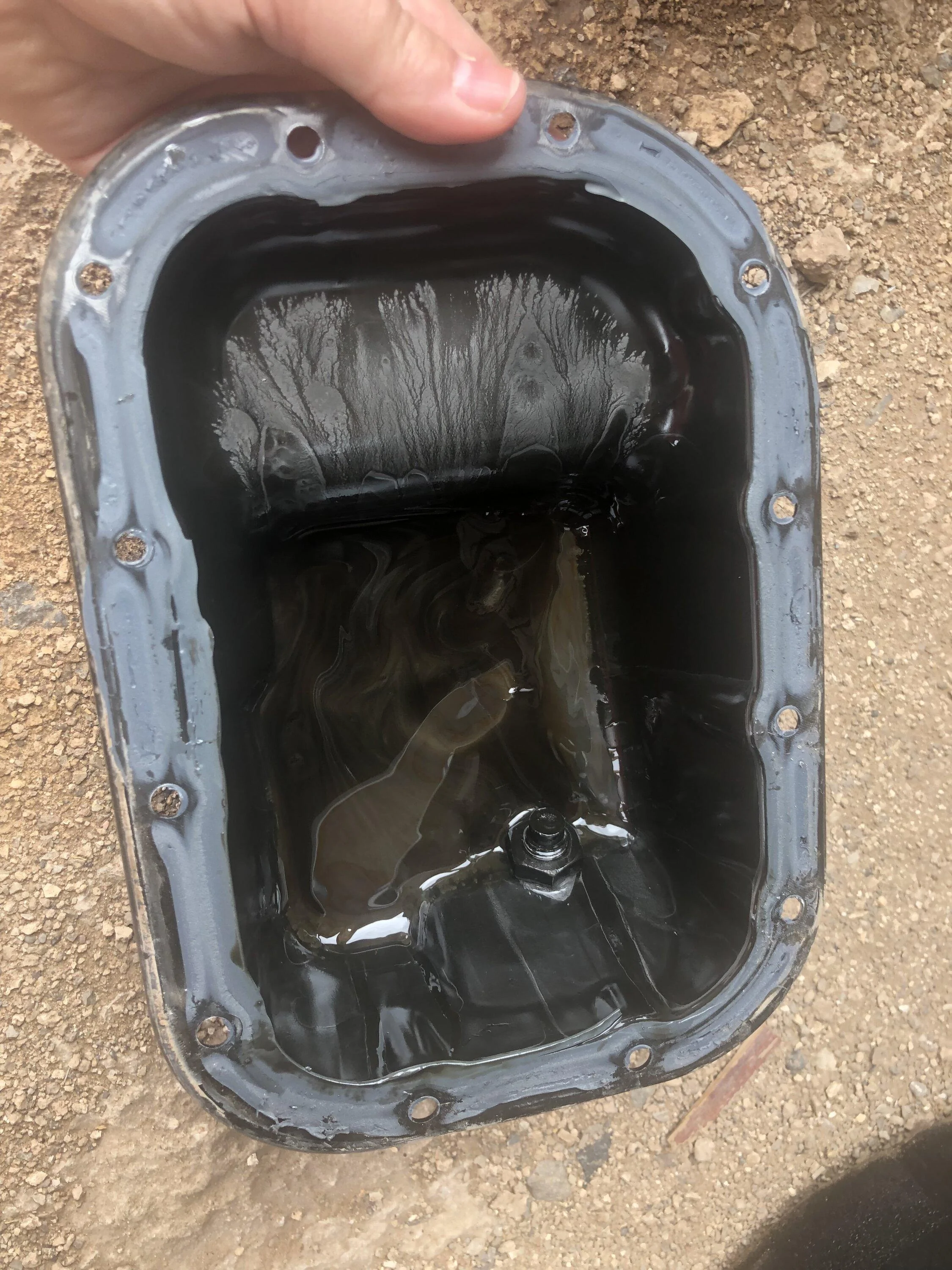

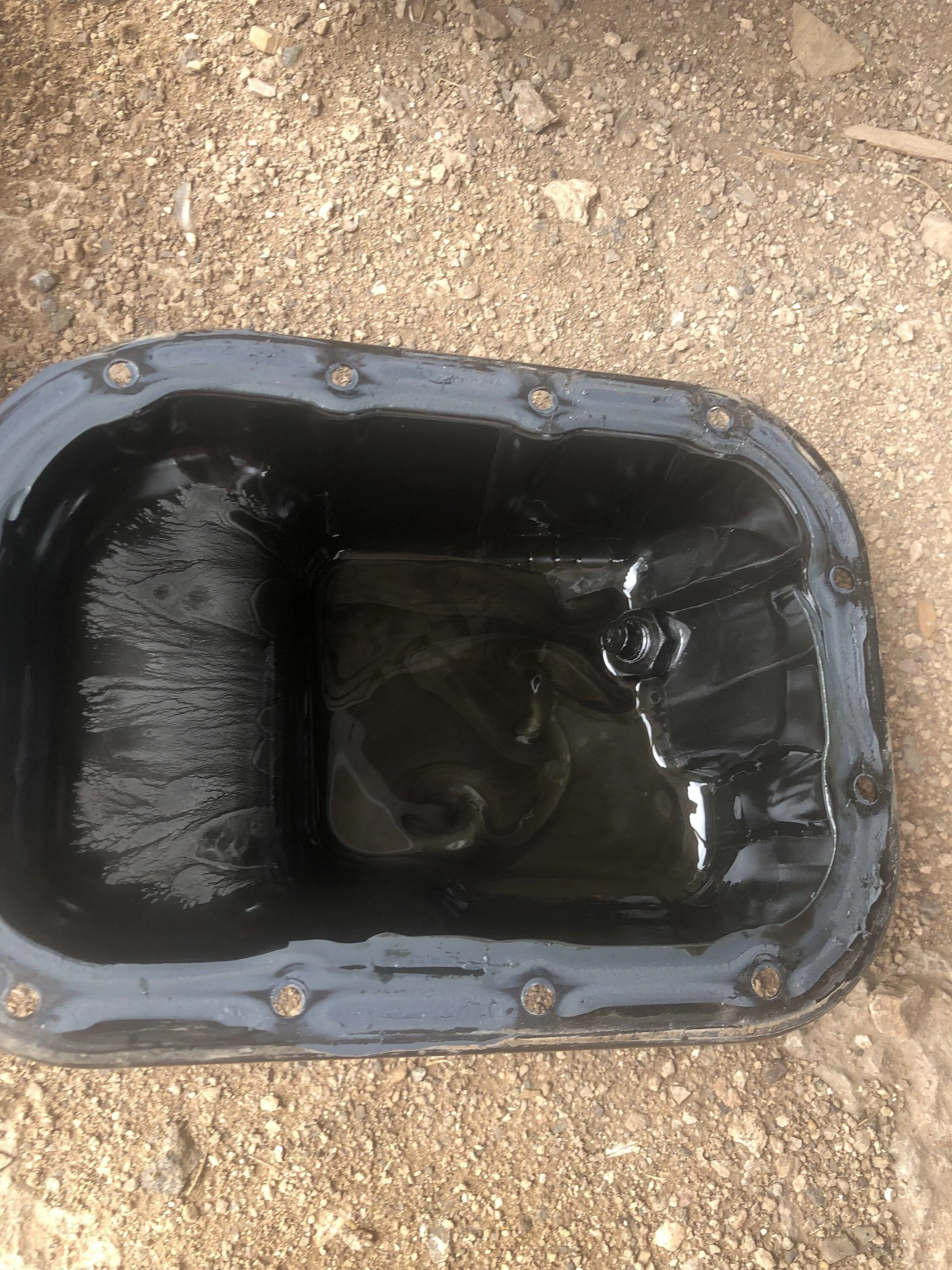

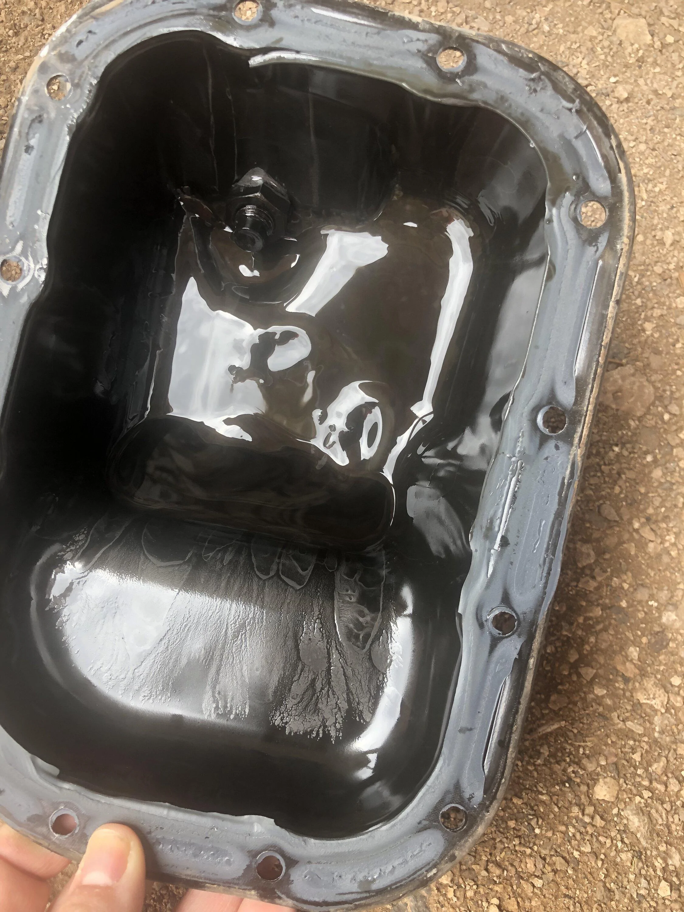

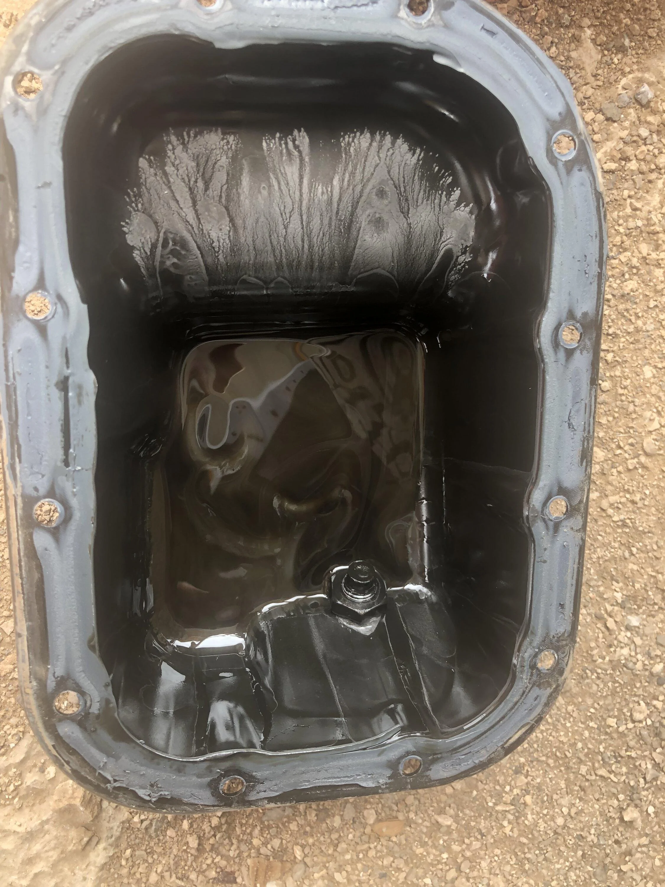

This…… wiped rod bearings??? And more Three Bond. It was pretty over-applied to the lower pan.
I am not sure what the bearing construction is in these engines but usually a rod bearing has a copperish glitter color. That looks like straight iron or aluminum
1BadCtdBrute
Apr 7, 2021
62
New Mexico
‘99 XJ, ‘09 JKUR, ‘21 MOJAVE
Professional killer
Whatever it is my engine knocks like it has no oil in it. Luckily it has maybe 100 miles on it since the Magnuson install. What would be iron/steel and not be the brand new cams/lash adjusters/followers/phasers??? I did have the wrong lash adjusters on bank 1, and the VVL solenoids all looked much worse than the pickup screen, clogged with Three Bond. It’s been suggest that it could be a timing chain tensioner but I think it would have to be all of them for the chain to have enough slack to contact anything. That sound would be easier to hear/find. My knock is in the V of the motor. If anyone has any ideas I am listening. I’m out tons of $$ on this already, might as well throw away some more.
