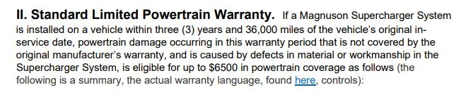

If you purchase the Magnuson Supercharger, get it installed by a certified installer and use Magnuson tune, they give you 36k powertrain warranty from install date. Superchargers are $7.5k not 4k thats before being installed.
