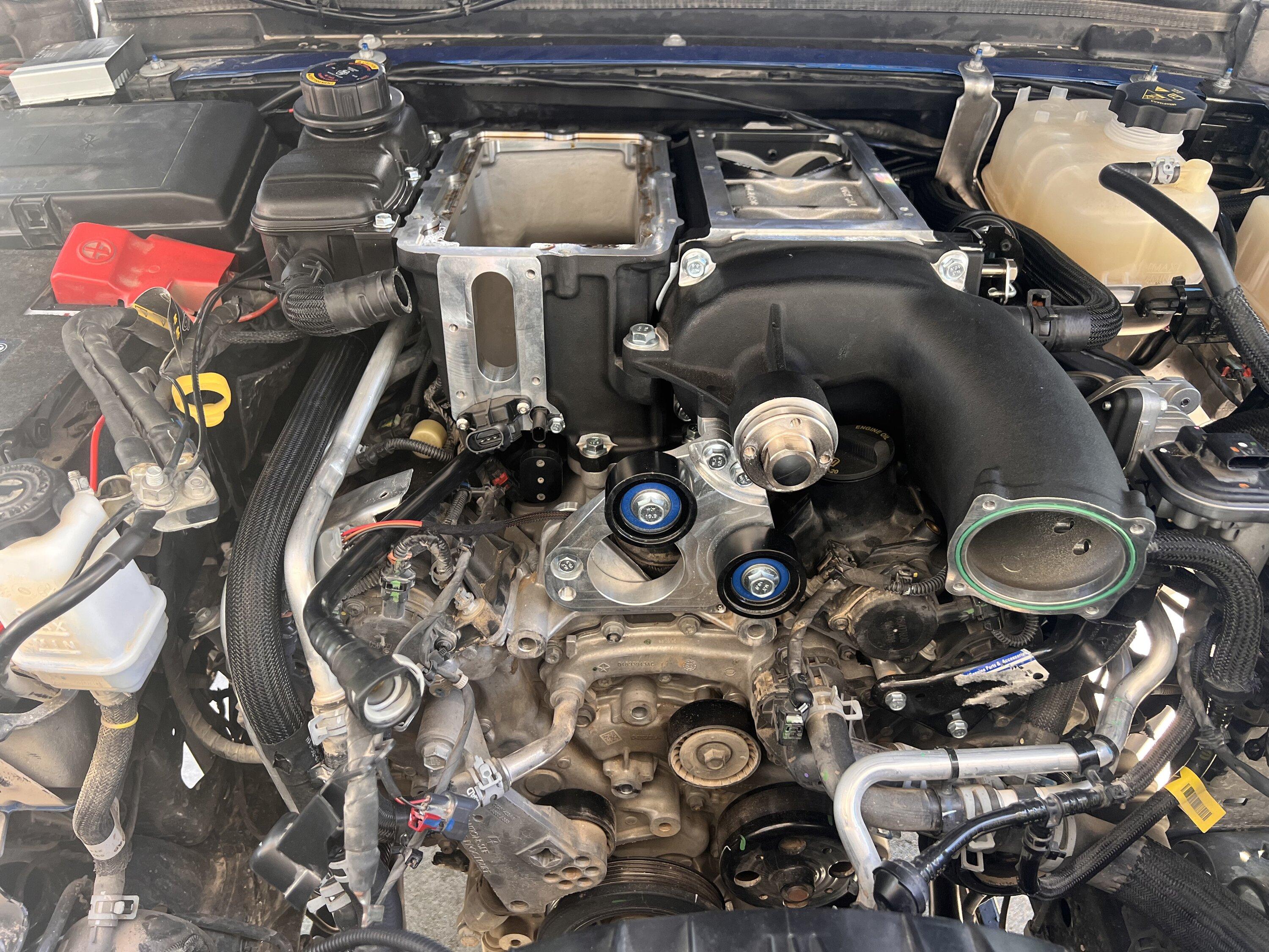

If I had a salvage Gladiator with a blown engine, just something to play with, something trashed other than body, I'd at least go a blown 401 with aluminum heads. OK, just messing around. Gotta find something to do with this 401 sitting here in my shop.
Anywho - gotta agree that the forensics on the blown paper weight would be interesting.
One can always ask - was this one at risk anyway, or was it otherwise fine.........

Well I can say oil made it up into the heat exchange (which sits directly above the intake mani).

Pretty obvious by pic it's the gas 3.6

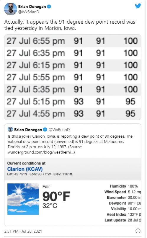

Come to Iowa next month................ this is from 11 months ago - several days of 100% humidity. Things were so bad when you killed weeds, they didn't dry up and blow away, they turned black and mushy like oil.
The lawn stunk from mold.
Jeep Gladiator Mark another one dead dewpoint

Well I may know what caused this. I hacked a 2021 OS into my jeep the last two weeks to try and help the guys with 2021s that are getting stupid throttle response and generally just less performance.
I have been logging data almost everyday trying to find tables that are not correctly defined and what not. This week I switch everything in the tune back to stock except for the things that absolutely have to be there for boost. What I found really worries me and surprises me.
With my cam timing, ignition, and fueling safeties out of the way. I was able to see that the OS no longer switches to the low octane tables. I could not get them to come on, no way no how.
Along with that the minimum pulse width for the injectors no longer goes below stock. When the load reaches close to 125% above 5000 rpm injector 5 or 6 just intermittently quit spraying fuel. Yeah that will make you mess you pants.
I have changed a number of injector settings but it will not consistently stay on. I am going to talk to HP.
My interim fixes are torque limiting to really low numbers, Magnuson does this. Fudging the injector table, which will throw off everything, or coming up with a shift strategy that keeps rpm up, and load low, with torque management, but there are torque management tables in the 2021 OS that do not work correctly.
To make this even more fun, I am seeing data from 2020s that have had the latest updates applied, that are doing the same thing.
I am less that thrilled with the engineering in these engines.
I am probably going to make some conservative tunes with all the safeties activated, but I no longer think it is safe to push these engines anywhere near 400hp. I think the small pulley is a better fit, but if your not on tip tier 93 octane I would keep it at 3/4 throttle or less.
