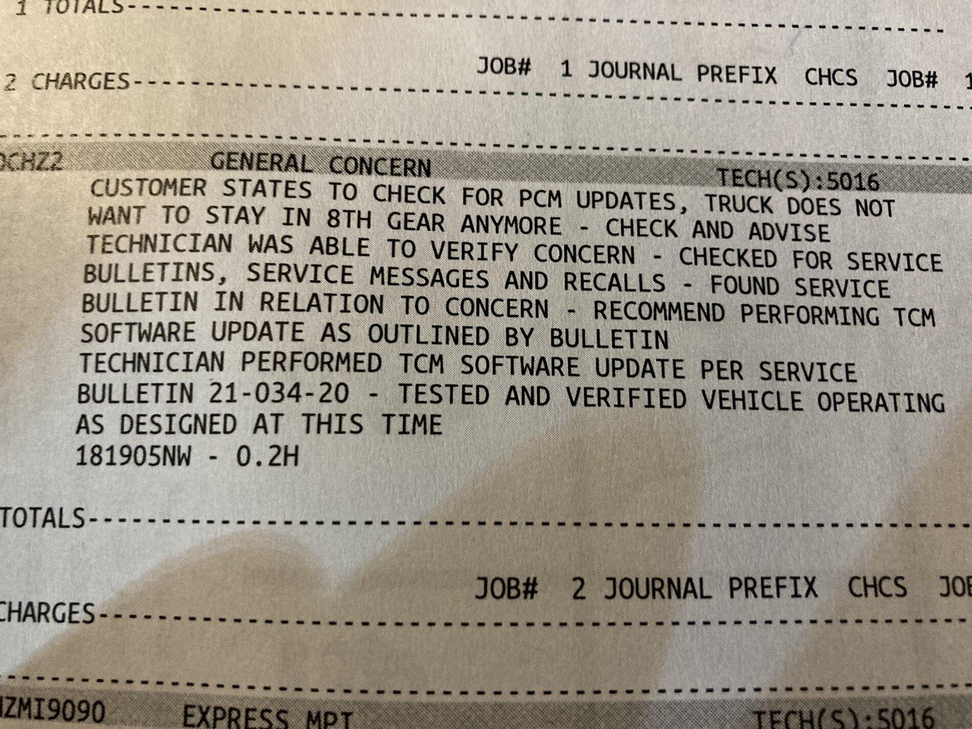

Ive been racking my brain trying to figure out why my MPG sucked on the way into work this morning and why I was downshifting way more than normal. I just installed the rubi plastic front bumper with the steel skid and noticed three is an air gap between the grill and the plastic facia under it, as well as between the skid plate and the bumper. Im thinking those could be the culprit.
Its odd because yesterday I was getting my normal 19-21 hwy and staying in 7th and 8th easily...where today I saw 5th at one point. Just seems strange.
I got some foam to fill the gap under the grill, hopefully, tonight. and I am thinking through creating a gap filler for the steel skid where it meets the bumper.
***a note before shadowspapa shoots something at me...I'm not as concerned with the MPG. Im trying to figure out why the heck my shift points were all jacked up
This helped a lot!
Jeep Gladiator Max Tow - Real World MPG? C99CB8E5-5A35-44AD-B425-4CFE0982B044
