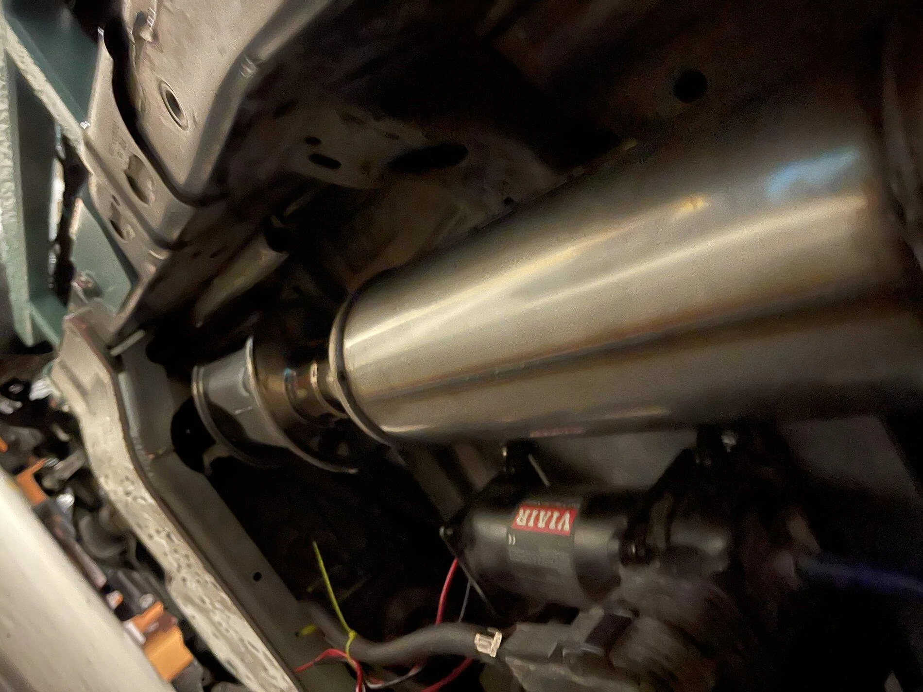

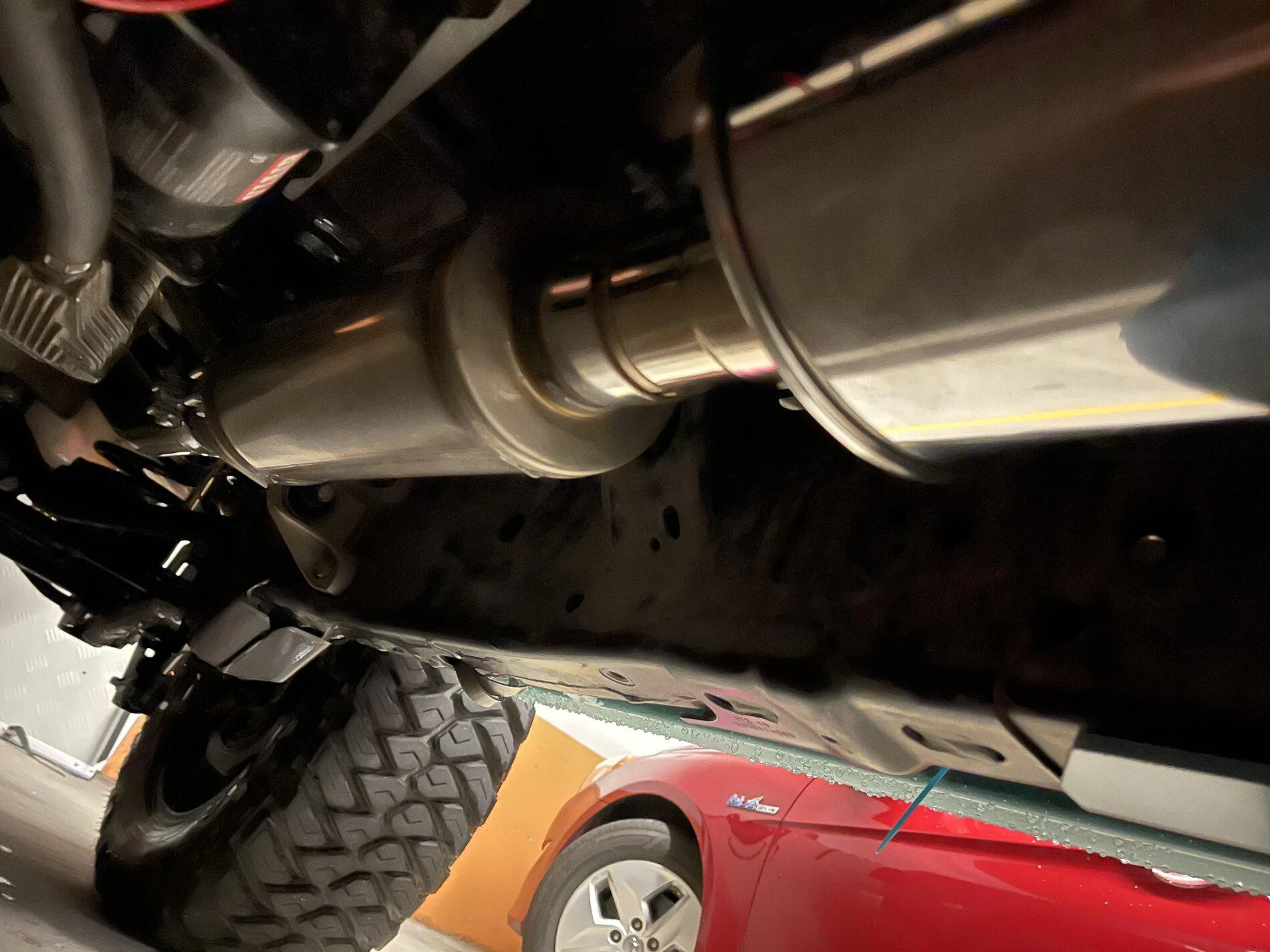

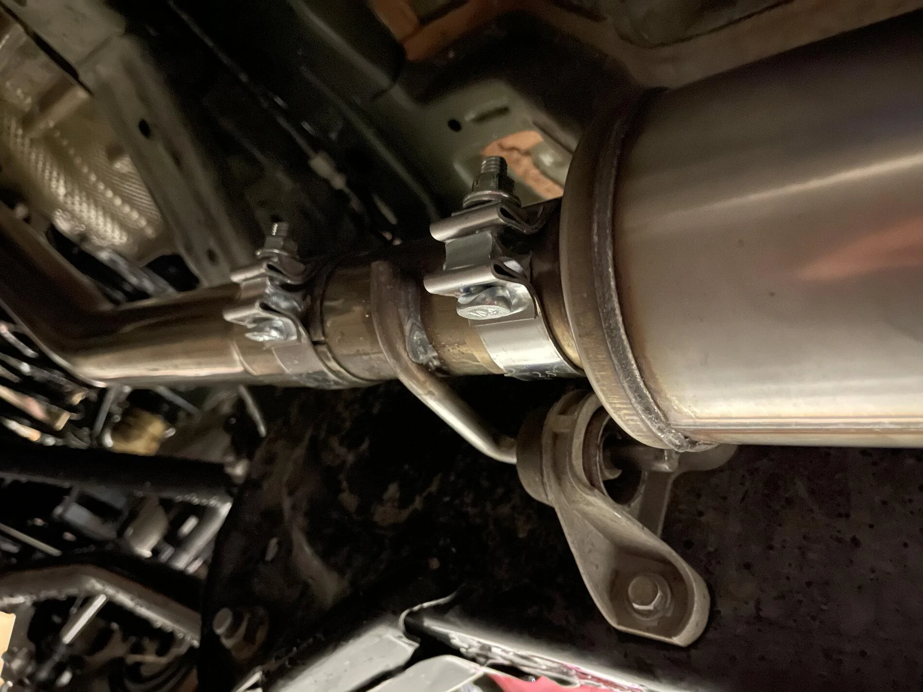

Ok! Drone solved :) Added a few details in my build thread, but simple answer was the vibrant performance ultra quiet resonator mounted right in front of the muffler. Reused everything in the MRBP kit and it just required two more clamps and a little pipe cutting.
Exhaust sounds awesome now and I can barely hear it in 7th and 8th with the music off.
