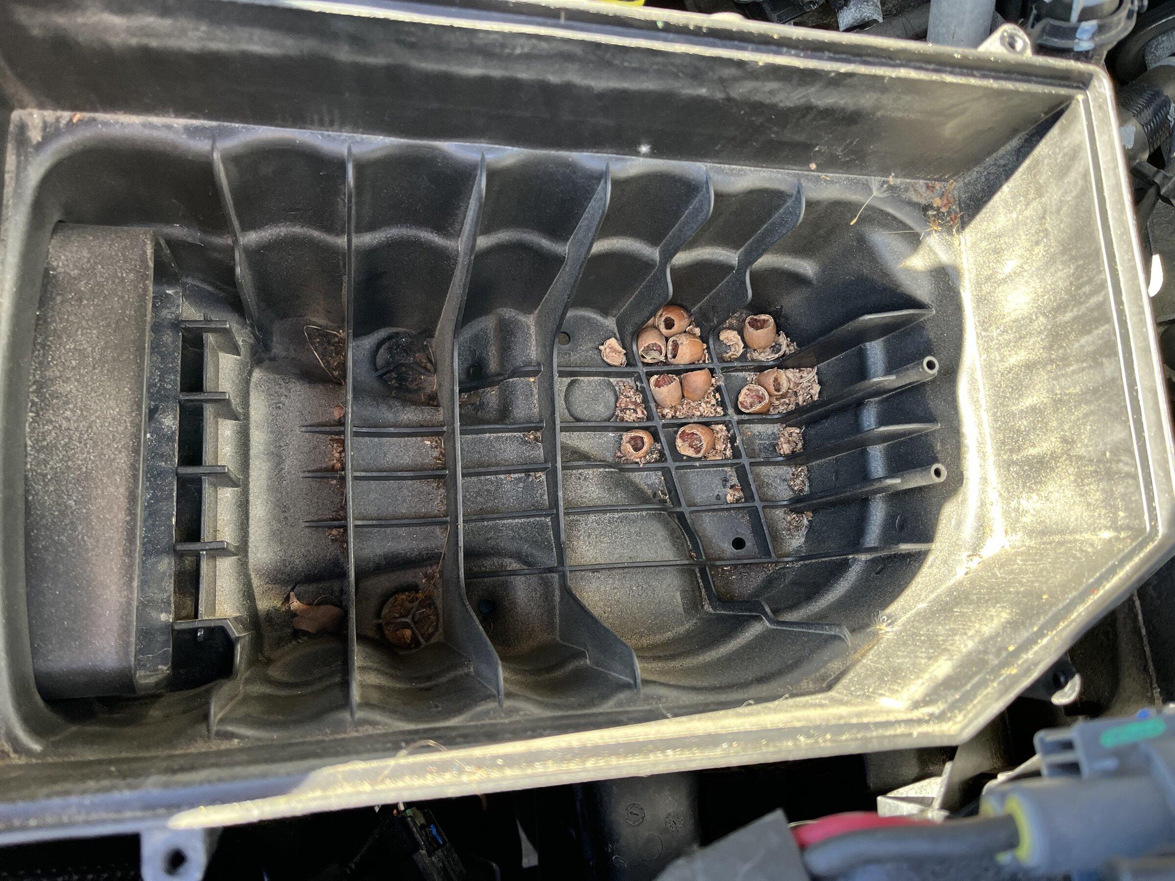

I just replaced my air cleaner on my
2020 jeep gladiator sport s. I found
acorns everywhere. My neighbor also
Had the same problem with his gladiator. Jeep needs to install screening to keep out the critters.

I need to check this. Thanks for the reminder. Haven't been driving her much his winter.
I hear peppermint spray keeps them away/out.

I have not had a problem with mice, chipmunks ate the engine cover on my wife's 13 Wrangler. Try using peppermint oil on a cotton ball place in the air filter box. It has worked in the past.

Thats pretty terrifying... hopefully you can take care of it before they start getting into those tasty wires

Install DIY screening over all openings with 1/4” hardware cloth (kind of a fine, stiff chicken wire)
I had a huge nest on top of the cabin air filter in a Tacoma. Installed a screen over the A/C intake in the engine bay, solved. Needs the same over the engine air intake if it’s not a daily driver

Yes. I've also had this problem with field mice getting in there in both my vehicles and chewing the wiring / building nests. I have two Toyota's and the rumor is the wiring insulation was somehow soy based. Peppermint oil essence oil ordered from Amazon or somewhere else diluted with water in a spray bottle works. Spray the engine compartment every 4 months or so. There are also devices that you can mount in the engine compartment that emit a noise and light to scare them off. Haven't tried the devices yet, but I do set traps when I see signs such as droppings in the engine compartment. Traps work as well as the peppermint oil and I can transport the cute critter out to release somewhere humanely for my kids sake.
Yes, hardware cloth is a cheap, easy thing to try, don't go anything less as mice will chew right through some metal stuff.
