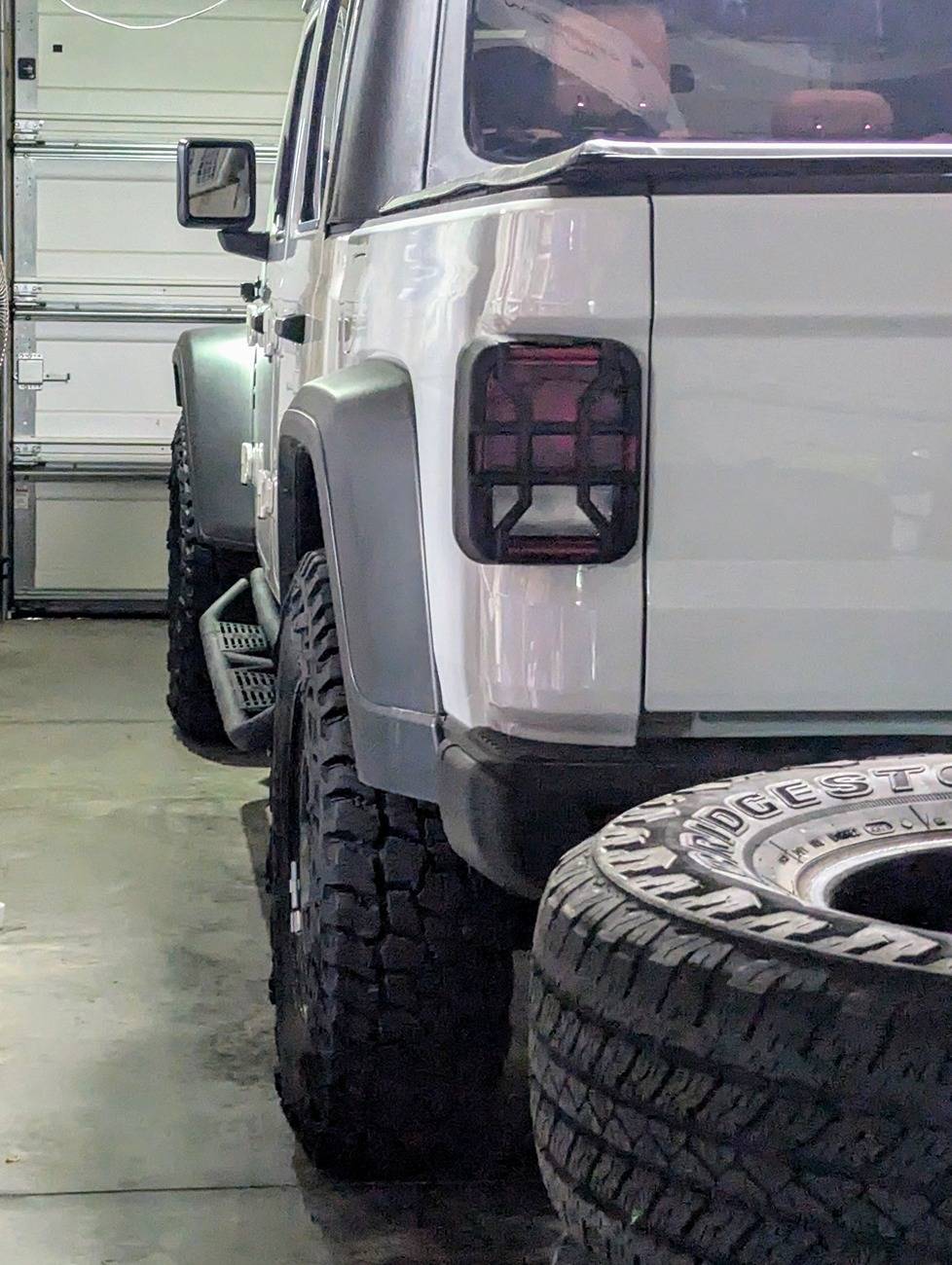

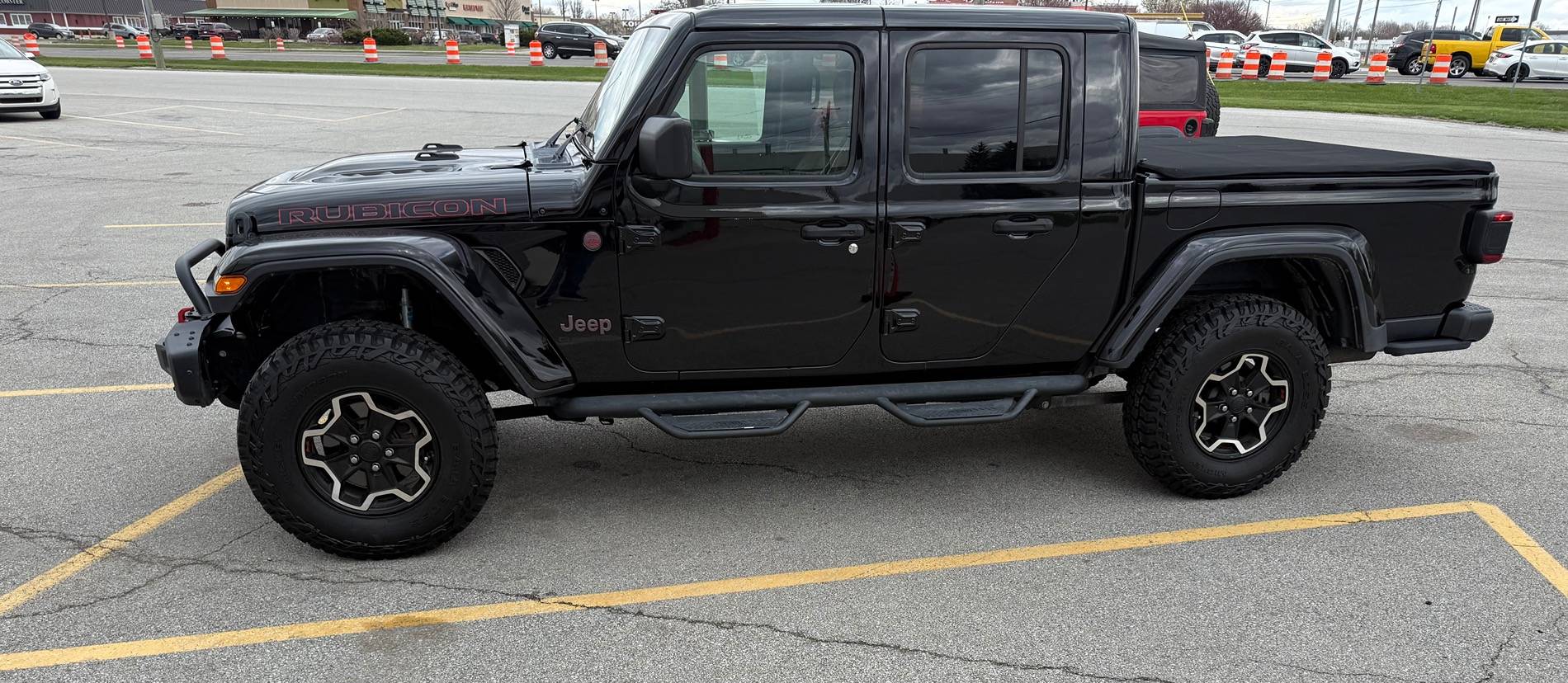

I choose these tires (Mickey Thompson Baja Boss A/T 255/85R/17) and have been running these for about six months. 100% happy with the choice. The tires are mounted on stock steel 17x7.5 rims, no spacers, and front-end 1.5" Teraflex leveler. The vehicle is a Sport with an automatic transmission, and non-TowMax (i.e., standard width Dana 44 axles.). I recalibrated the speedometer using a Tazer. The ride is no louder than the original A/T tires and the fuel mileage seems unaffected. Here is a pick of how these sit under the fenders, and another with the profile showing clearance and rake.

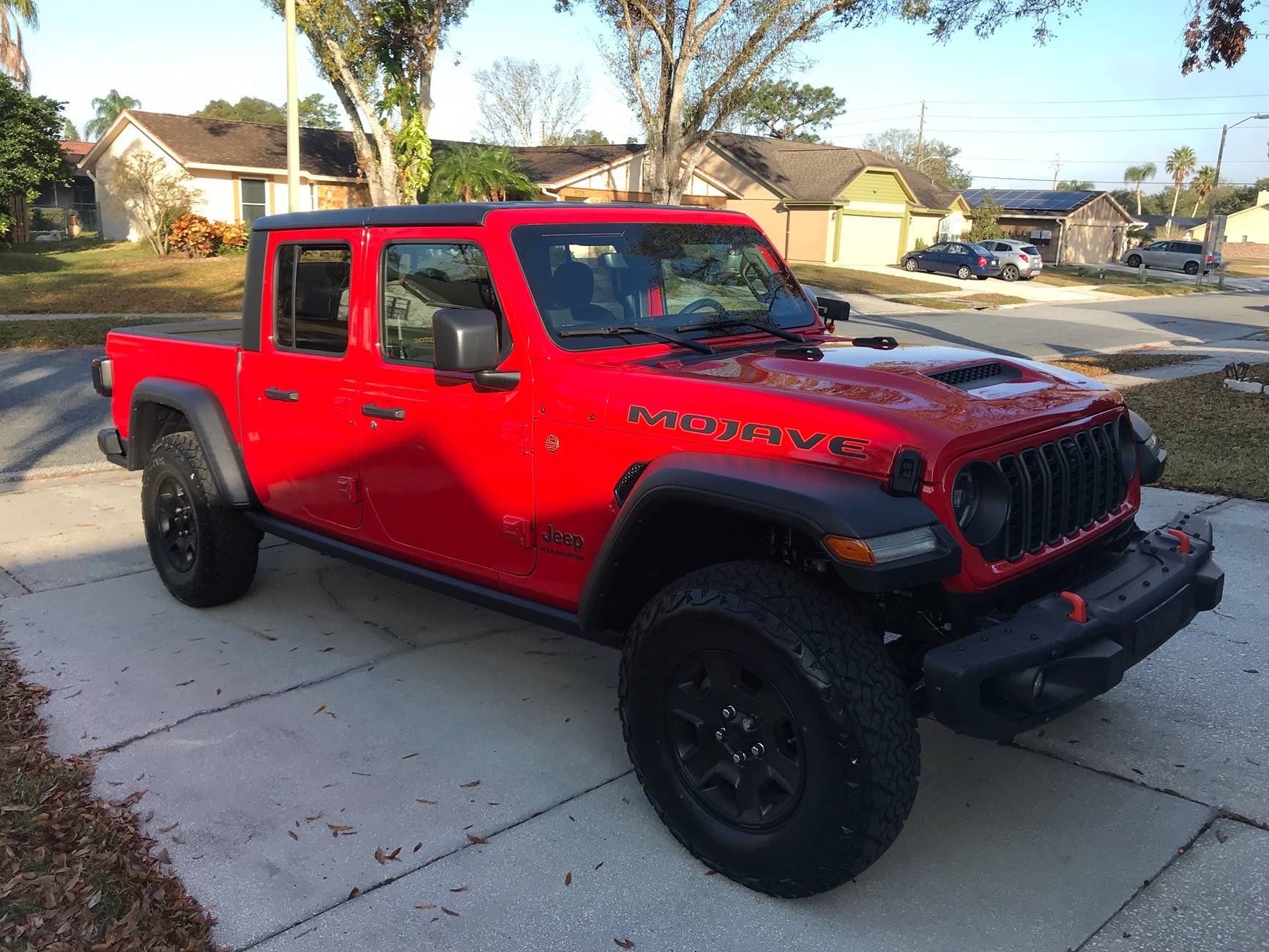

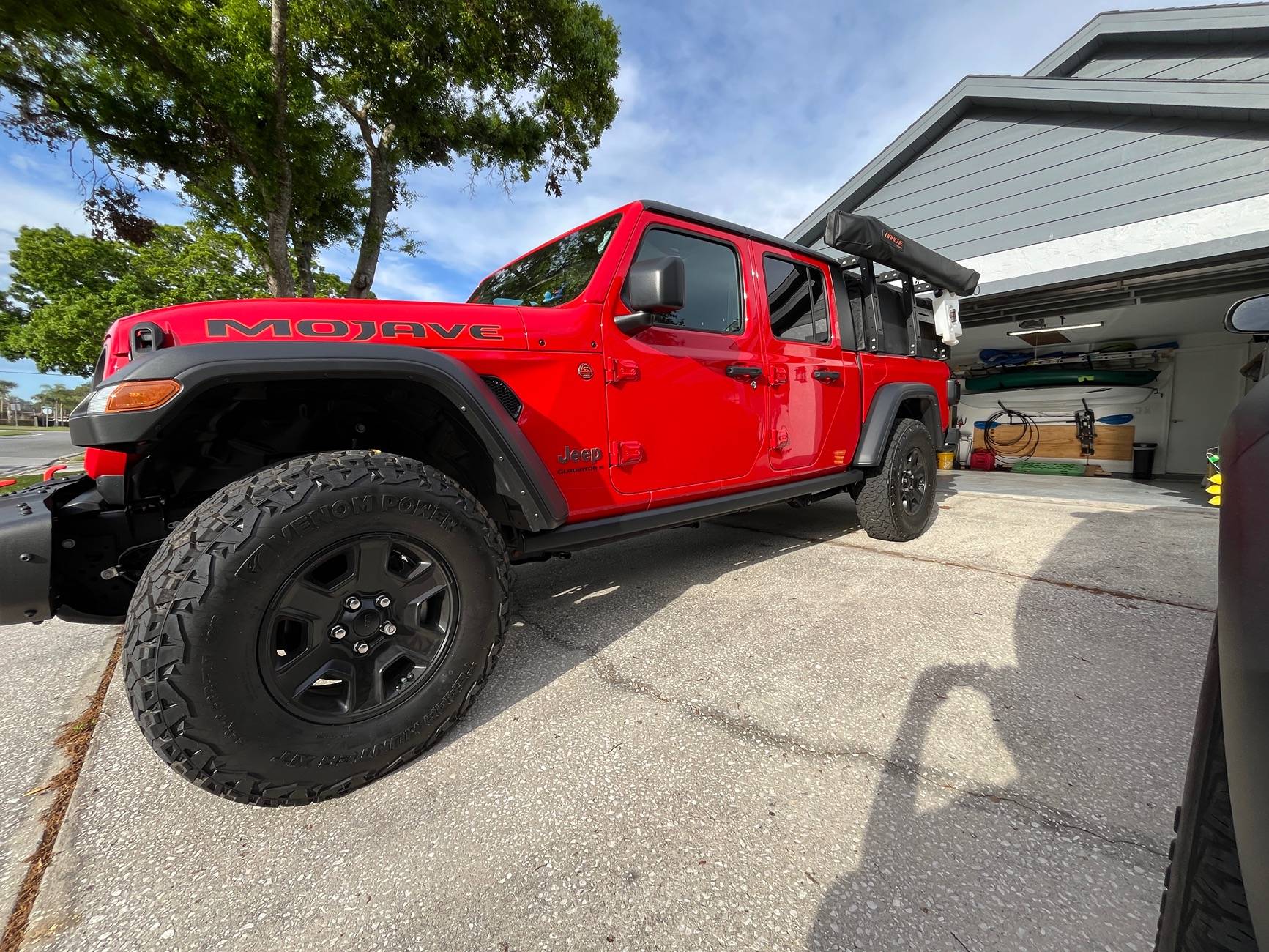

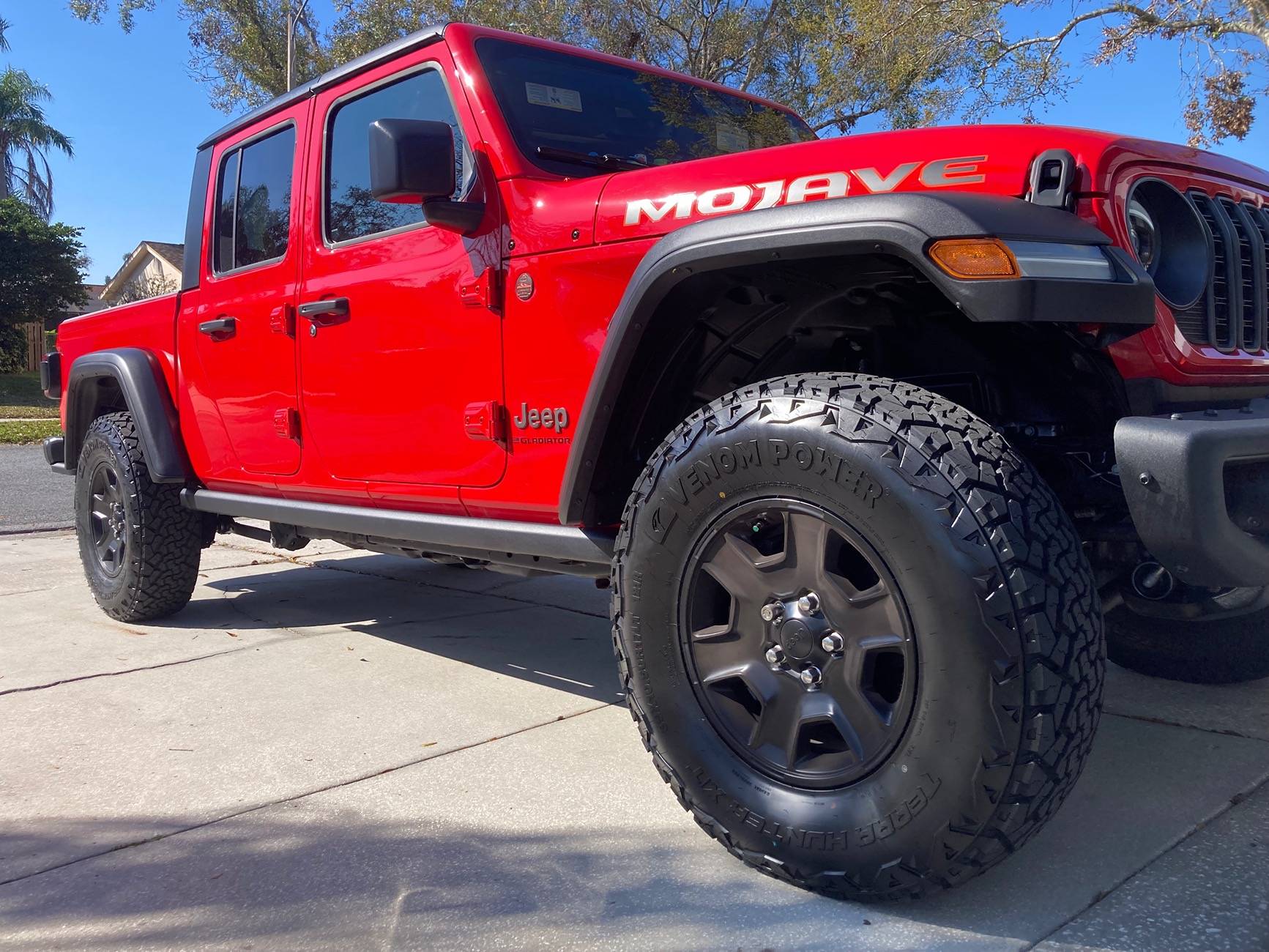

So I went with the Venom Power in 35/10.5/17’s on my new Mojave and love them. Much quieter than the Falken MT’s. Still haven’t got out to the Ocala NF to test them in the mud, but I like the way they ride and look

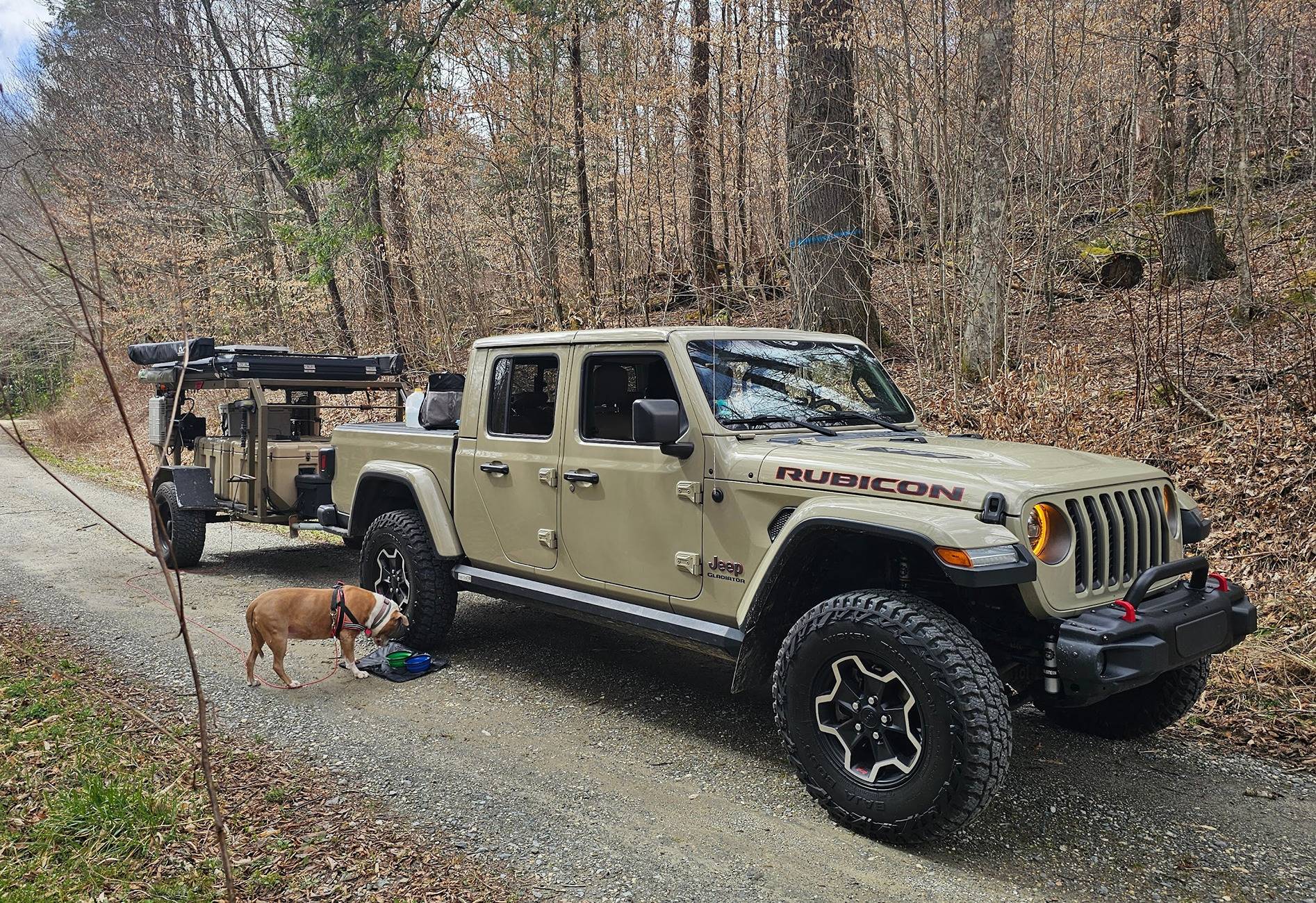

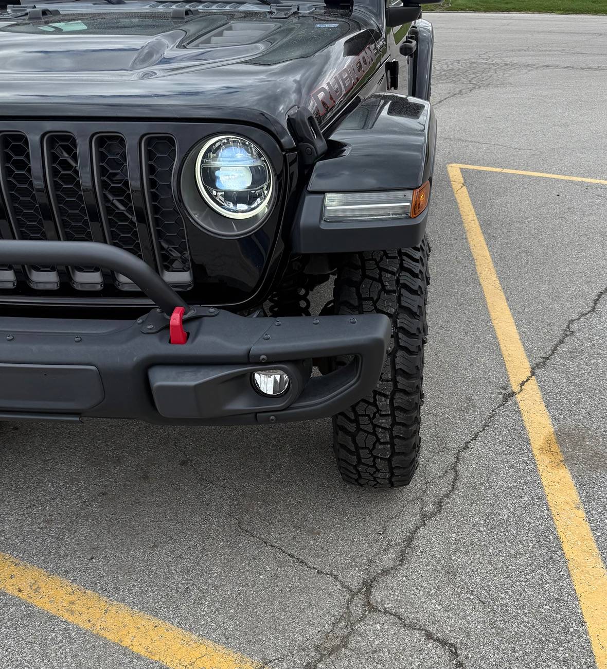

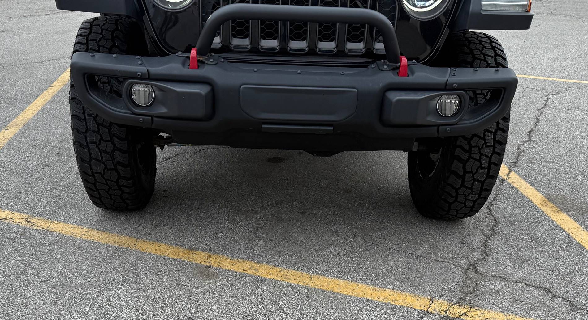

After reading the comments in this thread I decided to chance a set off the Baja Boss A/T's in 255/85/17. I had a set of Falken Wildpeak AT3W's that were likely take off's since I bought my truck last year used. I'm guessing they were about 1/3 recommended tread life left but I hadn't checked recently. I live in potholelandia AKA Indiana. My JTR rode really rough over the roads locally. Every bump was really noticeable. I ditched the worn out Fox shocks earlier this year and felt like the clown wagon floaty feel was much improved but the ride was still pretty harsh for anything longer than 30 minutes. So far, and it's only been a week, the steering feels more responsive and the potholes aren't as abusive on the spine.
I had no delusions my JTR was going to be luxury SUV level comfort but between the garbage ass fox shocks and Falken tires it was not pleasant to say the least. Admittedly at 49 yrs old my back prefers much more comfortable seating. The new tires do make a good amount of improvement to both the steering and the comfort level of the ride. I felt the Wildpeak's were leaving the steering feeling like it was just kinda loose even after getting the PSC big bore gearbox last year. Now the steering feels like you turn the steering wheel and it responds the way I think most people would agree is better.
When the truck hits a pot hole or rail road tracks or what have you it's still harsher than a luxury SUV but dialed down about 1/3 less than it was. So it's not like I am aiming for the rough patches it's just less grating when I can't avoid them.
Overall good feedback from all of you who have posted already and thanks for the reviews. I agree the Baja Boss A/T's in the narrow 35" height (255/85/27) are a good pick.
The tech at Discount Tire set them to 45 psi per tire and I'm wondering what other's have found to be a good psi to run them at on the road? I'm thinking I am going to try to run them at 40 psi and see if that feels a bit better in buttometer ride feel :)

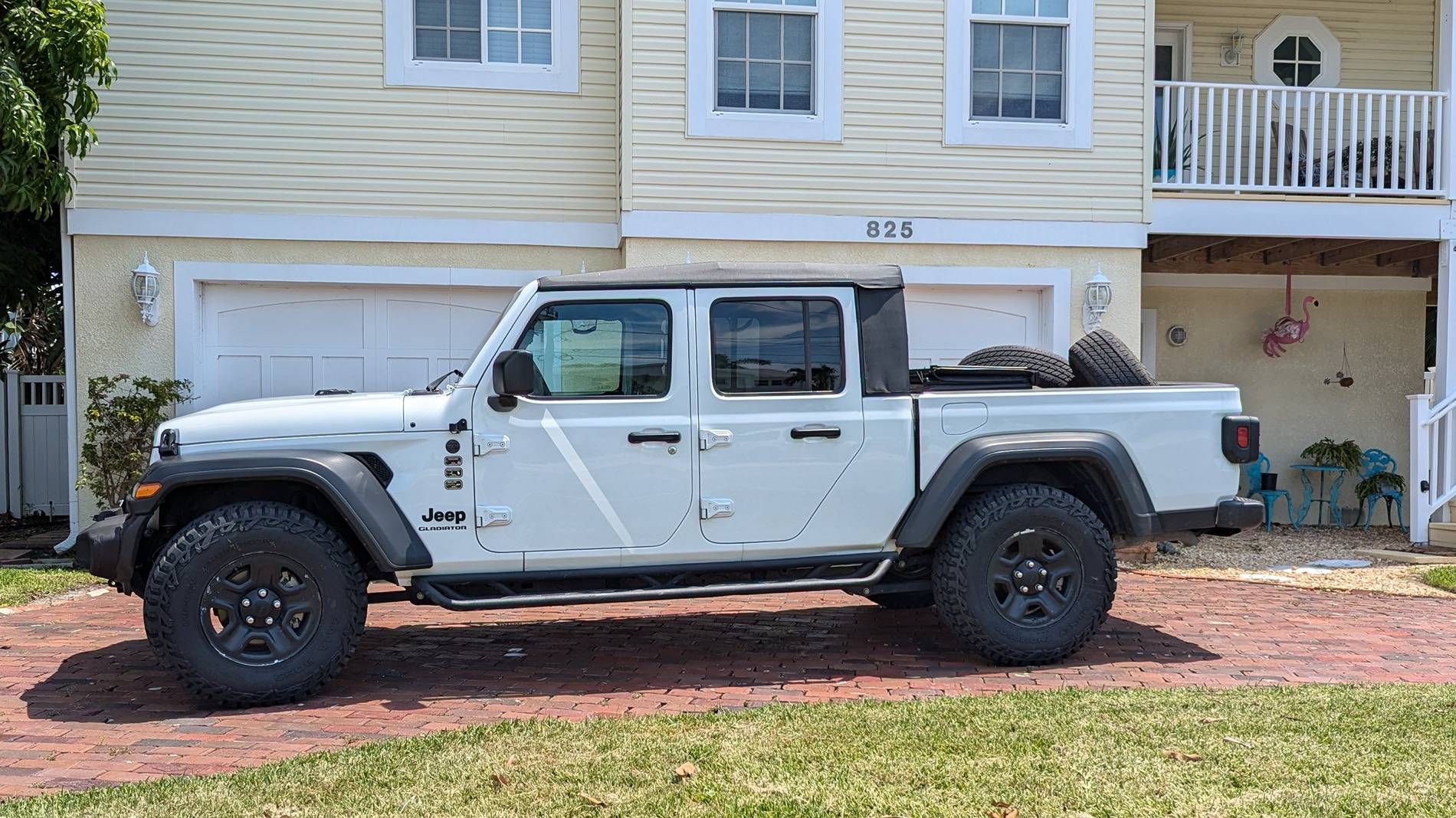

I recently got the falken at4w in a 35x11.5r17 so far I really like them. Was thinking about getting the Baja but they were a bit more expensive. If I go 37s I’ll probably get the Baja since they are the only ones I am aware of that have it in a 11.5 wide
