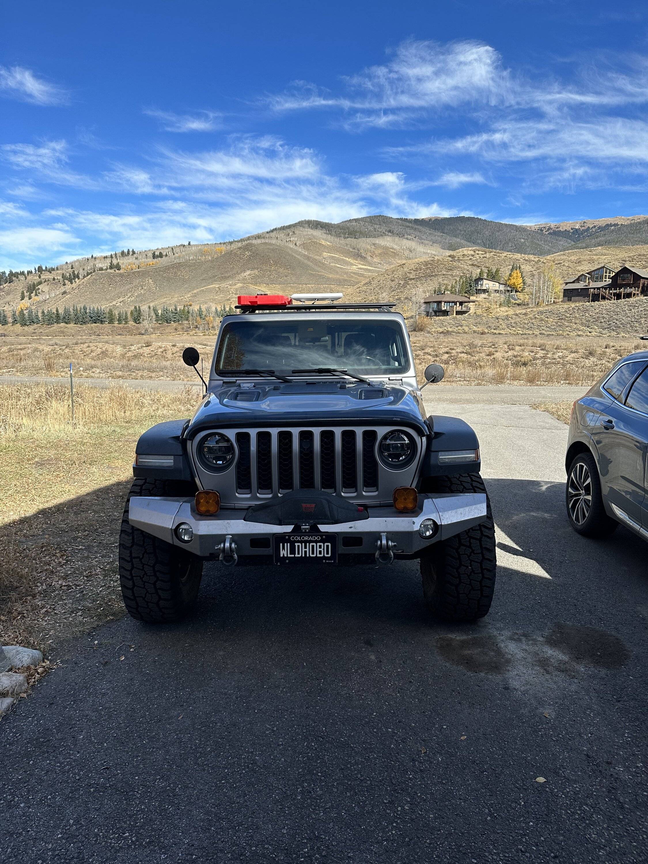

I had a shop weld more aluminum onto the passenger side rod. It turned out well. I haven’t tried them yet though, as it’s getting cold in the mountains. :(

I’ll throw it on the Jeep later and take a picture, granted with hard doors, but you’ll get the idea.
soft doors not on, but this is the Lange coyote I had extended.

That is exactly what is needed
Hilariously, the welding shop mod was more expensive than the mirrors. Oh well.

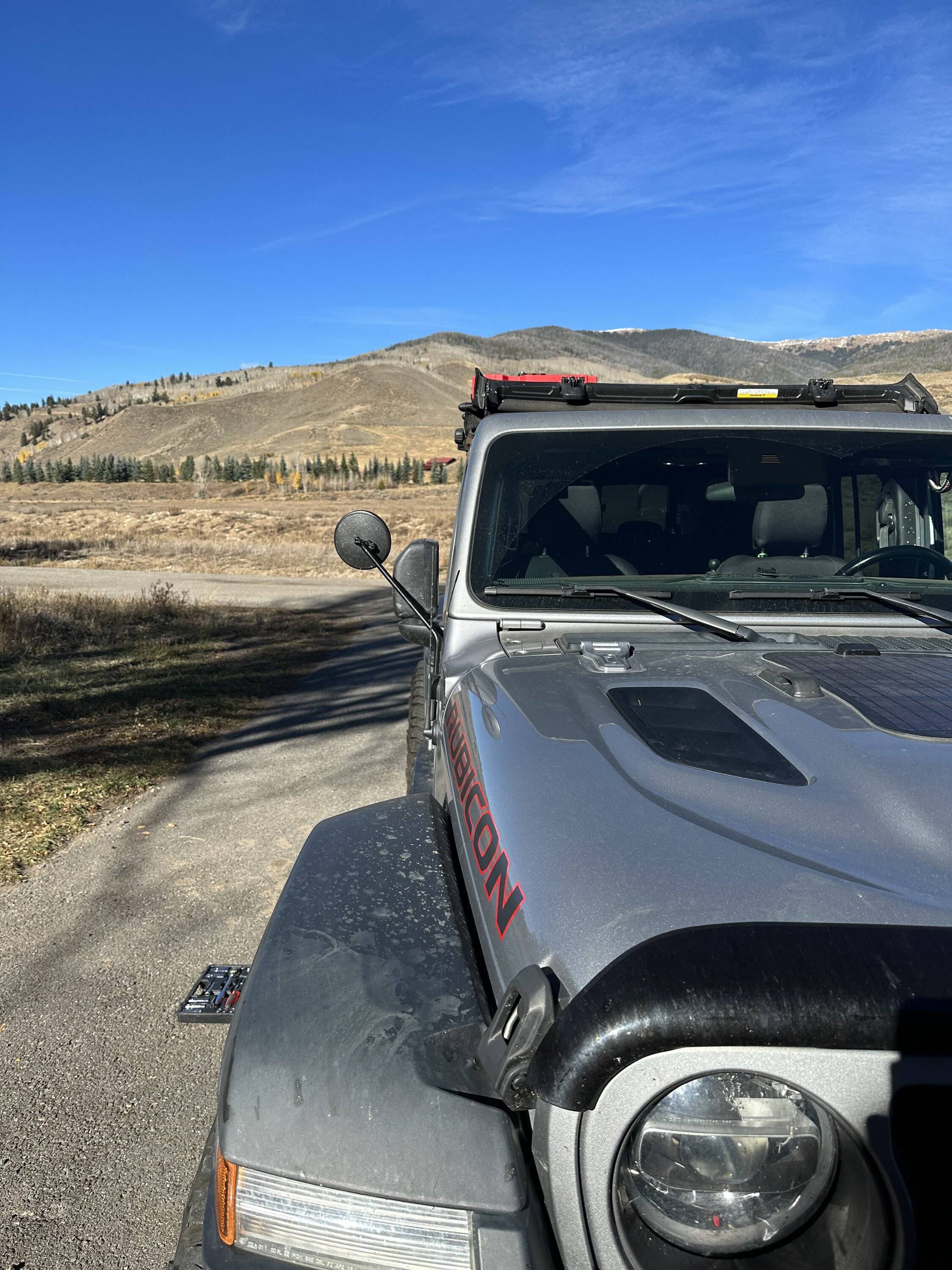

It’s confirmed that they work great. This might be the last weekend until spring for soft doors in the mountains, so I had to do the swap one more time. It’s not symmetrical obviously, but they work and I can see.

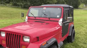

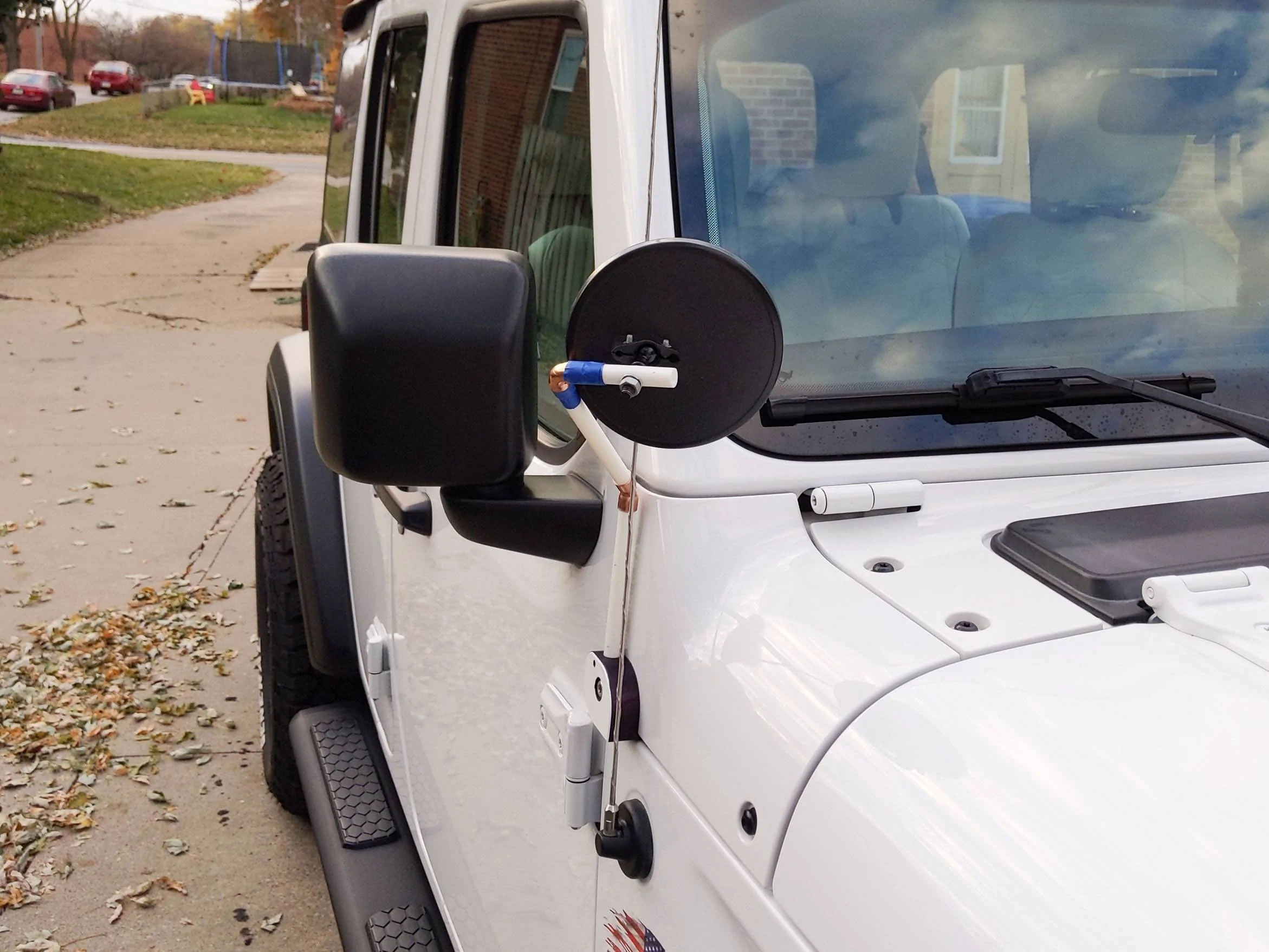

Reminds me of the YJ's non-symmetrical windsheild mounted mirrors where the passenger side mirror is viewed through the windsheild and not the passenger side door.
Jeep Gladiator Mirrors that work with Soft Doors 1697935469987
This is how I'll try to get my Lange mirrors to work.

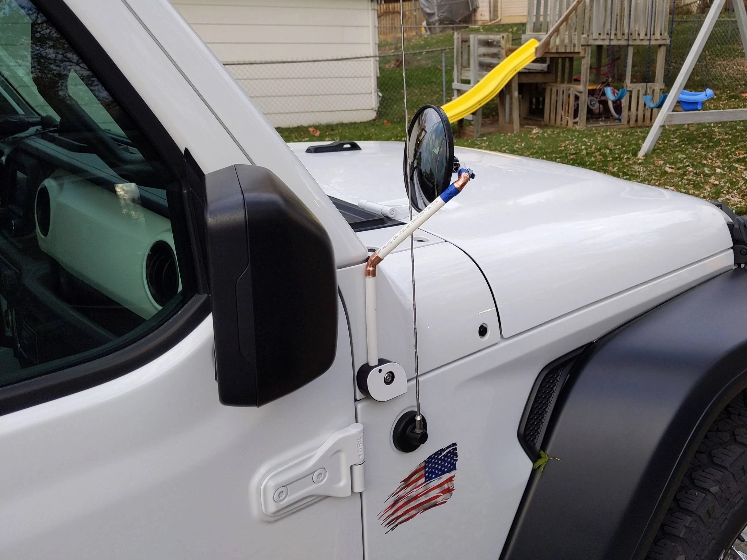

Due to some unseasonably warm weather, I was able to build a prototype of a view through the windshield passenger side mirror with some 3/8 tubing and copper fittings. Here's what I came up with.

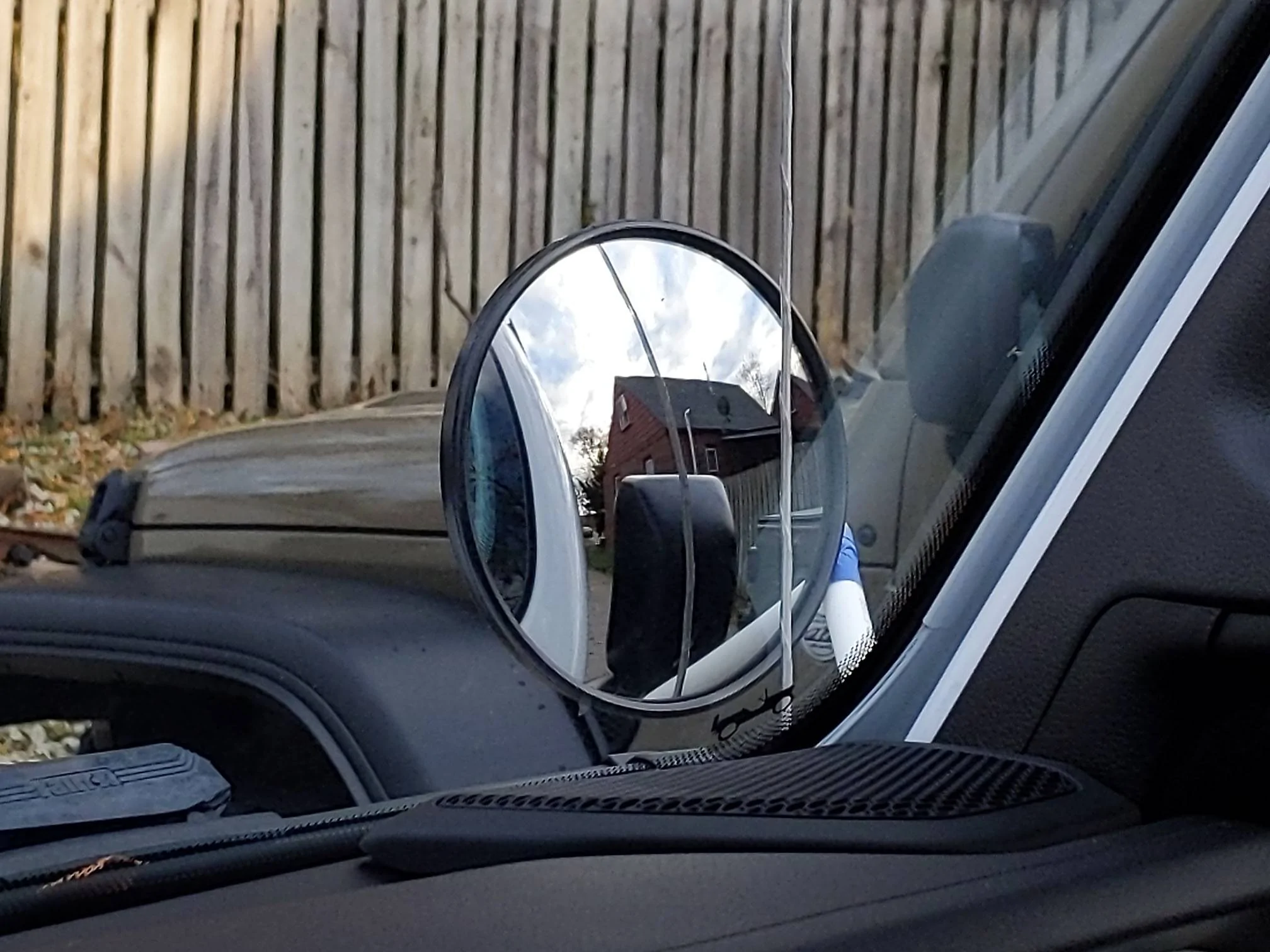

Here's the view through the windshield.
Jeep Gladiator Mirrors that work with Soft Doors lange custom 1
Here's a couple shots of what it looks like.
Jeep Gladiator Mirrors that work with Soft Doors lange custom 2
Jeep Gladiator Mirrors that work with Soft Doors lange custom 3
I forgot to mention I have 1/2" dia aluminum stock to replace the tubing once I get it dialed in.
