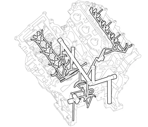

Oil evaporate away? Whew, hope not. That takes some serious heat, like over 270 degrees or better to start evaporating off the lighter parts.
These have oil up to the heads from the main oil gallery to the camshaft oil port, to the hydraulic lash adjusters and to the cam lobe spray nozzles. There's constant oil spray all over and around the cam, lash adjusters, lifters and thus, valves.
The valves get sprayed with oil constantly.
If there's not enough oil up there, something else will suffer first, IMO.
And, since these maintain the same oil pressure up through 3500 RPM and then kick it up, there's no difference in the oil pressure or flow idle to 3500 RPM.
This is really not something to worry about. I only brought it up because it is interesting. It is an exceedingly rare condition caused by extended periods of extremely light driving. It came up in a fun conversation about Pentastar quirks with my buddy who designed the gen 1 Pentastar. So everything I've said comes straight from him. He's still with Stellantis but has not done Pentastar design work since before the PUP version in the JL/JT came out. So there may be some differences in the valve train design. He is not 100% familiar with all the changes in this generation.
Oil will still have some evaporation at normal temps and a normal engine can have hot spots that easily hit the 260 degree mark where NOACK volitility is measured. Oil can be at 13% NOACK evaporation and still meet API SP/GF6. A high end oil like Mobil 1 EP is around 7 or 8% for NOACK. Most 0w20's will fall somewhere in between. (Dexos 1 Gen 2 also allows for up to around 13 or 14% evaporation, as well.) Remember, too, that this oil in the valve stems of the Pentastar is not circulating, but staying put in one place. So it does get hotter than oil that is circulating. But you'd have to drive it like a granny for a looooong time. He was warning against "granny cycling" the engine, which is what they call it. If you punch it now and then, no worries. It doesn't take much to splash the tiny amount of oil up in there that is needed to keep things lubricated.
He told me they had seen a couple of extreme cases and actually created what they call the "granny cycle" test to see what was going on. The good news is that again, you'd have to drive it like grandma for a very, very, long time for the oil to go away. BUT, if you do that, you will ultimately get excessive wear on the valve stems. The other good news is that it is an extremely rare condition. I think my Aunt Birtha would be the only one I know that could subject a Pentastar to that issue. She never drove more than 20mph and only to and from the grocery and church, Lol.
His point wasn't really to warn about this, as it is rare and unusual. His point was to tell me that the Pentastar likes to be run hard and that this is good for it. And by punch it, he means floor it and run it into high rpms, which is where you'll see the higher oil pressures. It'll splash right up in there if even at higher pressure for only a second or two. It doesn't take much.
He has a Chrysler 300 with somewhere around 200k on it by now, btw. He is running it until it croaks. He thinks it will go 500k, at least. He's running 5w20 Pennzoil Platinum or Mobil 1 and Mopar filters in it with 7,000 mile oil changes. And he said he has run it hard since new and that it runs perfectly.
