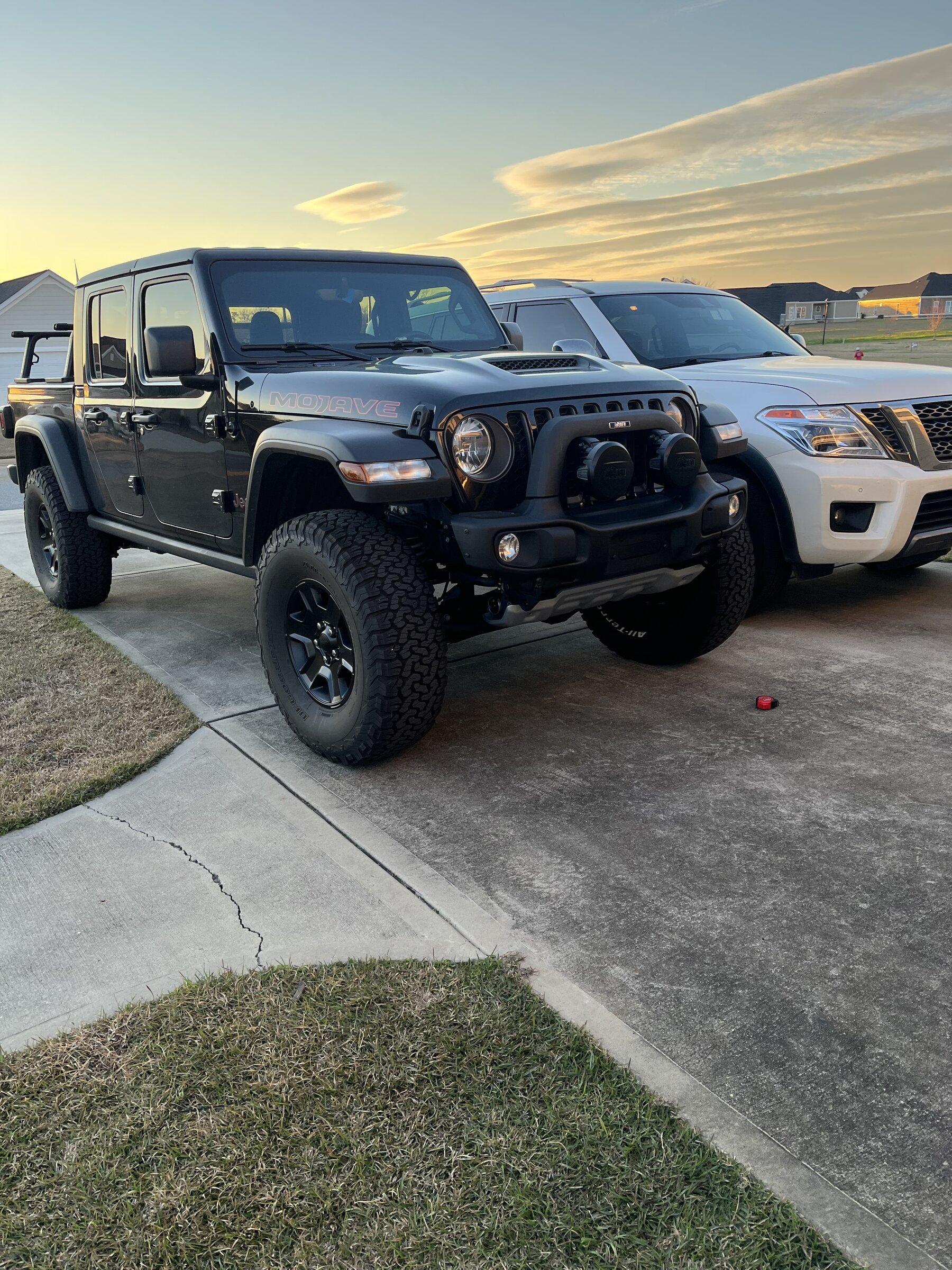

I have an extra set of those Baja lights and the arcus. Did you just drill a couple of holes? Anything special about mounting?
Yeah just drilled a couple holes and It worked well. Not very thick metal, just measured in a flat spot where I wanted the lights and used a titanium drill bit to poke through.

Is that the Arcus up front? Also are you running a lift?
Yes that's an arcus bumper. The lift is the AEV 2in spacer kit for the Mojave. Just lifts it up a little bit while still maintaining the original premium suspension. Still feels stock but has a little bit more clearance and looks great imo. With the tires and the spacers it sits pretty high, so I'm probably going to install some amp powersteps xl.

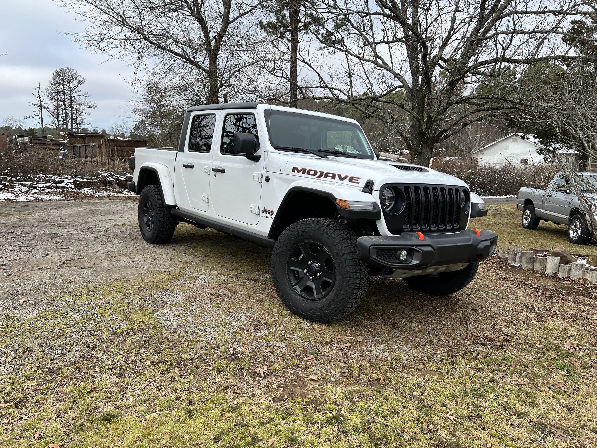

It took 7 hours but finally got the bumper on.
FYI- if anyone decided to purchase an AEV bumper , the aev skid plate is not compatible with a Mojave due to the shock reservoir being attached to the compatibility beam. I did manage to get the original skid plate attached though.
They are working on a different attachment for the Mojave per AEV rep.

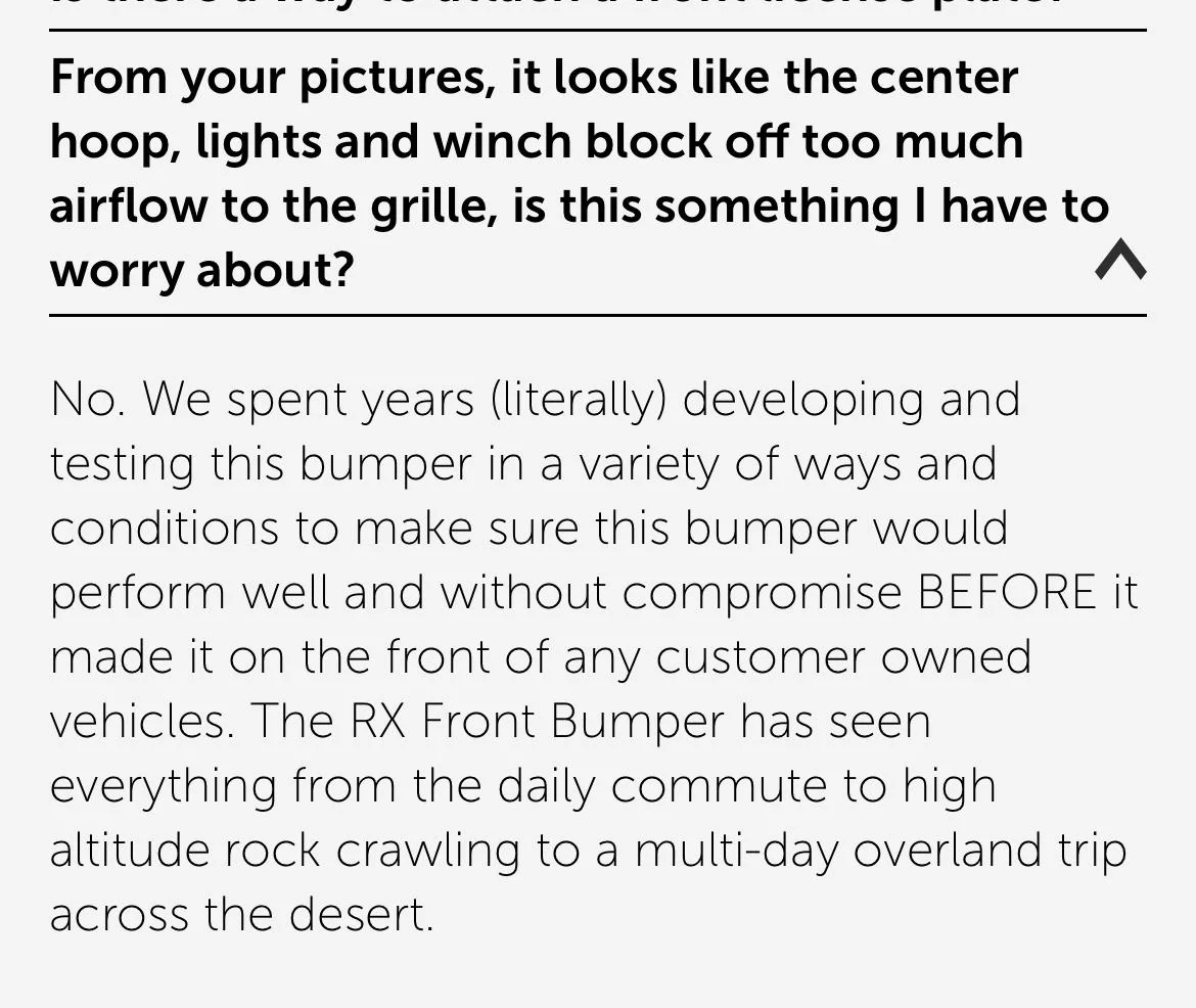

Nice bumper, seems like you are blocking a lot of airflow.

That looks awesome.

Is the arcus front bumper compatible with the Mojave skid plate? Any modifications needed?
