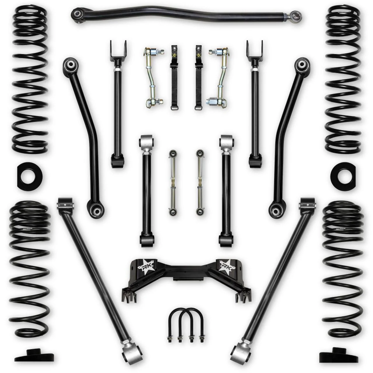

3" RK kit with Metal Cloak shock spacers keeping factory Fox shocks. Ride is great!
Awesome setup! You could just sell me yours! :)
Could you possibly share some more details on the lift? I've only read about the AEV
