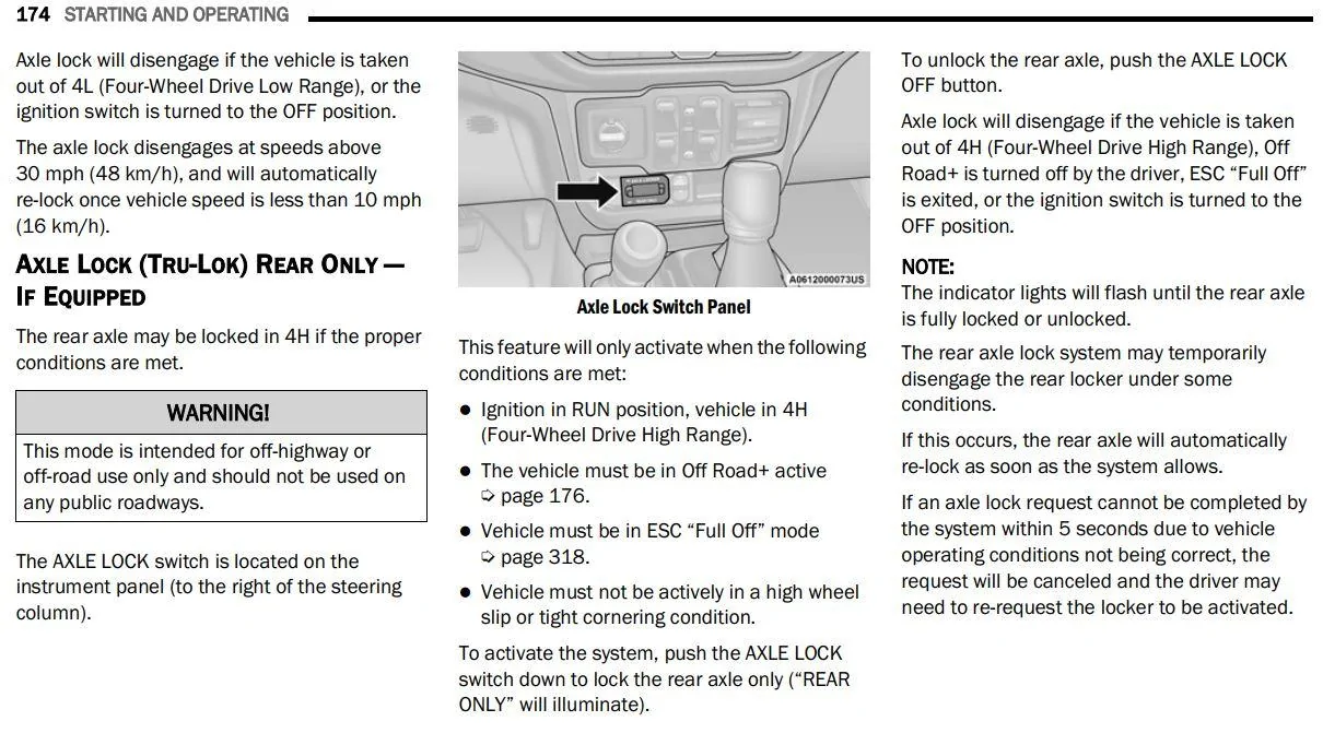

Good video, but he is wrong about the locker in 4H not being available in the Rubicon.
will the locker work in 4Hi on the 2021 Rubicon. Where did u find this info?
