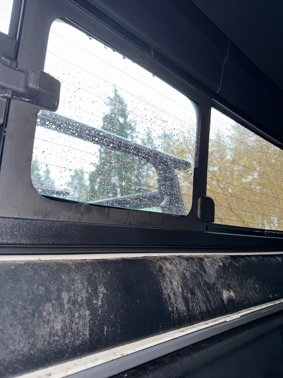

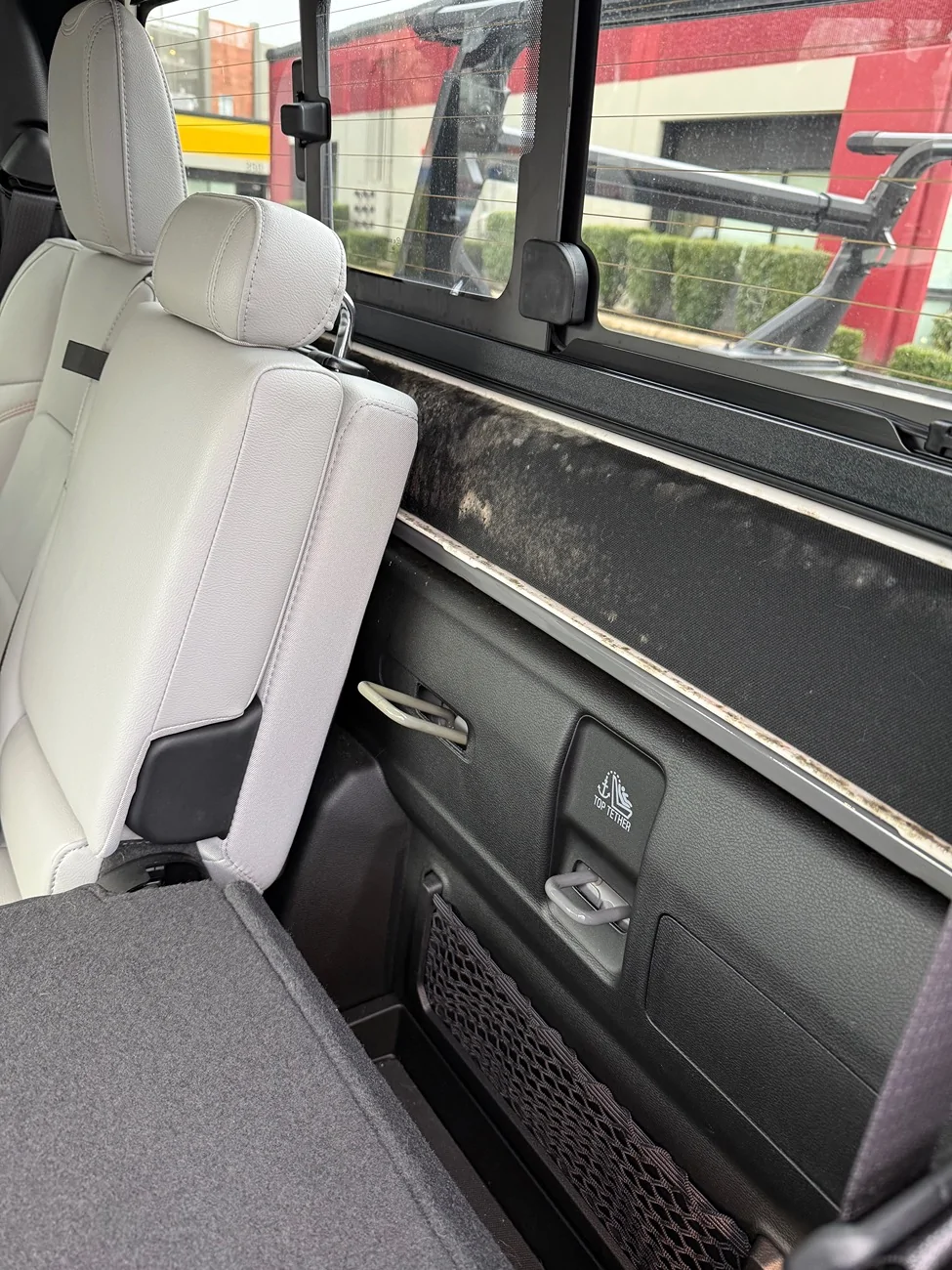

I’ve had my 23 Gladiator since I bought it new in November 2023. I drive it at least 4 days a week to work. In Jan 2026 I dropped it off at the Jeep Dealership for repairs and it took them a few weeks, mostly sitting on the lot for ordered parts, and when I got it back, it had a bad smell. I thought it might have been due to my gym bag I had left in the back seat and that with some deoderizers and cleaning, the smell would come out. It didn’t really hit me until later that my gym bag was clean with fresh clothes and itself doesn’t stink.
I clean the interior often and it’s very clean, but I’ve been stumped what’s going on and was going to paid for detailing. A buddy who owns a wrangler said he has heard something about gladiators having a bad cabin seal or moisture intrusion and that I should look harder for mold, especially since we live in Washington.
Well… found this today. What the hell do I do?! This is the back speaker - even if I managed to somehow clean this thoroughly, I can’t imagine there isn’t mold behind the fabric or spores throughout the whole cabin. Are my speakers ruined? Also, if this is par for the course because I live in the PNW… I might have to turn it in. I’ve never taken the back panel off yet… not once. I don’t have a clue how this could have happened :crying:

Did it smell prior to being at the dealership and just get worse when you picked it up? or is the smell completely new?
If new, maybe something happened at the dealership - for example windows left open in the rain, etc… and then water sitting in the floor pans.
I would check the carpets and under the carpets for moisture/mold.
Clean up as much as you can.
Air it out in a garage or on a nice sunny day.
If still having issues - get the interior detailed professionally.

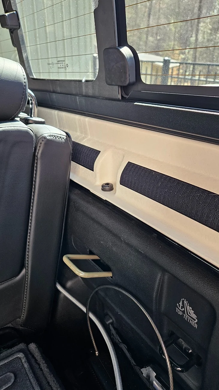

That's not a speaker. It is a piece of fabric attached with velcro. Take it out and throw it away unless you want to clean it and reattach it.
You obviohsly have never removed the hard top. Here is mine.

It’s the rear window seal. I had a 2020 Gladiator in Oregon and had to have the rear window replaced under warranty. I would imagine the carpets under your seats have mold as well. All of mine had to be replaced.
I don’t have the truck anymore, but I always felt like it still leaked even after the replacement, but I parked it in the garage and didn’t notice it as much after that was done.

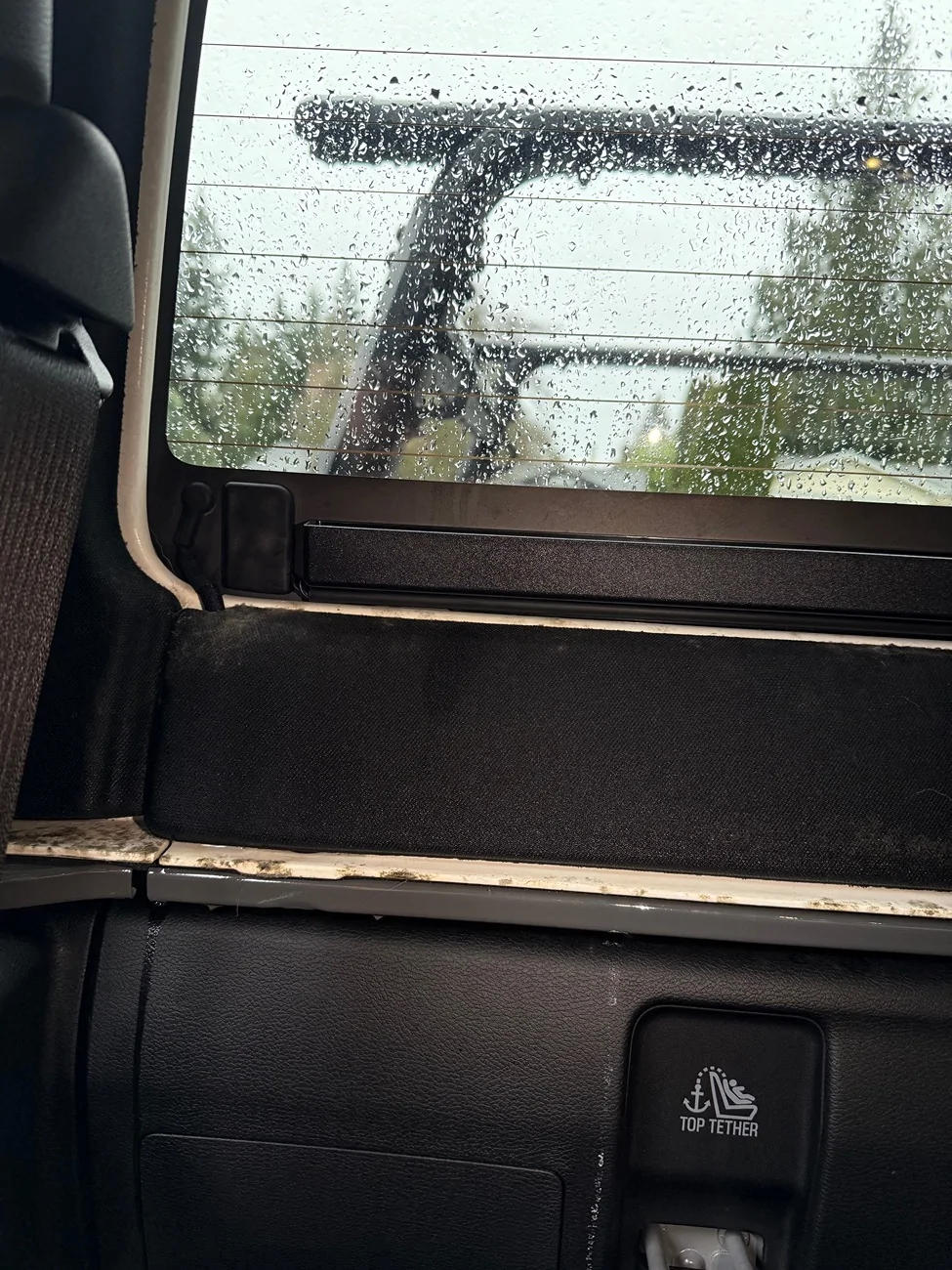

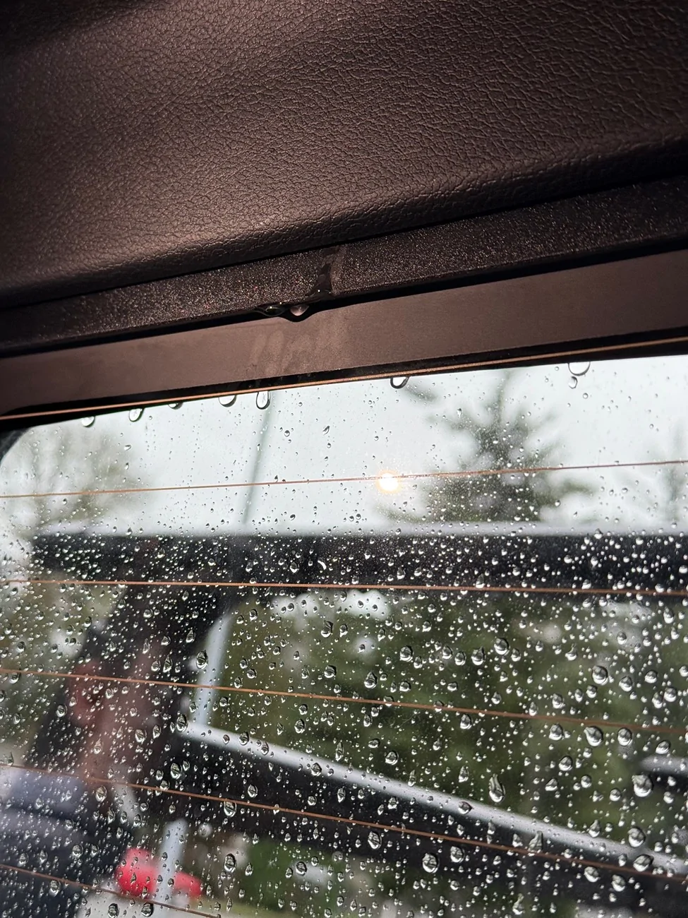

Well I found the problem as suspected - leak in the window seal. At multiple spots. It is lightly raining today and I clocked a drip rate of one water droplet per 30 seconds. You can see at one specific spot where the water drop constantly drips because no mold forms there (from the activity) but mold surrounds that area.
. I
I had mine replaced using my auto glass warranty.

Sorry Protons,
I’ve had the Northwest drizzle leak cause the rear window to get mold in my Gladdy as well. Luckily my drip was so bad and fast, it molded the carpet thus cleanup was only ArmorLite & bleach mixture on the metal to resolve the smell.
The window, I had fixed at the dealership once, but the leak came back worse. I tried the 7mm hose fixes prevalent on the forum, but the fixed rear window was so poorly done the gap was too big. My only solution was an amazon gasket. Not a drip since.
