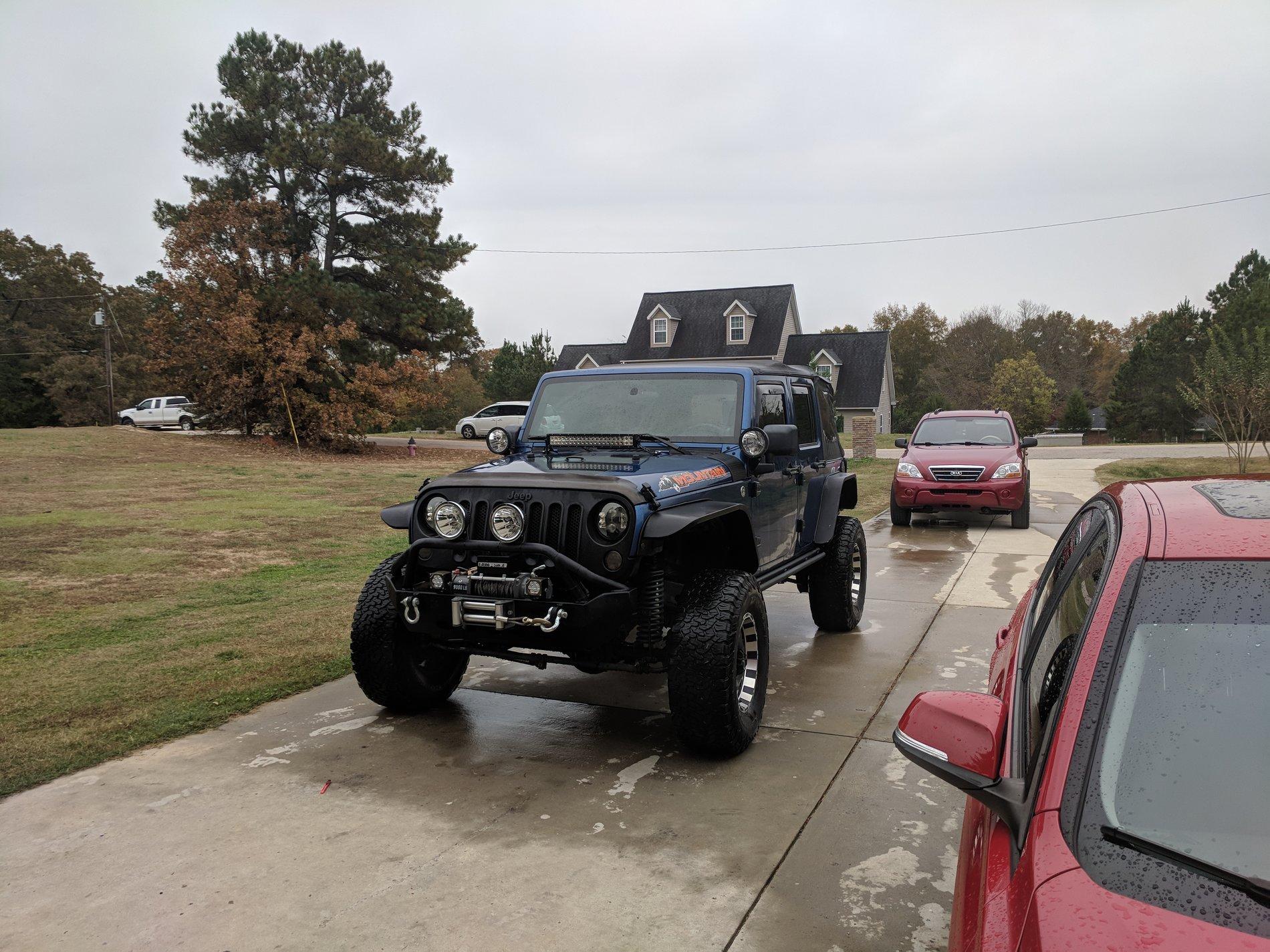

You don't need a adjustable Trackbar with 2" of lift only if you go over 2.5" of lift and really I wouldn't do it unless you get over 3". I got 2.5" ReadyLift SST lift kit on mine with Rubicon take off springs in the front so I'm sitting probably right at 3" of lift on the front of mine and have the Max tow springs on the rear with 2" spacer. My Jeep axle is not even a 1/4" off from side to side.
The adjustment Trackbar recenters the axle because as you go up in lifts the axle gets pushed out to one side throwing it off, but with a 2" mopar lift I wouldn't even bother. Some people just like throwing parts at stuff and claim factory parts are garbage and this and that. On my JKU I ran the stock ball joints and Trackbar for 115,000 miles and beat the heck out of it, never had a issue until the ball joints finally went out at around 115,000 miles and I got DW and got them replaced with guess what $59 stock ball joints I got online. Put another 17,000 miles on those before I finally sold it and bought the JT. I did end up getting a adjustable track bar when I replace my ball joints just because I was under there and decided to do it. That stock trackbar I took off is currently riding under my buddies JKU with another 30,000+ miles on it. For reference this is how my JKU set for 100,000 miles of those 115,000 miles
Jeep Gladiator Mopar 2 inch lift quote IMG_20171112_150748
