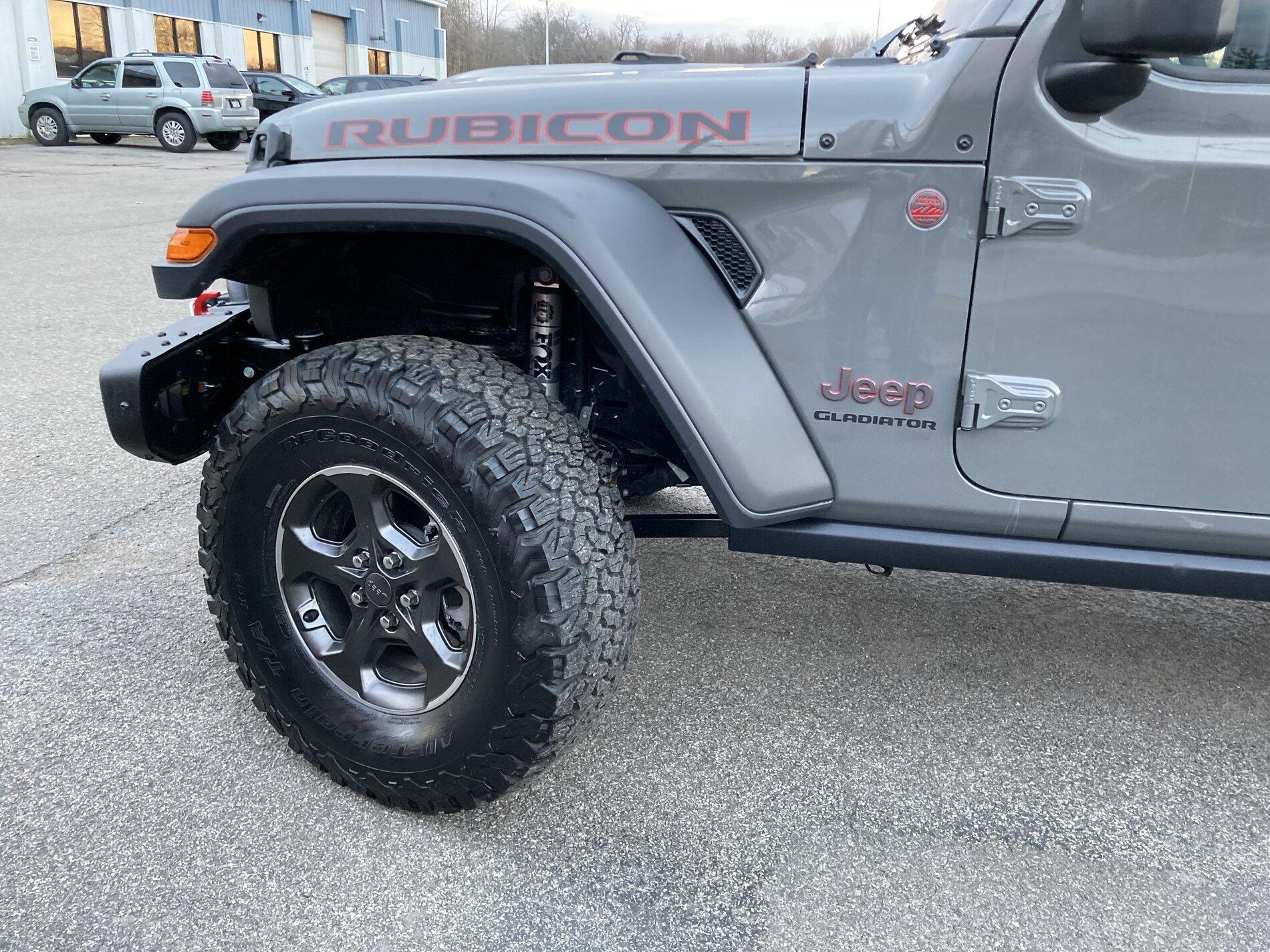

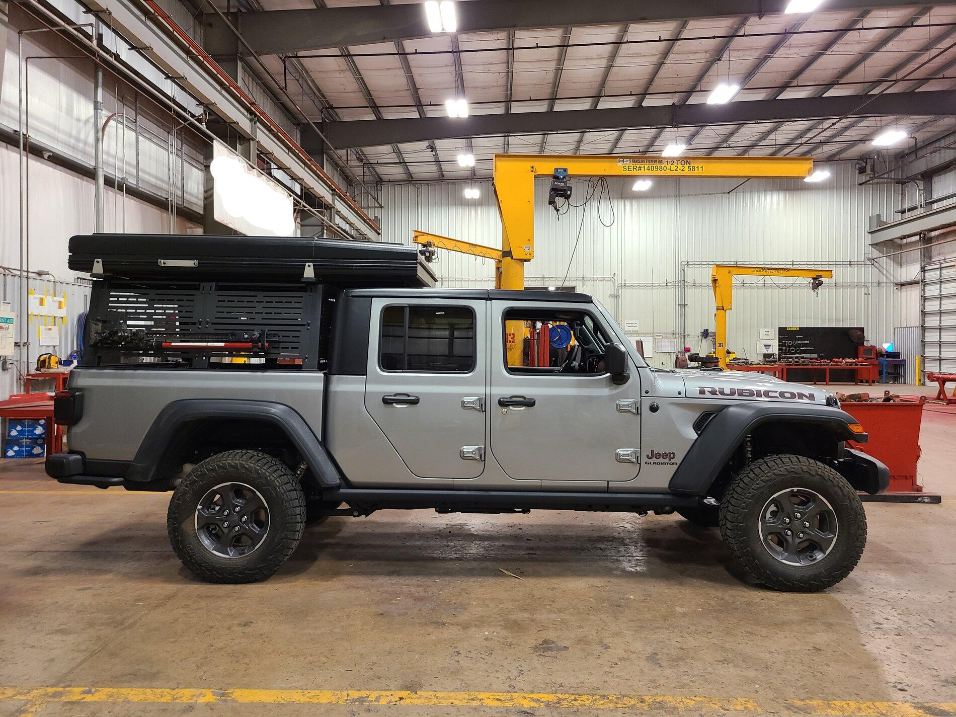

Here you go! Picture is with jeep parked at 1°/1° so it may look a little bit off
Also, here are my before/after numbers
Ground to mirror driver-- 49.75
Ground to mirror pass-- 49.5
Ground to front bumper-- 19.5
Ground to rear bumper-- 19.25
Ground to rock rail driver-- 17
Ground to rock rail pass-- 16.75
Hub to flare front driver-- 24
Hub to flare front pass-- 23.5
Hub to flare rear driver-- 23.5
Hub to flare rear pass-- 23.25
Ground to mirror driver-- 52
Ground to mirror pass-- 51.75
Ground to front bumper-- 21.75
Ground to rear bumper-- 21.5
Ground to rock rail driver-- 19
Ground to rock rail pass-- 19
Hub to flare front driver-- 26.75
Hub to flare front pass-- 26
Hub to flare rear driver-- 25.75
Hub to flare rear pass-- 25.75

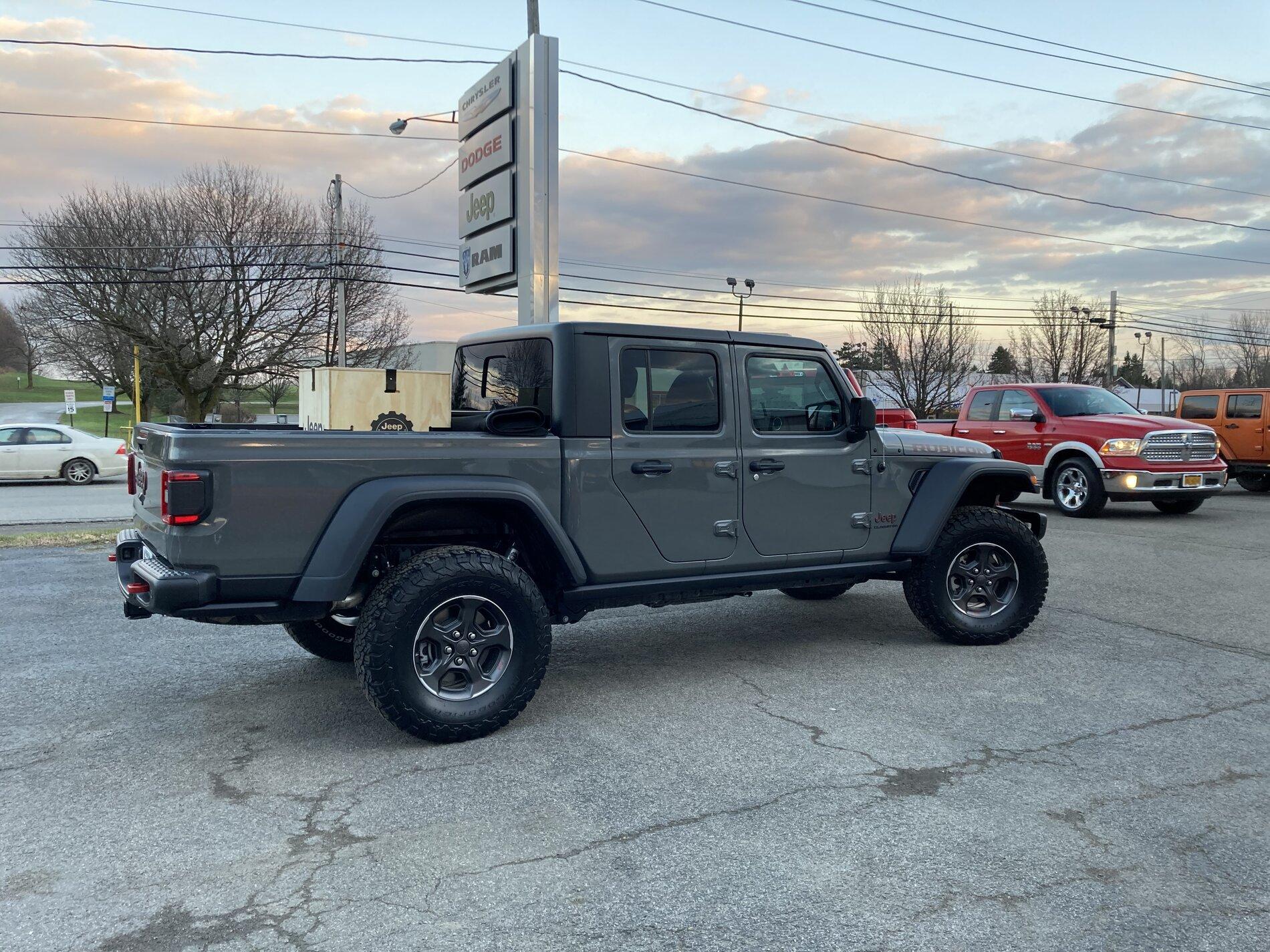

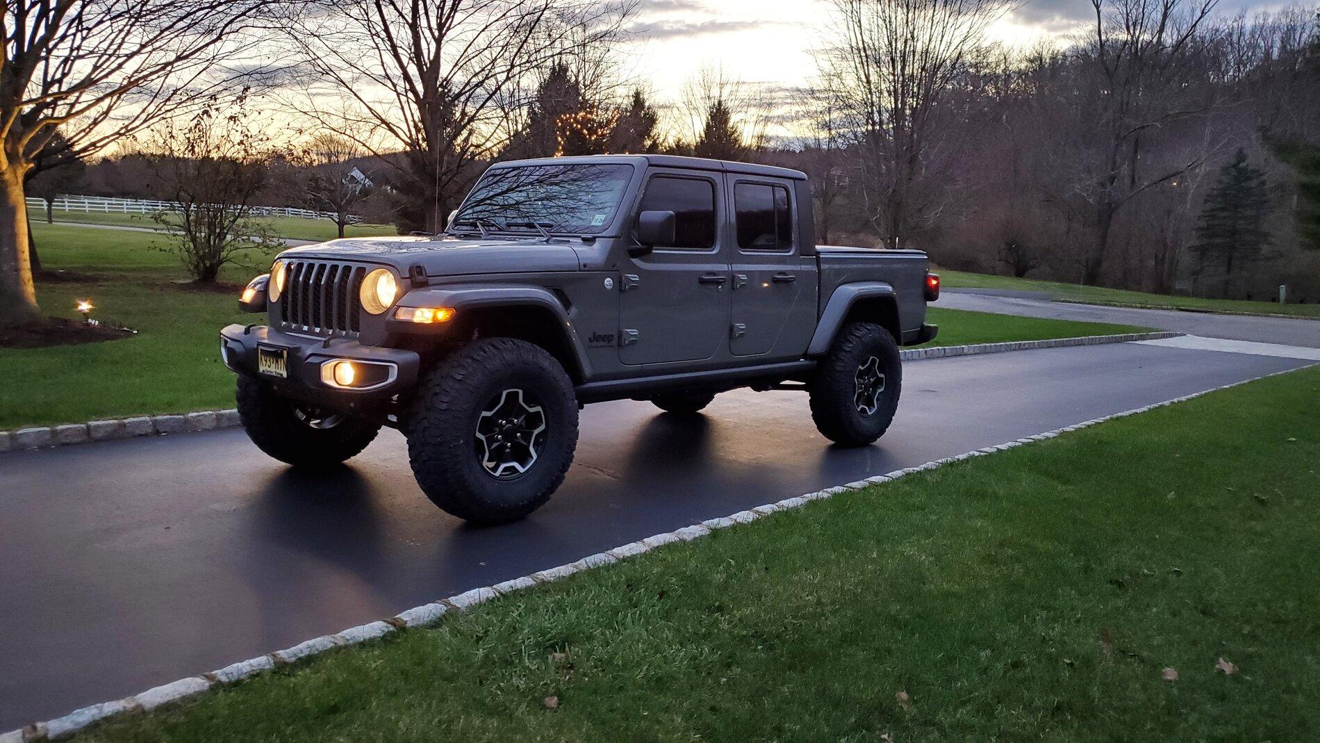

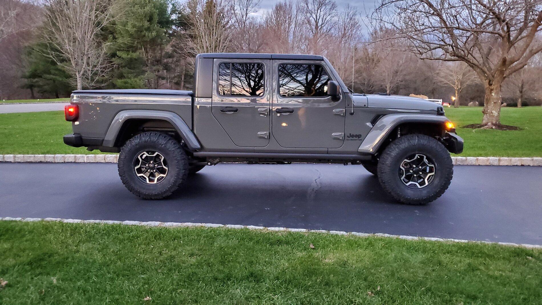

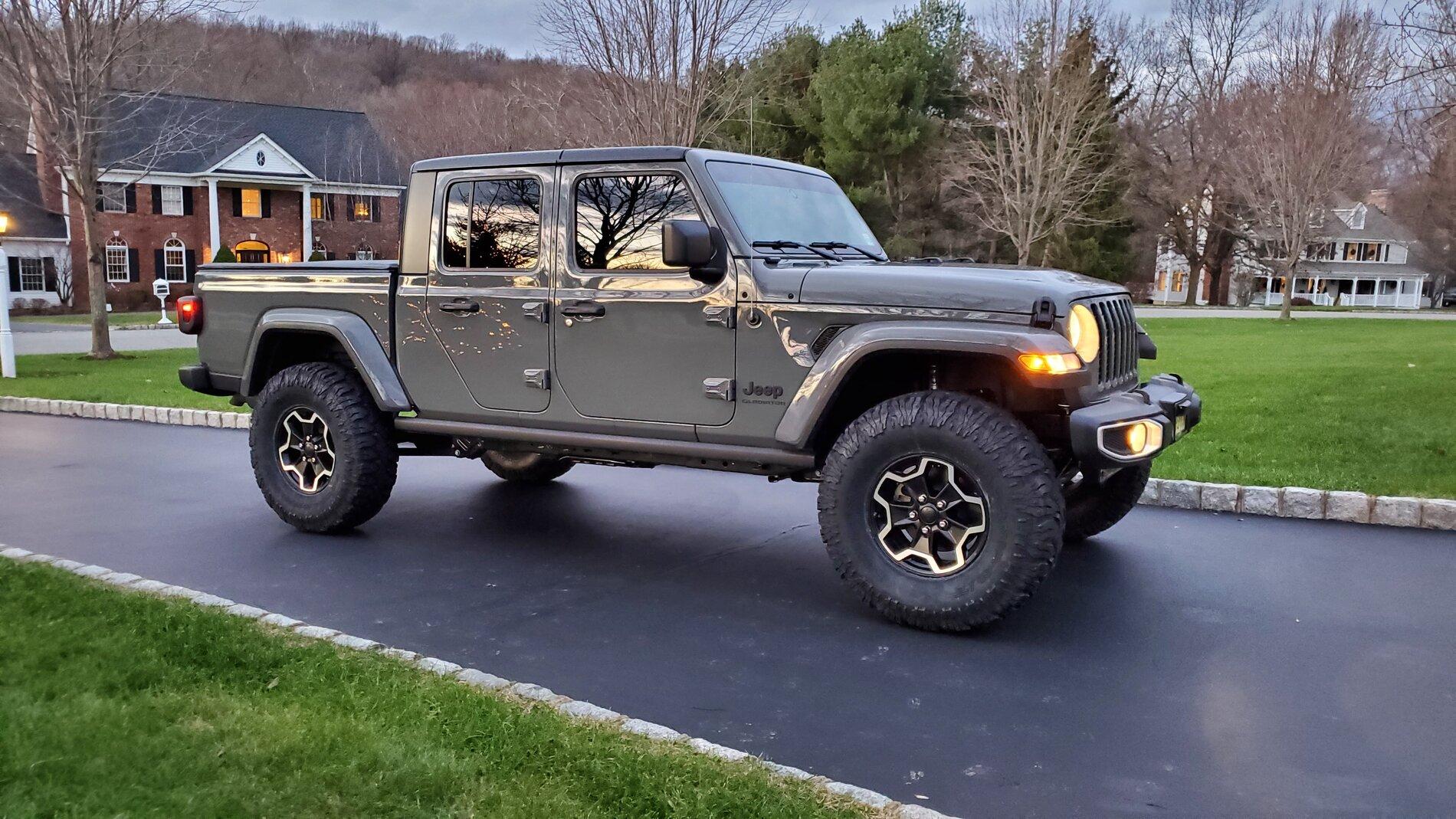

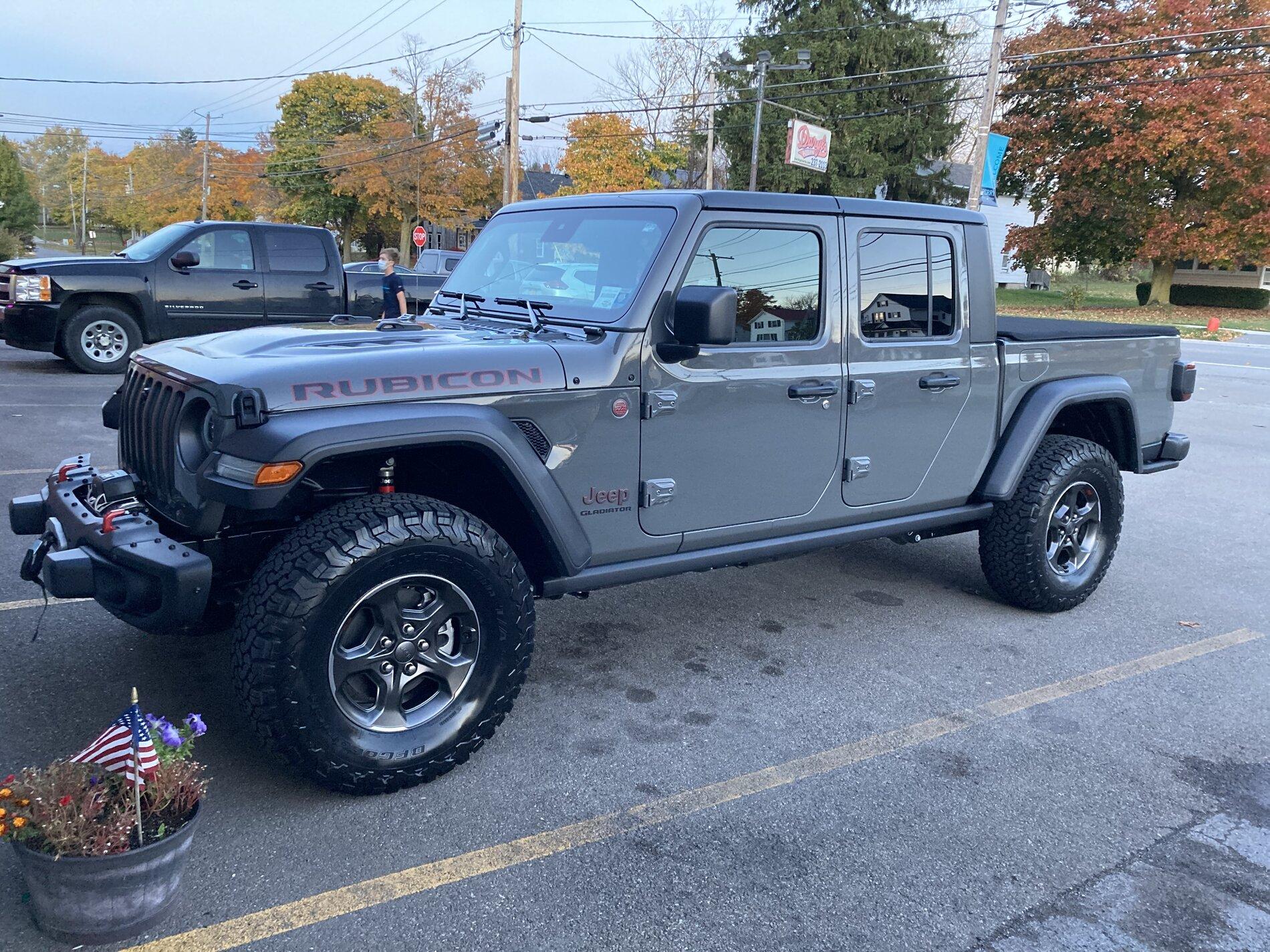

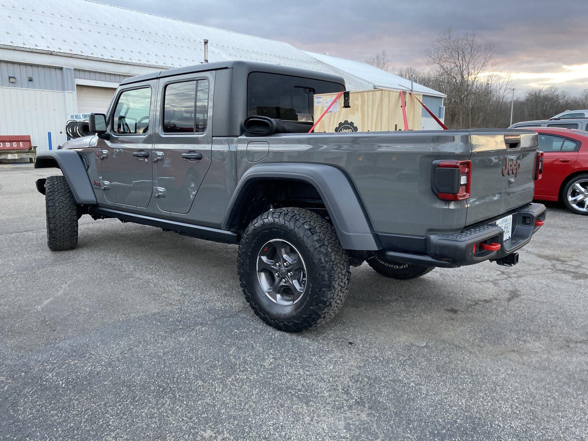

And here it is. I’ll get measurements after I get home (100 miles away) but it sure seems to be standing taller. Tires are 35s, and there’s still tons of room.

For comparison, here’s a pre-lift shot:
Looks great! Just looking at the comparison shots it def looks a couple inches higher. If you look at the front shocks you can tell, although the angle is different.

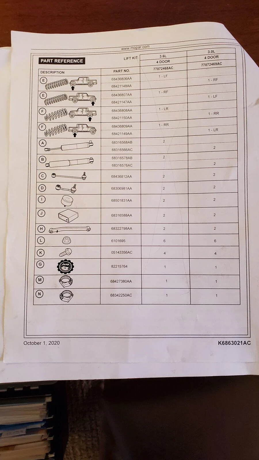

I did my mopar lift this past Friday and added the 3/4 inch daystar spacer to take about 50% of the rake out. The lift came out great and rides really good. The 37inch milestars are awesome. at only 73lbs my wheel/tire combo is only 100lbs and they are very quiet at highway speed for a mud tire.
I did run into an issue when installing the lift kit and I called my dealer about it the day of. They did not have an awesome for me but should get back to me on Monday. In the kit instructions the part # of the springs are associated by LF, RF, RR and LR for left front, right front, etc. But Looking at the image on the instruction associated with the part # and reference code (LF, RF, RR, LR) the image shows the opposite side of the jeep for install. Basically, depending on how you read the instructions the spring can be installed on one side vs the other. I think this is an error in the instructions. On the JL manual everything lines up with the images. Curious what you all think... some of your kits may be installed incorrectly as well if this is an error in the instructions.

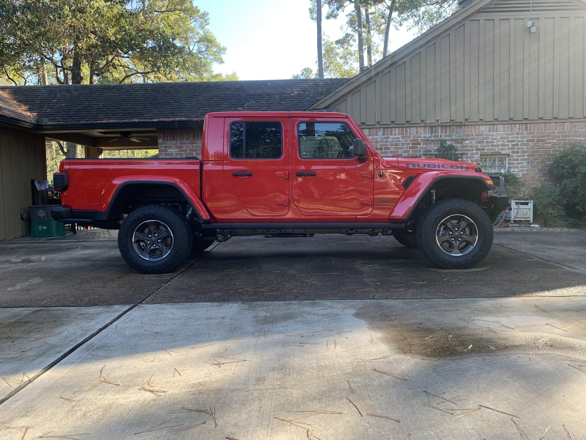

Here is mine with the Mopar lift. I have not measured it, but if there is a rake, it is not bothering me, at least yet. On the subject of bad instructions, the Mopar parts diagram for the rear suspension is wrong. The diagram and parts listed are apparently those for the JL. For example, it shows that the upper rear shock uses two bolts to connect to the frame, not that there is a single bolt through the shock with a nut on the other end. I know this because the guy who installed the lift forgot to put the bolt on and I went through Hell trying to get a replacement and still don’t have it. All the parts guys were telling me I needed two bolts and there was no nut. I have a smaller bolt from my LJ I am using to hold it together for now while it sits in the garage waiting for the replacement. I have sent FCA an email pointing out the issue with the parts diagram. They have forwarded it to a “specialist.”
