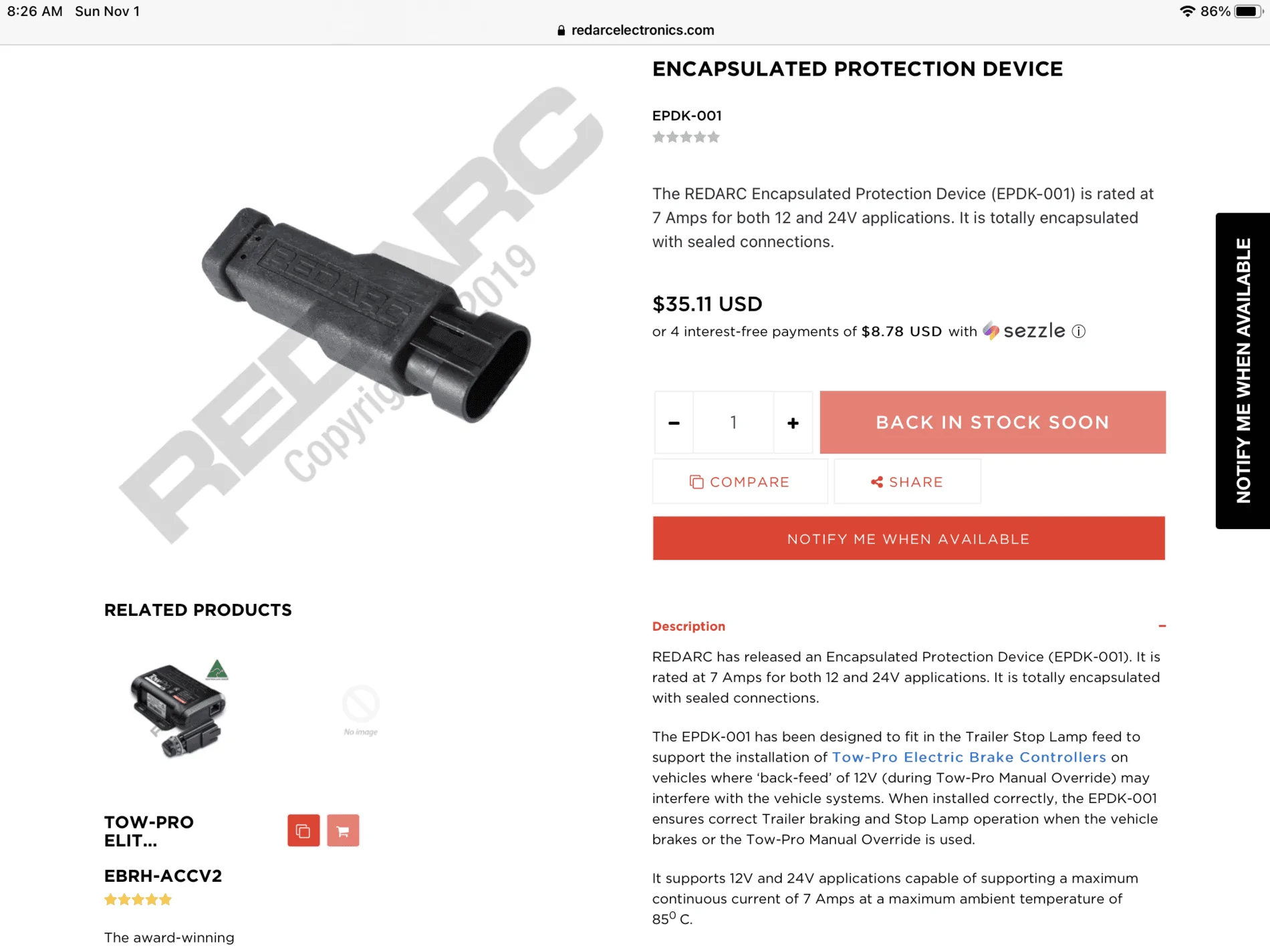

This appears to be Redarcs answer to the feedback issue

That is all we are ever going to have on here unless we get an engineer to completely evaluate the parts and wiring.
Maybe @ShadowsPapa will modify his cable with a diode to see if it'll fix the issue... He mentioned he can't return his cable.

They may have added the diode to the factory harness knowing the controller harness wouldn’t have it. If that is the case then some 2020’s may also have it depending on build date and when the change was incorporated.
I strongly doubt that......... possible, but there are what-ifs related to third party controllers then. Diodes also inherently drop voltages, so if a 3rd party has one in a harness............ and further, why do that with factory and then have to figure out who has it and who doesn't.
